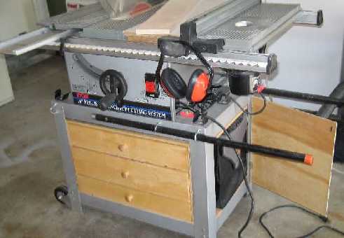

                  Heres a photo of what I put together a while ago based on ideas picked up from this site since the articles aren't available yet. Nowhere near as fancy as those that inspired me; I didn't want to bite off more than I could chew though being a woodworker rookie. My saw is one of the original 13-amp BT3000s which came with the square-box leg set.
                  The idea for building the box inside the BT3000 legs is based on Norm Haven's article although I simplified mine a bit. The drawers just rest on quarter inch panels and can open from either side of the saw... makes it easy to grab the blade/throat tools from either side of the saw. Blades store in vertical compartments on either end. I'm using the casters from the accessory kit, with a couple washers tilting them - again as Norm posted. The factory castor set requires you to wheelbarrow the saw to move it; adding washers makes the casters tip closer to the ground so you don't have to lift the other end as high. Really simple, really helpful idea from this site. (thanks Norm) I made 3 deep drawers because mine also store the router bits, dovetail jig, etc. Not visible in the picture: I added a piece of sheet metal between my wood box and the bottom of the saw, shaped like a funnel, to catch sawdust and allow a shop vac to clean it out. Norm and Jim Frye posted originals to this idea.
                  Another smart idea (Jim Dwight's idea, and I didn't use it though I considered it) to make saw cleanout and maintenance easy: mount the saw to the stand with a piano hinge along the left side. To stiffen the saw body, mount the saw to a panel of plywood or MDF with a big square hole in the center (for cleanout/maintenance access) and mount the panel to the piano hinge.
                  You can see the black pipes I use as the wheelbarrow handles (lifting by the saw rails is not recommended) from JP Honeywell's article on this site. They slide in/out inside those "U" bolts visible along the front.
                  mpc
