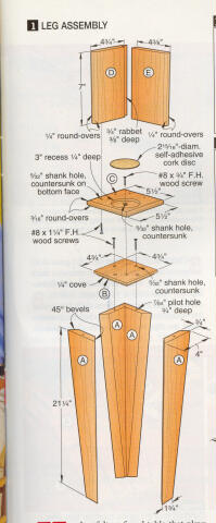

Will this table leg work?

    I take it as long as they are well fitted, they should be pretty solid. I doubt FWW would publish something that's shaky.

      I think Scorrpio has it right, take care with the angles and should be ok. Don't forget you also have "B" fitting between the legs and "C". That may add some stability as well. Of course if you're still nervous - you could whack down a 4x4

        Use Gorilla Glue (be sure to lightly wet one surface before assembly), clamp it up tight (the glue expands as it cures). It you do it right, the wood will break before the joint does.

          The legs should be fine if the joints are tight and you use a good glue.
