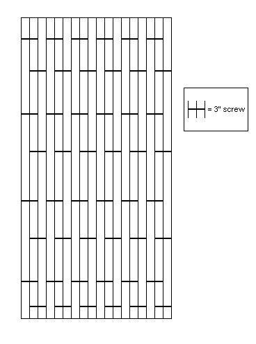

              • ezland00
                • 32
                Workbench plan from lowes.com
                Here is a plan i found from lowes.comLink
                I have couple questions, i have attached a picture, is that how you put the 2x4's togather? the line between each 2x4's are 3" screws.
                i want to have a perfect flat work table. what's the best way to do that. i know using belt sander won't do it.
                thank you

                  #23
                  Err, look at that picture carefully. Every third line is not crossed by any screws. Means no screws are holding 3rd board to 4th or 6th to 7th etc.

                    #24
                    I went with a solid MDF core door for my workbench top, because it is pretty straight and a whole bunch less work. Do you have a garage or driveway that is straight enough to use as a reference for assembly? I would probably use biscuits to try to get everything aligned as good as possible. I would modify one thing in that design on the bottom rails. Either do two cuts on the table saw to make a notch or glue and screw a 2x2 flush with the bottom of those rails, to put in some shelves. This adds extra storage and the things you store down there helps weight down the bench and keep it from moving.

                      #25
                      I read somewhere online where someone built a glue-up benchtop and took it to their local lumberyard/cabinet/millwork shop and had them run it thru a wide drum sander or planer to mill to flat. Recall it cost $35. I'm thinking about trying that.

                        #26
                        thank you
                        EZ
                        You can flatten a workbench top with a router:
                        http://www.woodmagazine.com/wood/sto...y/data/408.xml
                        Can't find my link on how to do it with hand planes.
                        The "EZ" way probably is to find a place that will run it through a wide belt sander. My local hardwood dealer charges $1.50 a minute.
