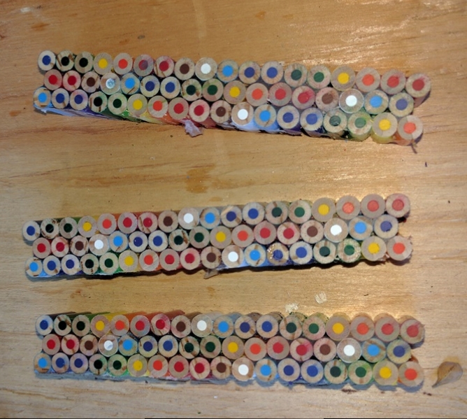

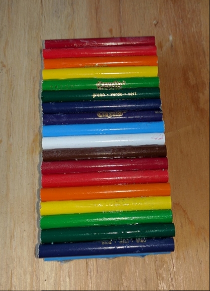

                    That is very cool indeed. Can you explain a little more how you made the blanks. As the pencils are cross cut did you start out by gluing together pencils that would be approx 3/4 deep by 6" wide by 1 pencil long and then cutting them into blanks. I guess maybe 5 or 6 from each glue up. Is that kind of right? As there are lots of gaps how did you deal with the ends where the blank needs to be solid and square where the pen kit joins?
                    • JoeyGee
                      • 1509
                      • Sylvania, OH, USA.
                      I cut the pencils down to about 3" long then glued those sections together, one row at a time. I ended up 3 pencils high (~3/4") and about 5" long. I then cut up that large blank into 3 separate 3/4" square x 5" blanks. I then squared up the ends on each blank. Hopefully, that makes sense. I found my pictures that I took from my Crayola attempts. *These pictures were before I squared the ends.
                      FWIW, this first attempt was made with a bunch of leftover pencils from my kids--so there were mainly off brands with a couple Crayolas thrown in. I have since made a couple more, exclusively with Crayolas (on sale and I figured they would be the best) and that has proven to be a problem. The "lead" in the Crayolas act like graphite, which I don't think they are, and spread fine dust all over the blank when sanding. I am have read cheaper brands work better. I think my original pen was with Crazy Art or something. I am going to try some dollar store pencils to see if they work better.
