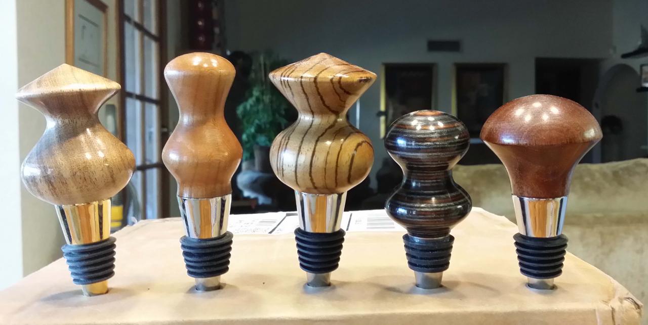

    Starting to get the hang of these and made a few to give to friends.

    Having stripped the threads in a bunch of blanks I have adapted the process to one that seems to work better than doing everything on the mandrel.
    1. Mount the sq blank in 4 jaw chuck and round 1 half.
    2. turn the blank and round the other half.
    3. drill center hole on lathe
    4. tap using drill on v slow speed
    This method eliminated the chance of a catch while rounding, where all the torque is applied to the very fragile threads if done on the mandrel. Getting a catch while turning the stopper on the mandrel is still a pain and yesterday a small catch just blew apart a nice dyed/stabilized blank - Grrrr. Also tapping using the drill method, while counter intuitive, makes for a more consistent and cleaner thread.

    Very, very nice! Could you name the woods used? What do you use for finish?
    Richard
      Thanks. From left to right. Mesquite, Cherry, Zebrawood, SpectraPly, Padauk.
      Finished using the BLO/CA technique.
        Very nice. I especially like the shape on the padauk one. Reminds me of an awl.
        Any trick to making the tenon that fits the stopper fit? Just trial and error? Is it then epoxied in?

          Paul they are actually threaded so its really the reverse i.e. drill a hole and the stopper screws into it. They look like this
