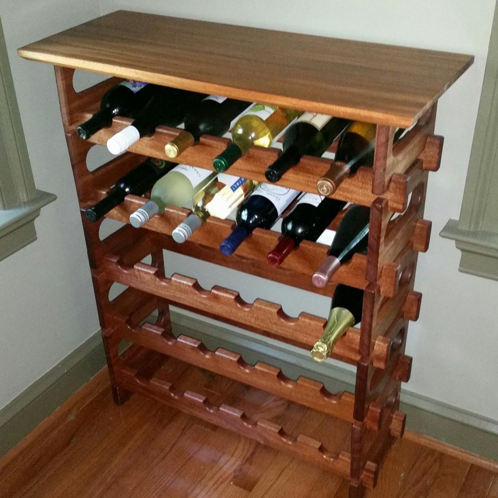

    Here it is. It turned out pretty good. If I make another one I will figure out how to get exact sized dadoes.
    Sapele wood. On the top I put a layer of Zinsser SealCoat, sanded and then put two coats of Danish oil sanding lightly between. Then a couple layers of spray laquer also sanding lightly between coats. For everything else I just put one coat of Danish oil and 2 coats of spray laquer, no sanding since I had it assembled.

    Nice Job,
    Did you route the bottle inserts or sand smooth??

      Originally posted by Kangaman
      Nice Job,
      Paul
      I made the first one as perfect as I could-cut and sand, then I rough cut the rest on the band saw and used the first one as a template to route them out. I tried using two sided tape but that is thick and way stronger then I thought it would be. Could barely separate them. I switch to clamping them together from the ends. It worked great.Then just light finish sanding after I rounded all the edges over on the router table. I did the same thing for the ends. The first one (going the wrong way) tried to get away from me. Inside cuts go the opposite way and I forgot I guess.
