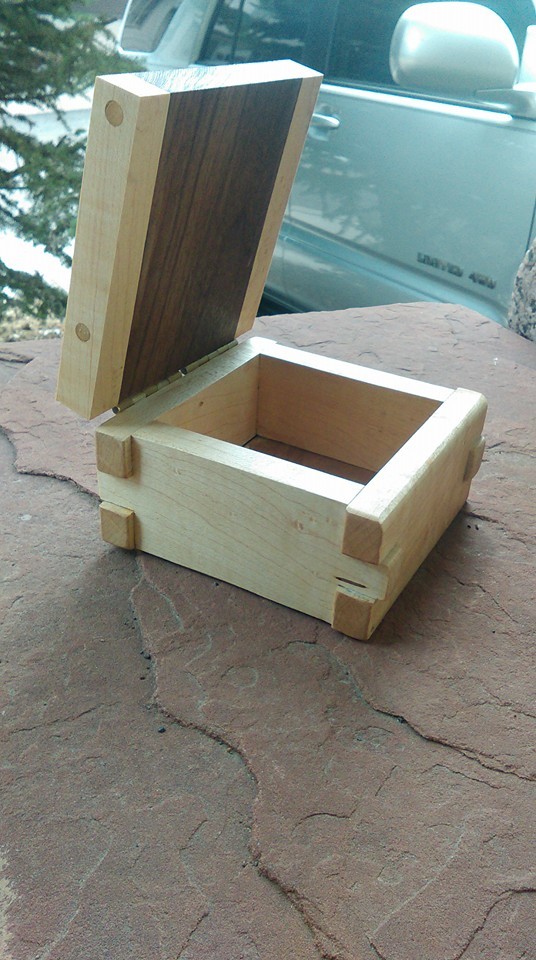

walnut and maple box
  • durango dude
    • Mar 2011
    • 937
    Nice day project! Finished with Danish Oil ---- looks fantastic!
Name:	maple walnut box.jpg

    Agree looks fantastic, care to share the dimensions, thickness?

      I started with 24 inches of 3/4" maple, 3 inches high.
      Planed the wood down (should have planed the top, as well).
      The top ----- 4" of walnut, 2" of maple - split the maple into 2 1" strips.
      I joined the pieces for the top with dowels. When I accidentally drilled
      all the way through one of the maple holes, opted to use through dowels.
      It worked out!
      Thinking the top could have used a round-over or beaded edge.
      Finger joints aren't all that hard to cut ---- I clamp a stop block on my miter, cut the
      fingers, move the stop block in, by the blade thickness, and then cut the grooves I don't really measure
      things much -- I mostly match stuff. I find measuring creates a more sterile looking piece.
      (inspired by Sam Maloof --- I don't ever think I saw him with a measuring device)

        I like that design. And as you mentioned, wonder what the top would look like rounded over. Seeing some of the smaller projects that have been posted recently, I am getting antsy to do some woodworking for myself. (I am in the process of making a set of bunk beds for my daughter, but that don't count, that is work.
          Different look from most boxes. I like it!

            Pappy - it borrows a little from Greene & Greene style.
            Wouldn't really call it that, though ---- just inspired by it.
