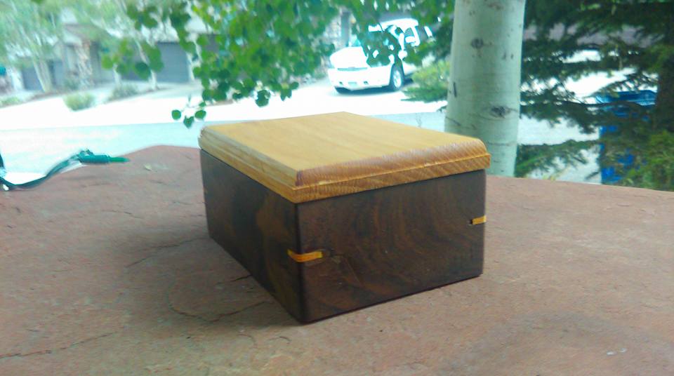

    Decided to use my time to make boxes. This one's a miter box.
    Tried my hand at mixing walnut and oak, adding some splines.
    The lid is rabetted on the bottom, and top is finished with roundover bit.
    Opportunities for improvement:
    A) need a thick kerf blade for cutting spline slots. My 10 40 blade is great for most purposes.
    However, the alternating bevel blade does not cut flat channel --- you can see the result when you look closely.
    b) be less generous with glue.

      Nice work, This is the blade I use for boxes needing a spline, but it is a thin cut.

          My alternating bevel blade does not cut a straight channel --- you can see the result when you look closely.
          I've had that problem, too. The situation improved when I began adding sacrificial material to the surface of the sled I use to cut the slots. I use carpet tape to affix 1/8" MDF panels to the sled, then raise the blade to the desired height. It acts like a ZCTP, minimizing tearout.
            Sorry to hear about your job.
            Nice box, I like the grain. I had the same problem using my WWII ATB ground blade for splines. I still have my original BT3100 blade which does cut flat grooves but is even thinner than than the TK WWII. They do have a box joint blade but thats a lot of $$ for an occasional spline joint. Do you have a dado blade? The outer blades are a standard .125 and flat ground so will work well for splines. I keep meaning to make a box spline jig for the router table but its currently way down my to do list.
