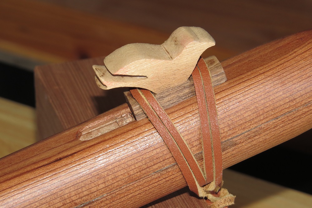

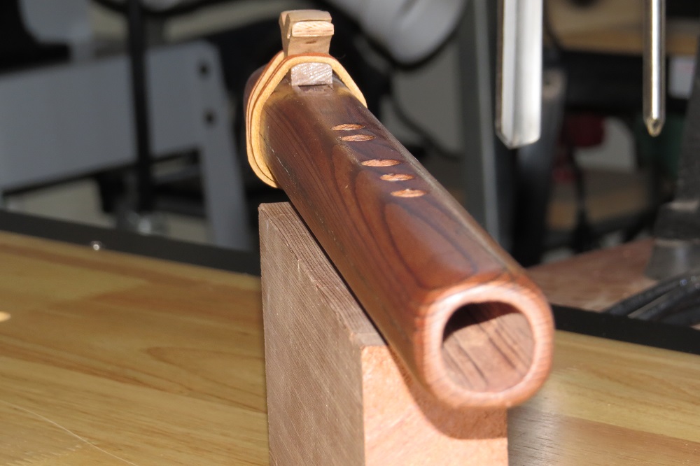

    My eldest daughter is a musician (guitar, flute) and enjoys Native American flute. After seeing many designs and some utube clips online, I decided to try my hand at making a 5-hole version for her. Those pictured here are my first, which came out well enough that I used some nicely figured old-growth redwood to make the one I gave her (but other wise they're identical.)
    This is not turned, but made from a square blank of old growth redwood that I first split, routed to shape internally and externally, then glued up. I used the hole spacing from a PVC design I found online, but the pentatonic tuning took a bit (done by enlarging each hole in succession, starting at the bottom and working back up toward the mouthpiece, after the flute is assembled.) I was amused that the "totem" thingy that sits on top of the flute to direct the air is called a "bird" (and the air channel is called the "nest") - so I decided to go literal and scroll sawed a bird shape to sit on the nest - nothing fancy, but functional, from some walnut scrap I had.
    She got hers for her birthday a little while back. I keep this one for my personal enjoyment, as I sometimes will take it out on hikes and play in the solitude of the wilderness. Thanks for looking.

    Came out nice! I made one a long time ago, similar design but turned:

      Thanks Gerti. Your flute came out great, and looks like you went six-hole - I'm thinking of trying one of those in the near future. I have some aromatic cedar that is seasoning now that may want to be a flute

        Beautiful work. How's it sound - bet it's great.

          Thanks Phrog. Sounds better than I can play The one I gave my daughter played very easily and responsively i believe because iwas able to get the walls thinner, whereas mine is nice but wants a touch more airflow.

            Looks good Bill
