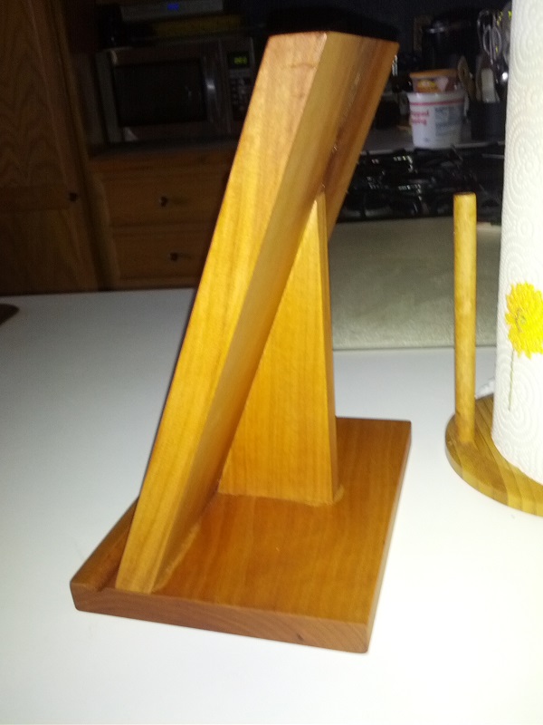

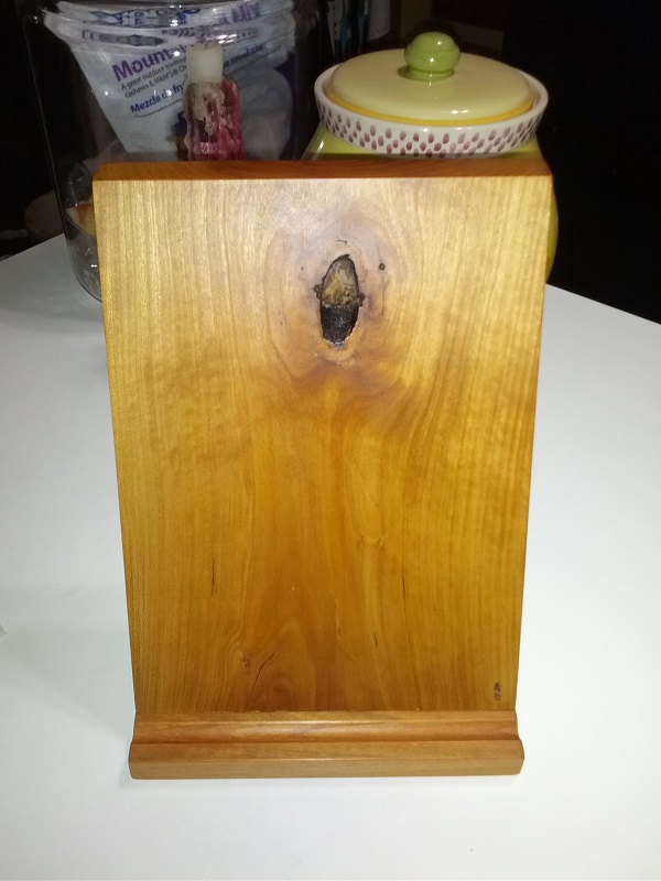

    LOML won an iPad in a drawing at her school. Mentioned Sunday that it would she was having trouble getting it to stand up against the paper towel holder while she was following a recipe on the screen. I measured it, hobbled out to the shop and the cut-off hunk of cherry that had been on my RAS table for a month or so was perfect--didn't even need to rip it. Cut then ends to 22 1/2 degrees, found another scrap for the base, routed a 1/2" flute on the router table, cut a wedge from a third scrap. In well under an hour it was being glued up. Quick sand at 220 (did I mention I love the way cherry mills on my DW 735?) and a few coats of BLO and she's a happy camper!!
    earl
    PS--you're not getting a picture of the back as the glue stains show up far better in the pictures than in real life. I should have taken the time to build a jig for glue-up!!

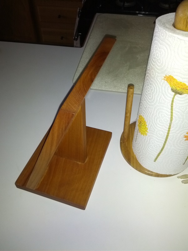

    Pretty Cool, and a good use of small pieces. How about a side view?

      Geez, even in a kind of profile the glue smudges look huge. Truly, in person it's not something you'd notice (unless you're a woodworker), but the camera just seems to magnify the tone difference. If I were going to make a handful, a pretty simple gluing jig would make that much better.
      On a more positive note--I didn't realize until I was resizing the pictures that i'd shot them next to the very paper towel holder she was trying to use as a stand when she mentioned how hard it was to see around the dowel!!

          My wife has an iPad, and hope she doesn't see this. I like yours with the flute for the bottom edge. Nice that you angled the top to be on the angle. As for the glue, if it really bothers you, use a ¼" sharp chisel, bevel up and scrape a little, then add some finish.
