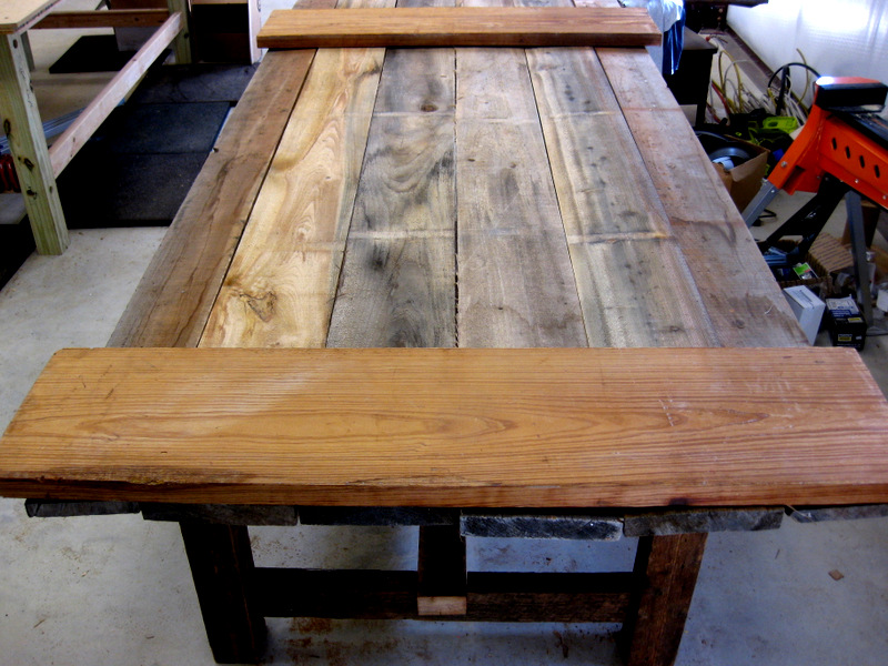

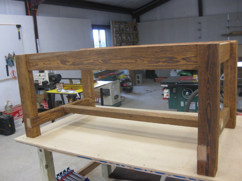

    My daughter and son-in-law just closed on their first house. They had it built and it was a LONG 7 months from picking lot to closing for them and my wife and I ... as many know the "process" of having a home built can be stressful ... and it was. Regardless after all of the tears and hair pulling ... they closed on a beautiful home and we helped them move in this past weekend ...
    My house warming present to them was a "built to their specifications" dining room table.
    They specifically wanted "rustic", "dark finish" and 46" x 84" .... we went to several "rustic furniture stores" with them so I could get a better idea of what they had in mind ...
    I started by looking for reclaimed wood and found several sources ... the prices were astronomical ... typically $9/bf+ for what I had in mind.
    I got VERY fortunate and found a fellow at a giant flea market that had OLD 2x4 and 2x6 reclaimed long leaf pine out of a barn in Arkansas ... his price ... $1.25 RUNNING FOOT ... I almost broke my leg jumping in the pickup and backing up to his trailer

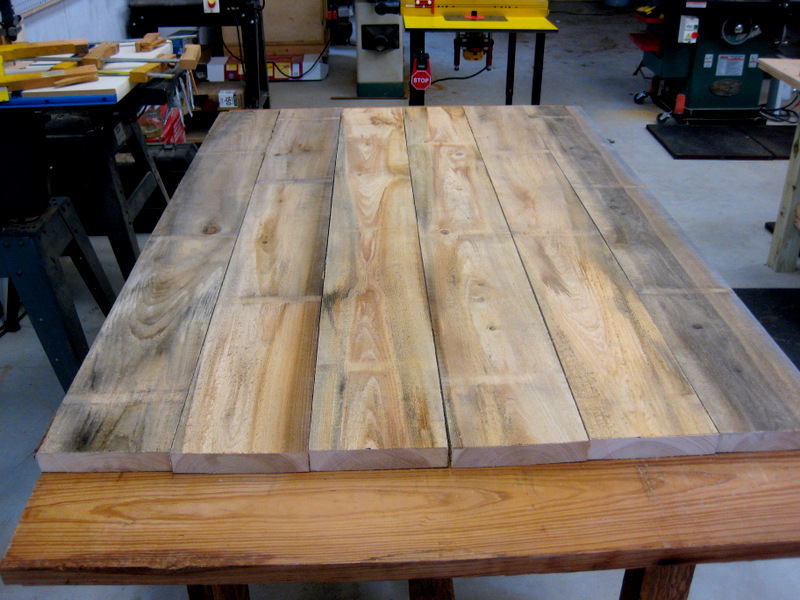

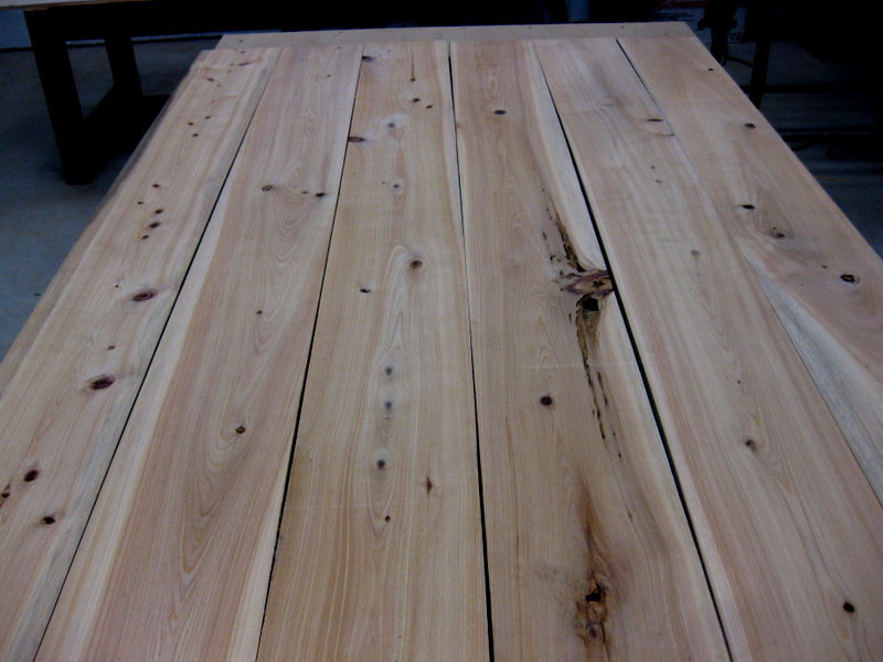

    I contacted a mill I had used before and determined he had some 6/4 rough sawn cypress that I thought would work for the top and by incredible accident MY father-in-law (now 93) had two 4' x 11" long leaf pine boards he had saved since the 1960's from I have no idea where ... regardless I confiscated those to include in his grand daughter's new table.

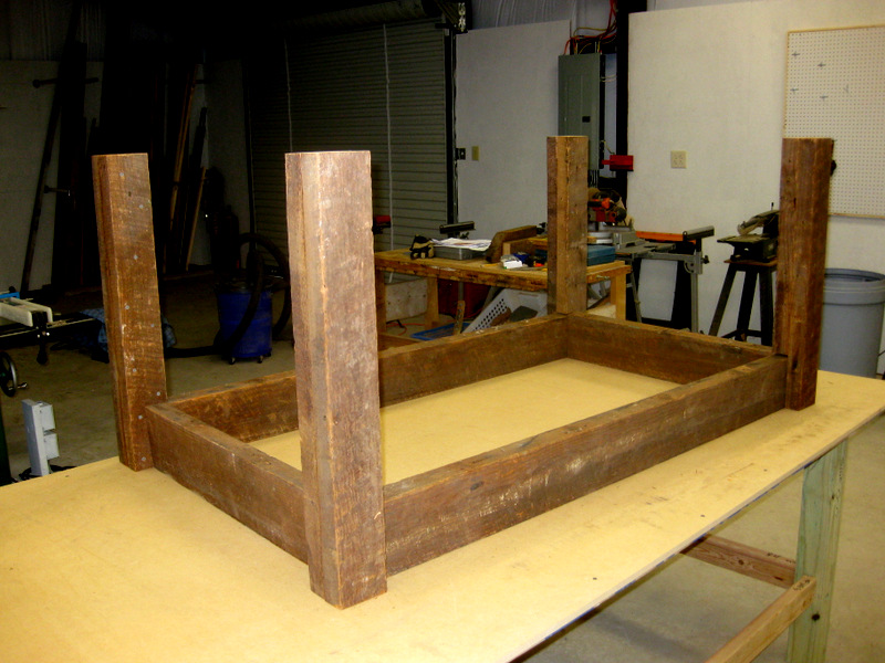

    As I started to build the base of the table from the reclaimed lumber I discovered several square nails ... dating the wood to well over 100 years I believe ... I thought that was pretty cool ...
    The pics below show some of the "in process" photos I took and sent to my daughter for "approval" ... the last picture of the completed table is of poor quality taken with my cell phone but shows it in its and their new home ... they were very pleased and so am I ...

                  @atgcpaul - the top comes off. I put two 1" pegs in the bottom of the top with matching holes in the 3/4" plywood sheet I have attached to the base so that the top can only "go on one way" and then there are lag bolts from bottom up thru the plywood sheet into the top. The plywood sheet is shorter than the top by 4" on each end and fits inside the skirt on the base. The two parts are very heavy and when put together ... the whole won't blow off in a tornado!
                  @allthumbs - well the finish was an experiment as I went along. Basically I used tung oil on the base (3 brushed on very heavy coats because that old wood was like a sponge) and then a waterbased matte poly finish on top of that (3 coats).
                  I should mention that the picture of the cypress all nicely planed flat is actually the BOTTOM of the top ... I did NOT plane the top of the top since they wanted "rustic" ... rather I sanded with 36 grit to clean up the dirt and grime. The finish on the top was first a heavy coat of dark mahogany gel poly wiped dry, then a coat of antique brown gel poly again wiped very hard, then 4 coats of water based matte finish poly.
                  @pappy - I'll look for pics of the wood as I got it ... I still have some pieces so I'll post one way or the other.
                  Thanks for the comments ... it was the first such project I have done ... they have friends that are interested in commissioning similar tables ... I gave them an "entry level price" ... just have to see if anything materializes from their interest.

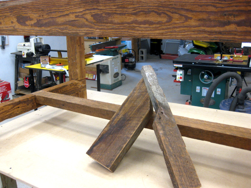

                  Btw ... all of the joinery is doweled and glued + in the case of the legs to the corners of the skirt 4" heavy duty decking screws and I used decking screws in a few other places on the base to pull things together while the glue dried and left them.
                  Oh and ... OLD WOOD ... is NOT SQUARE! Nor is it consistent in thickness ... the 2x wood was basically trapezoidal in shape making cutting the "mortise like" fitting joints a challenge.
