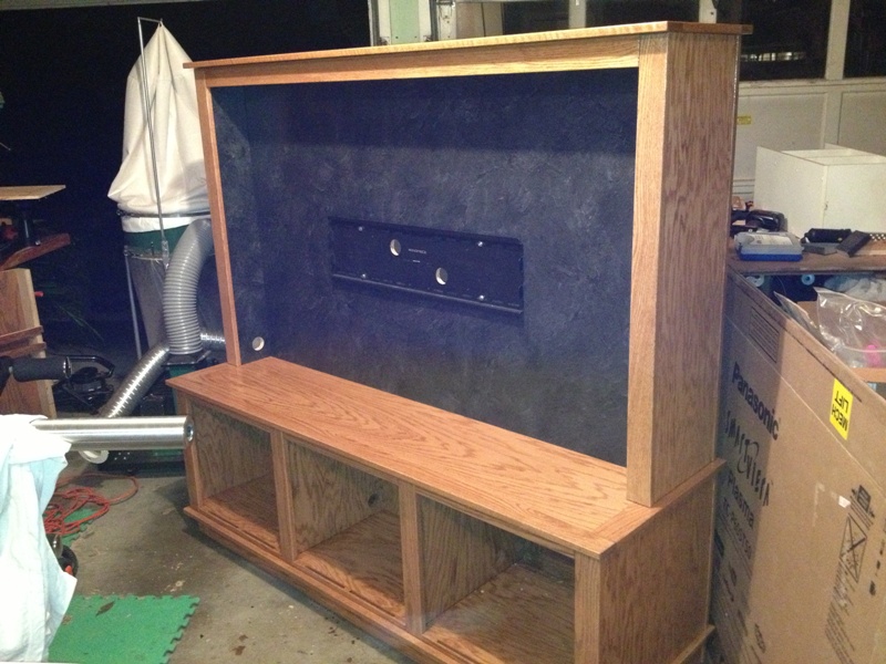

    After years of lurking here, *slowly* acquiring power tools, and a few practice projects, I finished a project that I wanted to share. Nothing too original, just another entertainment center.
    This project started as an exercise in reverse psychology with my wife. I first started with a smaller flat screen (that'd be the perfect size for the bedroom) on an old TV stand hoping that she'd get the bug to view a larger screen. Alas, no luck.
    The existing stand was getting cramped with all of the AV gear and game systems for the kids; so, I began sketching/researching ideas for a larger cabinet. (Hmm.... If can make it physically obvious that a larger screen would look better in the cabinet and still make it support the current TV, then at some point I'd hope to get the "we need to fill that space" directive. )
    I got the go-ahead to begin construction, but the more she saw the progress on the cabinet, the more she wanted a bigger screen. As a result, she ordered the bigger screen before the cabinet was finished; so, she'd playfully ask "are you done yet" every few days...
    Highlights of the cabinet:
    1 - vent slots are cut into the lower rails that pass through the toe kick to feed air into the cabinet
    2 - 3" casters in the base
    3 - rear panels are held with 1/2" neodymium magnets
    4 - 19dB fan in the back for air circulation
    5 - made a 4" wide stop in the rear of the cabinets to prevent the shelves from going too far back. that's to make room for cable management.
    6 - the dark background around the TV should improve the perceived video contrast on the screen. it's similar in function to a mask/surround on a large movie screen.
    I don't have a jointer or planner; so relied on 1x material from big box stores for the rail/stile material. I noticed they varied in thickness. Instead of sanding, to compensate for the difference, I decided to hide it with a detail by routing a 1/8 round-over on all of the facing sides of the rails/stiles prior to assembly. Seemed to work.

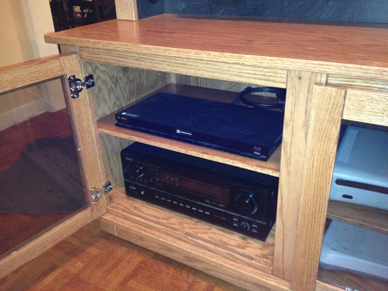

      Can you use a remote through the glass door?

        Do you have a back on the TV? If so, it should be removed.
        These tv's need a lot of air space.

        We used tinted glass on the doors and the remote works
        through the glass...you plan on using glass, right?
          yes. not a problem.
          The cabinet back (actually in the middle) on the upper section is 6in from face of the upper cabinet. The wall mount bracket is 4in deep and the TV is about 2in deep. That puts the face of the TV about flush with the face of the upper cabinet.
          There's a 5in gap on the sides of the TV and a 3in gap along the top and bottom. With the TV flush with the face, I should get good air flow to keep it cool.
          Wall mount $21: http://www.monoprice.com/products/pr...seq=1&format=2
          The exhaust fans in the cabinet come on when I turn on the AV receiver. The fans are connected to a DC power supply that's plugged into the switched power outlet on the receiver. (http://www.newegg.com/Product/Produc...82E16835610005)

            Oh, I see, I didn't realize it was on a wall mount until I
            enlarged your first pic.
              Good job Andy! A first use of psychology and woodworking on the forum, I think
                The cabinet came out great...well done indeed. Very professional looking. You did some extensive planning for cooling and wiring. IR controllers do work through glass, and I've had some work through plywood panels. Blacking out around the TV worked out nicely. What did you use for that?
                  It's formica/laminate, "basalt slate".

                    Radio Shack has 110 volt cabinet fans that come complete with a plug, so I just plugged mine into the receiver/amp's 110 volt power supply. It comes on when the receiver/amp is turned on.
