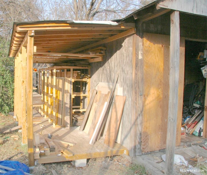

    Well, this is not a storage "bin" but more of a storage room. Because we have "building codes" in this small town, I was told that I could add onto an existing storage unit but not "wall it in" with a closed wall without a permit. I chose to leave the wall open - for now. Maybe put up some visqueen sheets later.
    I have soo much wood inside the storage house that I need for "storage" rather than wood, so says LOML, so I built this. I have been collecting the wood, 2X4s, ply and roofing for the past 18 months. About 4 weeks ago, I started building (on Saturdays only.)

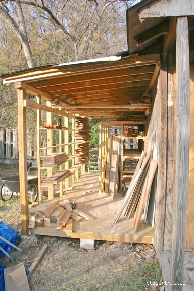

    I have a bin stand on the wall side in which a rack that is 18 inches wide and about 14 inches high for each cubby hole. This rack is 8 feet long.
    To the outside of the cubby holes is a 16 in wide rack for plywood sheets. I have 19 sheets, mostly 3/4 but some 1/2 and a few 1/4. Most of these plywood sheets have been around since before my dad passed away in '96. Old, good quality ply.

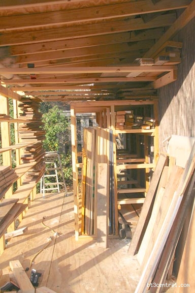

    On the side are shelf brackets and some 3/8 ply wood for shelves. I intend to stack short pieces on these shelves.
    Above the rack is 10 inches of space that I will use to store wide boards 12 to 14 inch wide that have been in storage for years. Above that is space for longer boards, storage for 12ft boards.
    The whole storage space is 7 ft wide by 16 ft long. In front of the "rack" I intend to put an 18 inch by 3ft vertical bin on wheels to hold scrap pieces.
    I have quite a bit of Oak, Walnut, Cherry, plus cottonwood with figures and other woods that were my dad's. Now that I can get to it, I plan on using it in the future.
    CLICK ON PICTS for Larger view.

      I am concerned about rain, which is why I am looking for something to put on the outside without violating the "building" code. This wood is no different than lots of wood that has been aged inside of a barn or shed, which are not air tight. The plywood is all in very good shape and condition, as are most of the other boards/wood. I think that UV will do it more damage than humidity and temp swings which most of it has endured for years anyway.
      The platform is high enough off of the ground; for the foundational floor and joists, I used pressure treated wood, none of which is in contact with the ground.

          Well, it is going to stay together! I forgot to mention this fact - Everything, except for the roofing was put together with screws. No nails except for the tar paper and roofing.
          One other bit of information, some of the walnut came from a tree that I used to swing under as young boy. Used a vine to swing out into a bayou. Didn't worry about snakes, just wanted to have fun. That tree was cut down in 1968, the wood has been stored in several different places. Most has been used but I have several 6 to 8 ft long 3x4 and 3X3 and numerous 8 to 10 inch wide boards 4 to 8 ft long. BUT LOML says she wants to store things in the shed!

            Would wrapping the walls with plastic be considered walling in the shed? Not the best solution, but at least some protection against the elements.
              That is where I am headed with my thinking. I have some 4 X 8 lattice sheets; I am thinking about installing with some heavy plastic on the inside of the sheets so that it will have some strength and still look "open".
