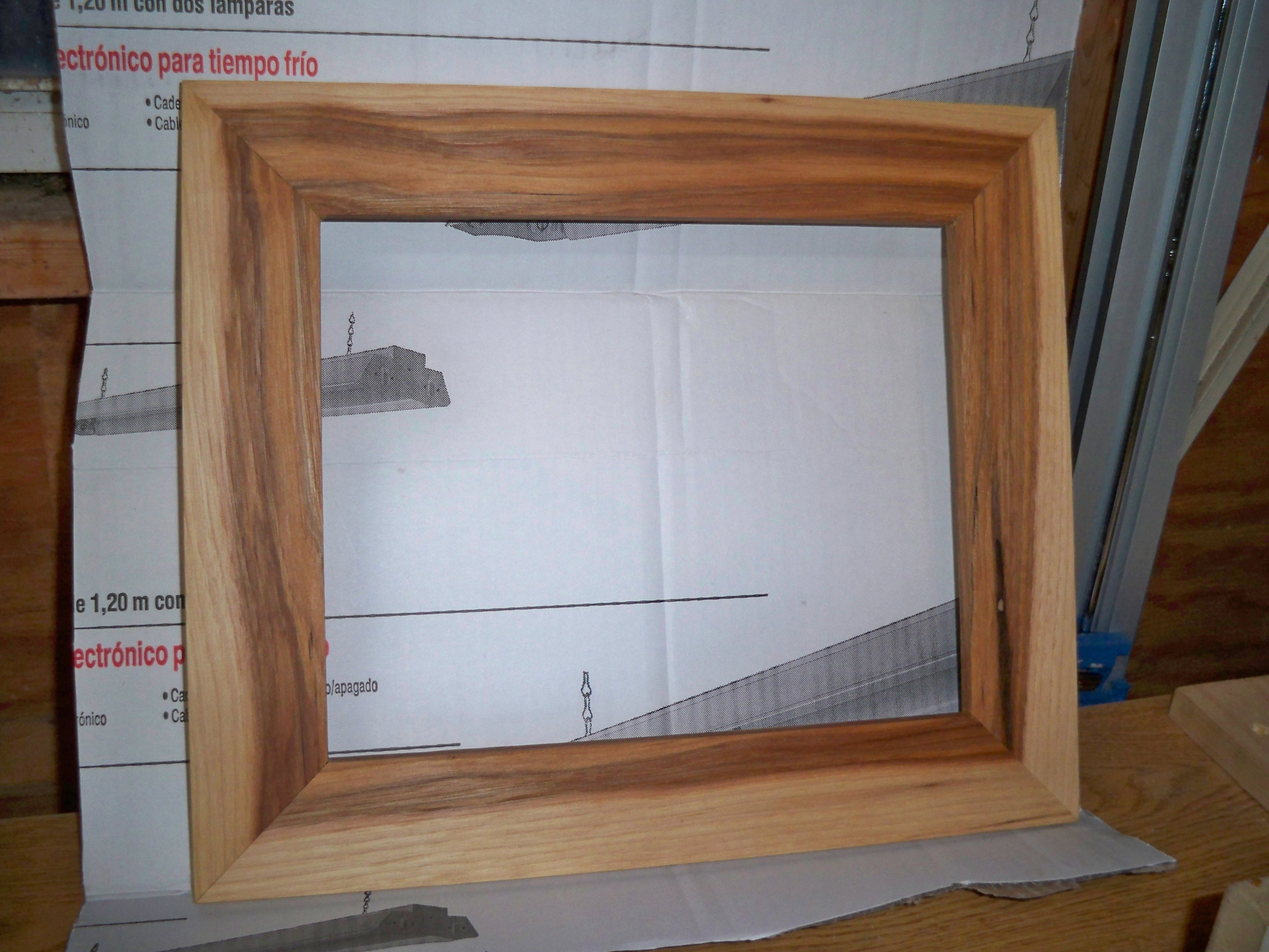

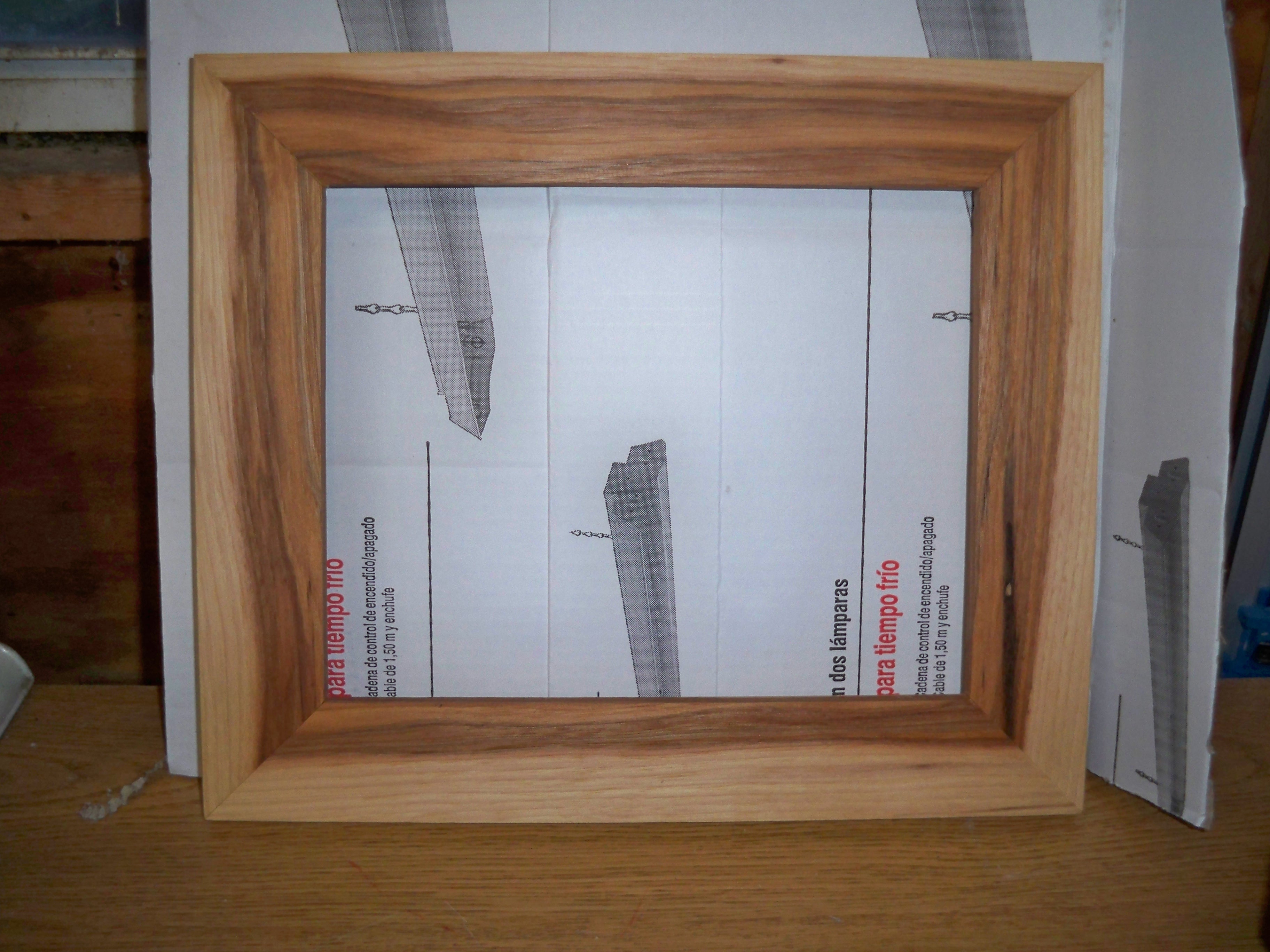

        I made my first one last week too, for LOML. Picked up a few pieces of hickory wainscoat base at the moulding outlet (Fara Trim/House of Fara is in our town, so it's the one thing we can get without mail order!!). It was 3" wide with a 3/4" rabbet, so i trimmed the rabbet side down to 1/4", then ripped the total width to 2". Miters are not so tight as Cochese, but they will hold. Surface and outer rim rubbed with a light coat of Danish Oil.
        Tried working with the Bessey corner clamps--not friendly on the hard stock. Set it aside for a day, picked up a Merle clamp (Pappy mentioned that in the thread where i reported my deal on the Besseys)--the Man is absolutely right. Thanks to Pappy, i returned to acceptable language in short order!!
        The one for her birthday (in a week) is a piece of wormy hickory--got the 8' x 3" piece for $2 because "nobody would ever buy that"--i love the old gal in the moulding outlet!!
