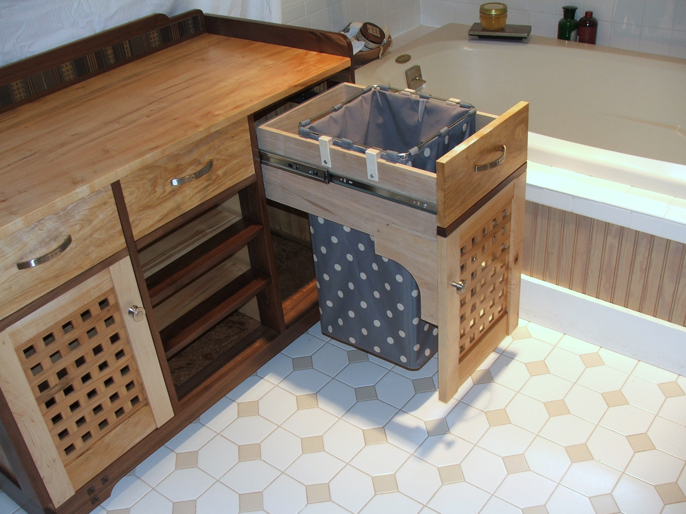

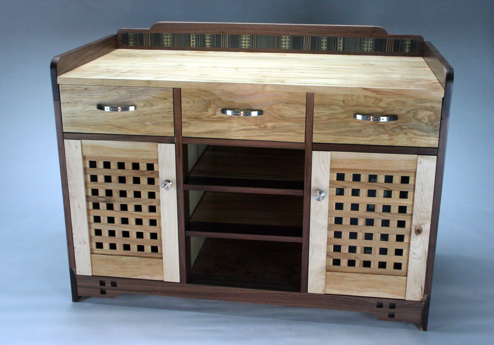

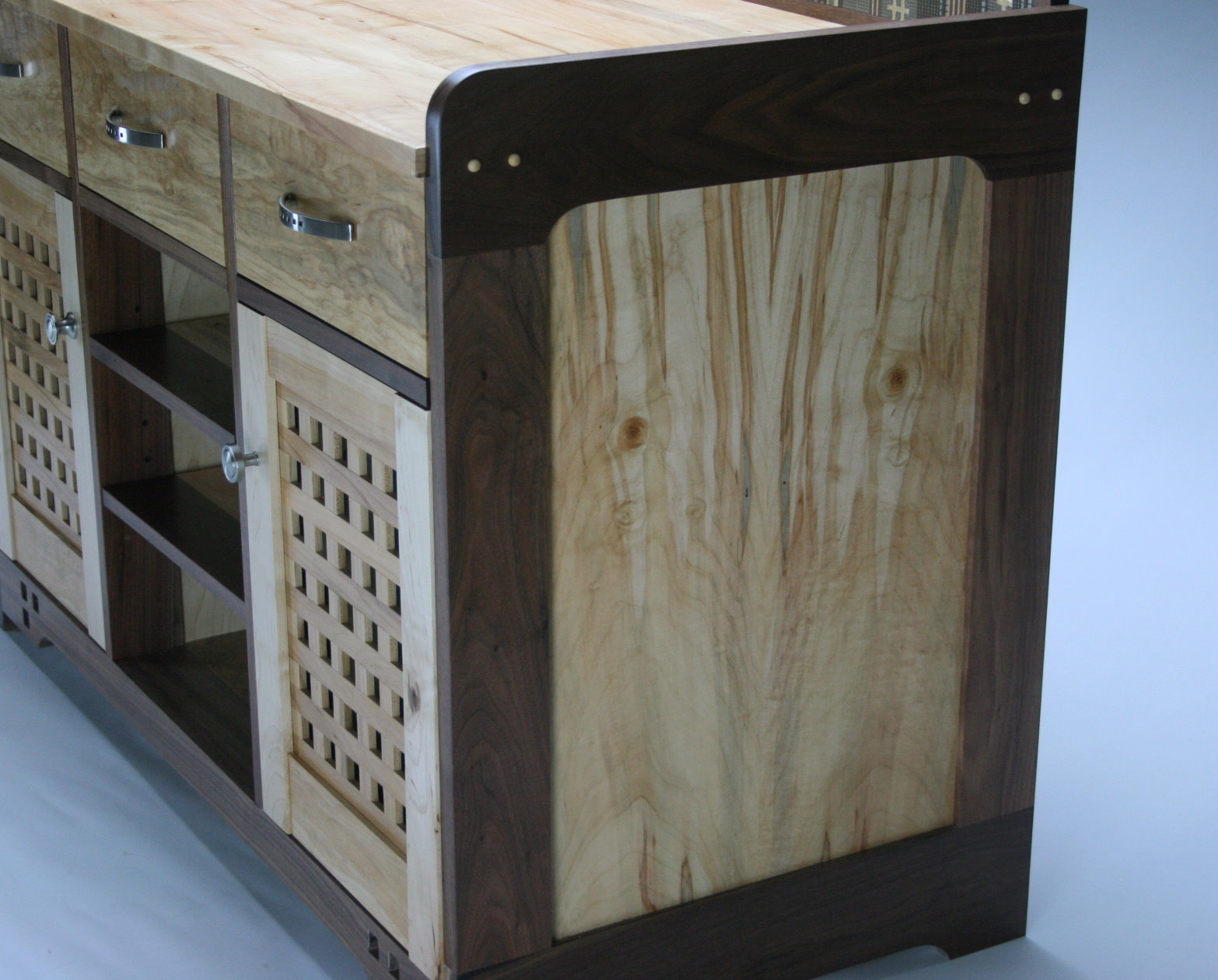

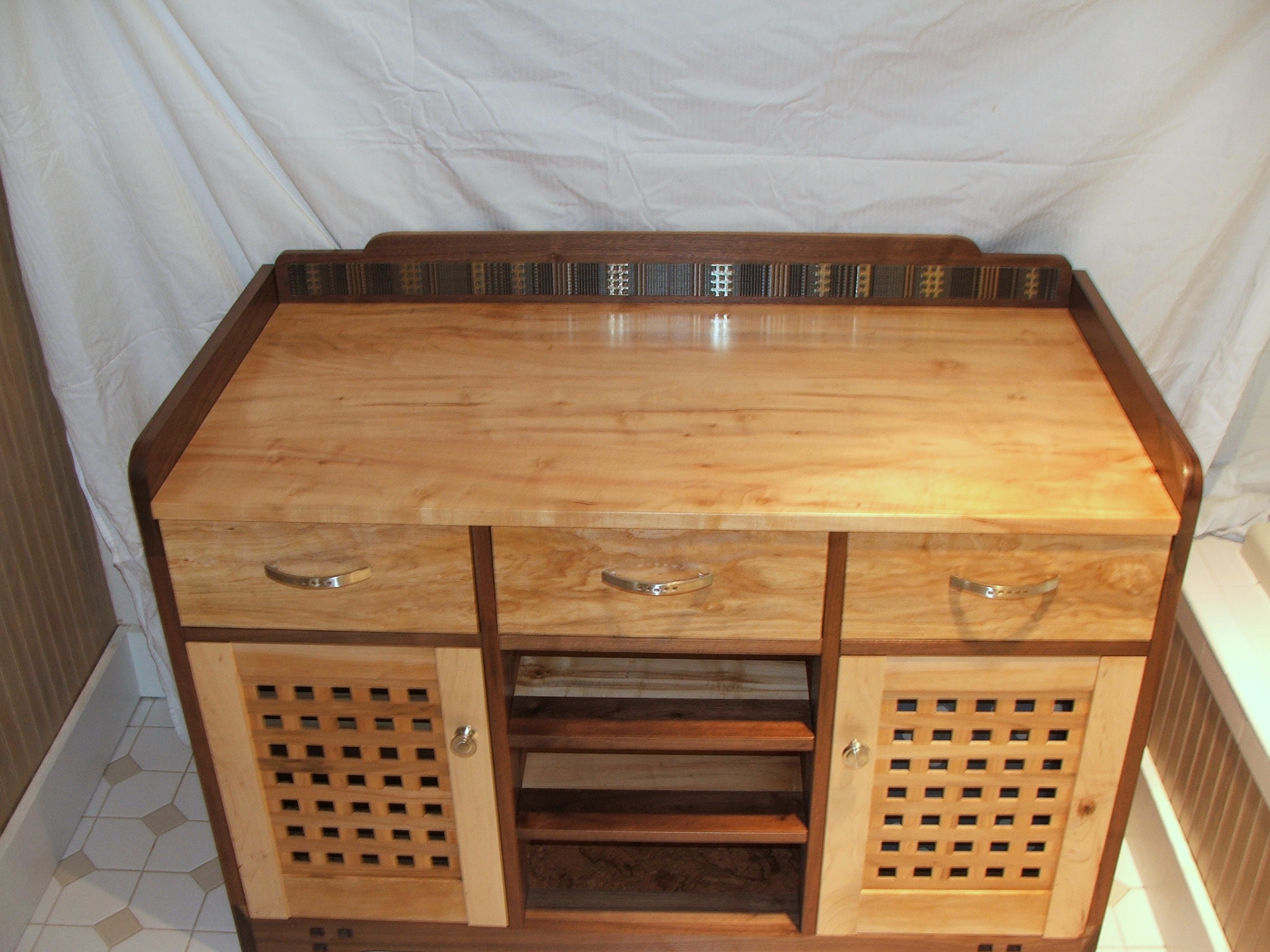

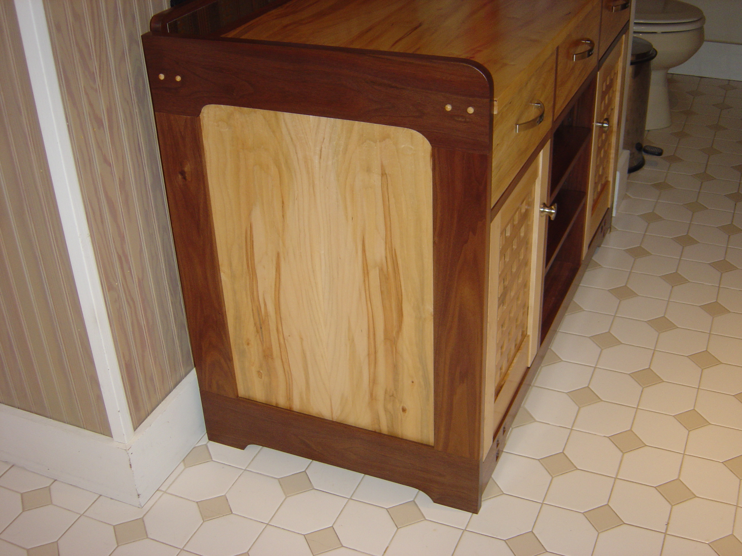

    The primary function of this piece started out as a deluxe hamper, but I suppose it is more than that. A hamper sounds so pedestrian. This is my design. The top is ambrosia maple, attached to the sides with long tenons fitting in dadoes in the sides. The back peg (maple) on each side goes into the top to fix it in place. The other three on each side are purely decorative. The panel insets on each side are also ambrosia maple. The frame and backsplash are walnut. Set into the backsplash is a decorative ceramic tile called a listello. The drawer fronts are cut from a single maple plank from a tree that was harvested from my property. The door inserts are half-lap lattice panels of maple also from my property. In the center are two movable shelves with a walnut leader with ambrosia maple in the back, and there is a similar shelf behind the left door. Obviously the right side is designed to visually mimic the left, but the drawer and door are combined to pull out together and hold the hamper, which was purchased from The Container Store. The little clips holding it in are designed to flex out when you pull the hamper up and out. Not very visible in the pictures, but visible when in front of the hamper, is the manufactured cork flooring I used for the bottom shelf. I strongly recommend something of this type, as it is prefinished and looks striking. The entire piece is finished in precatalyzed laquer without any stain or coloring. I didn't think any was necessary (the top two pictures are lacking color intensity).

                            Very nice work. Great attention to detail. I especially like the decorative cutouts you did for sliding bin holders.
