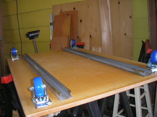

    This show the under base, I used some steel door roller tracks for support.

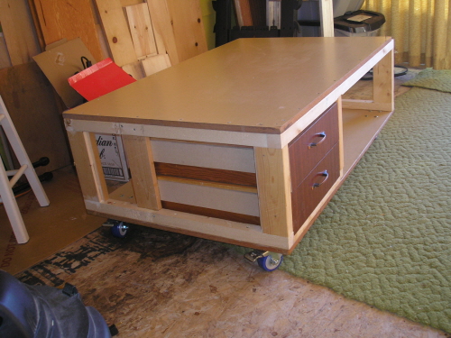

    Frame work is basic construction material, 2x2 and some 2x4's. The base and top are a couple pieces of the 3/4" mdf mentioned before. The 2 drawers were out of a built in vanity that was here (demoed a couple years ago.) 16"x19"x5" deep. worked out good for me.

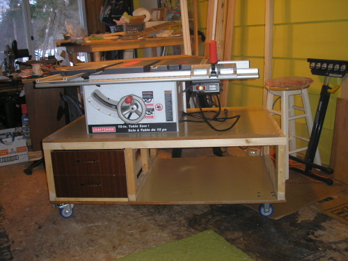

    With my TS attached. You can see the height difference from the old runoff table behind to the right. Will be doing a new one now. Also, I do have a lot of oak trim that I can finish the unit with, but for now its functional. Moves real easy and I can manipulate it from my wheeler. Oh - And an electrical box.. Cool.
