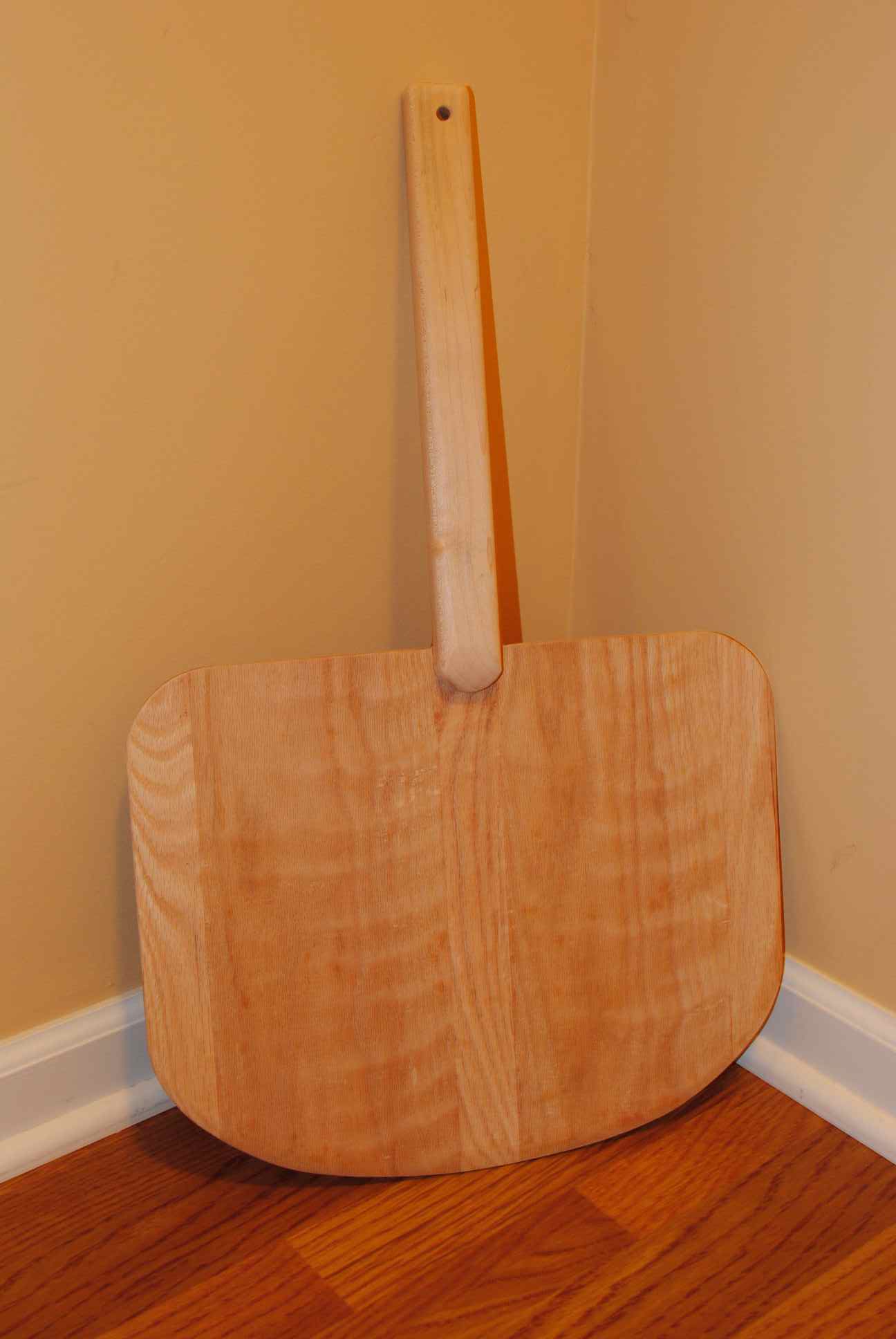

    First, for my BIL I made him a pizza shovel. The paddle is made from oak and the handle is maple. I designed it without any plans, using the trusted "that'll work method.

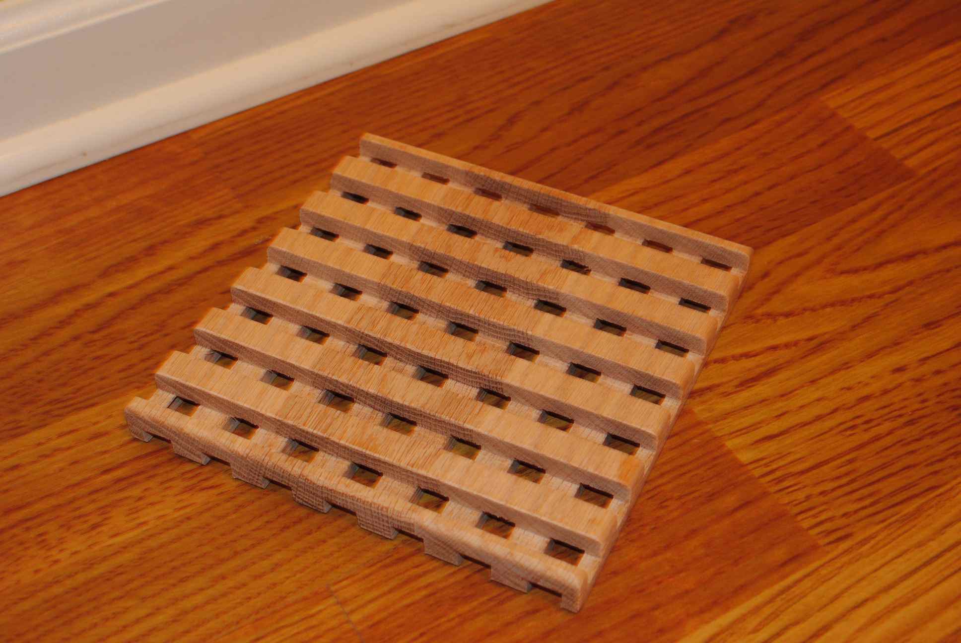

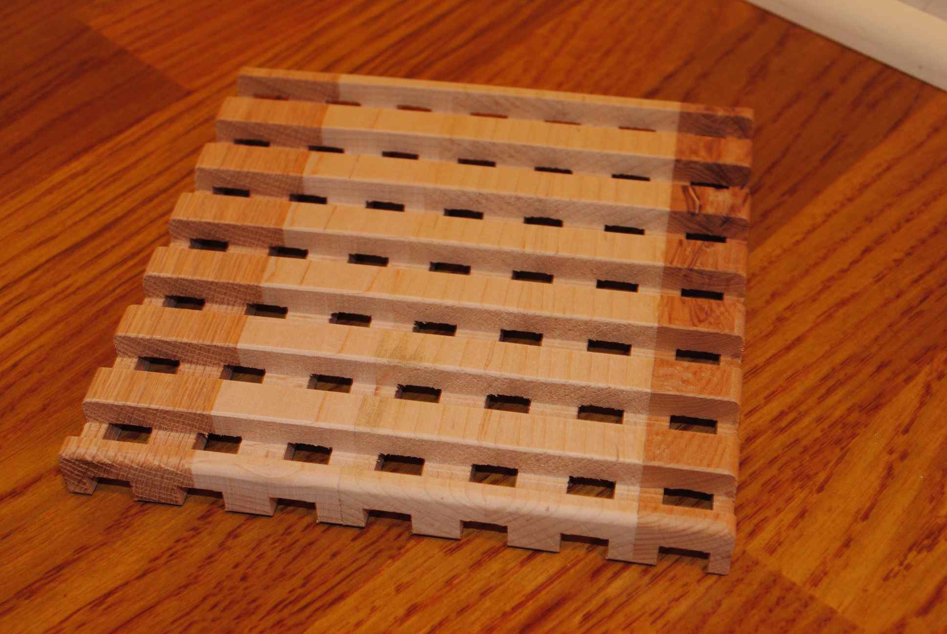

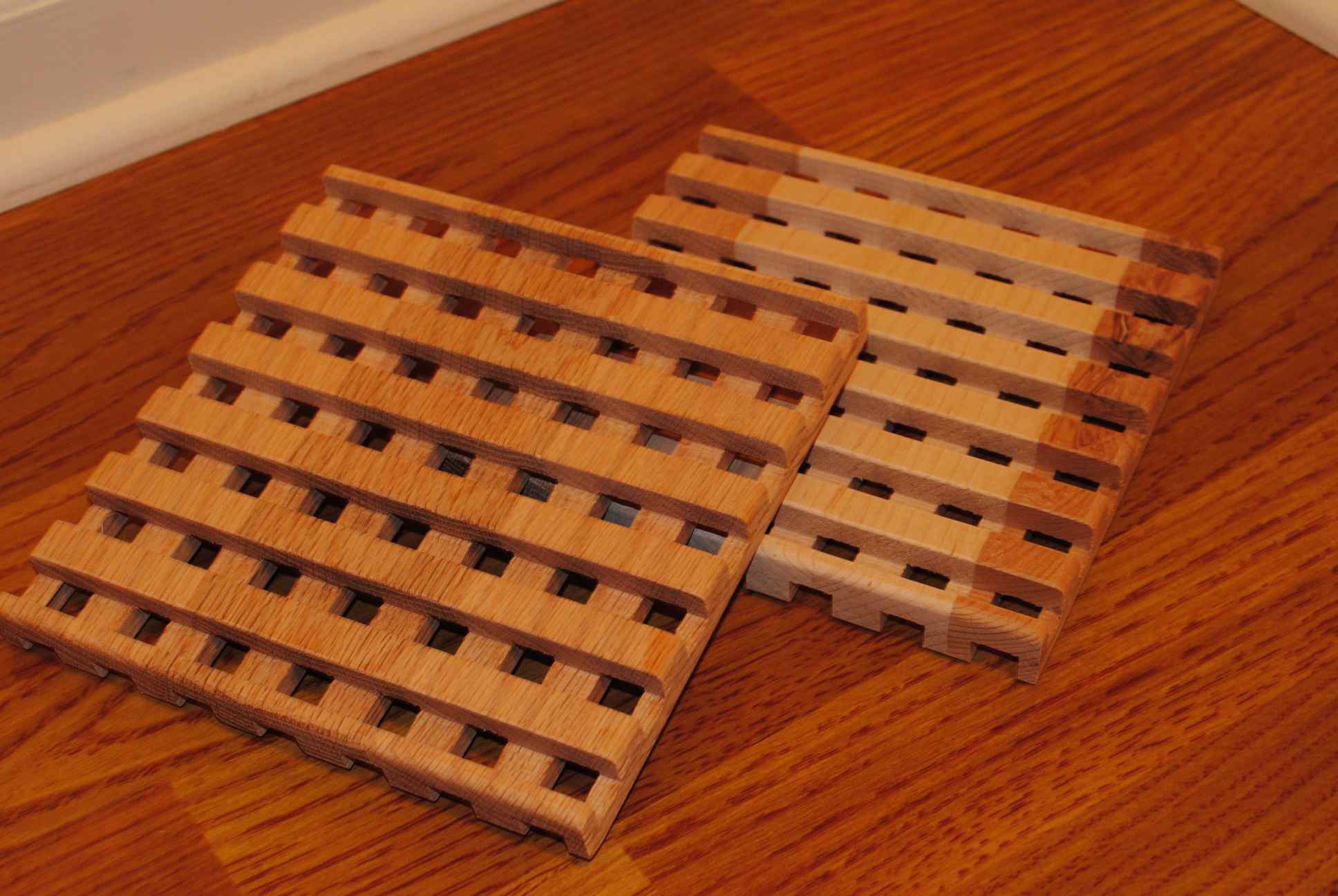

    Second, I made a trivet for each of our grandmothers. One is made from oak, the other a combination of random scrap including, oak, maple and beech. I really like the one from scrap. I think it catches the eye a little better.

    Nice work, Justin. I can see a number of uses for the pizza shovel. Pizza shovel, fan, student-correction device, etc. I like the trivets too. What are their sizes?

            The Trivets are 7". In hindsight 8" would have worked better for spacing, but since this was a scrap wood project, 7" had to work.

              The trivets are a great idea...good use of scraps. The pizza shovel...called a "peel" is unique. Nice work.

                Everything looks great! Nice use of all the "bits and pieces" that, for some reason, I can't seem to put in the burn bin.
                How did you cut the grooves in the trivets, dado blade or router bit?

                    I like the trivets and will blatantly steal your idea too
                    It looks like you glued up a single board and then routed the grooves into each side - right?

                      I used my dado blade stack to make the grooves. It's very easy to make. You start with a centered cut on both opposing sides, then keep moving the rip fence.
                      Couple of notes if you try to make one. I had a lot of chip-out on the cross-grain cuts. If making them again I would add/clamp an extra block on the trailing side to reduce chip-out. Also, I would have made the cross grain cut first, then the long grain cut. I had to clean up a few stray fibers inbetween the groves with a small file.
                      I aslo rounded over the outside edge with a 1/8" round over bit and sanded to 220 grit. I haven't added the finish yet, but will do when other projects get completed.

                        You are correct.
