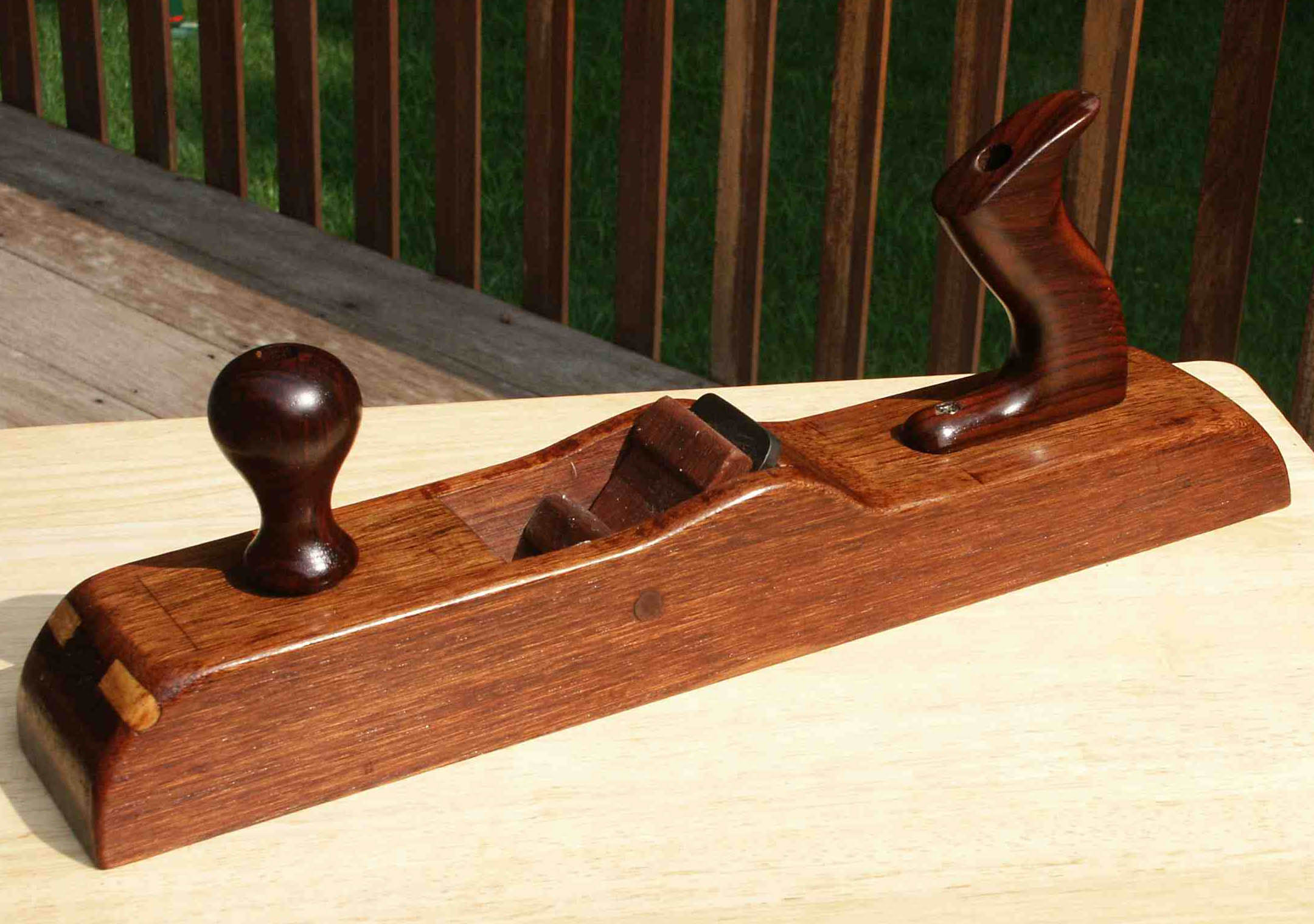

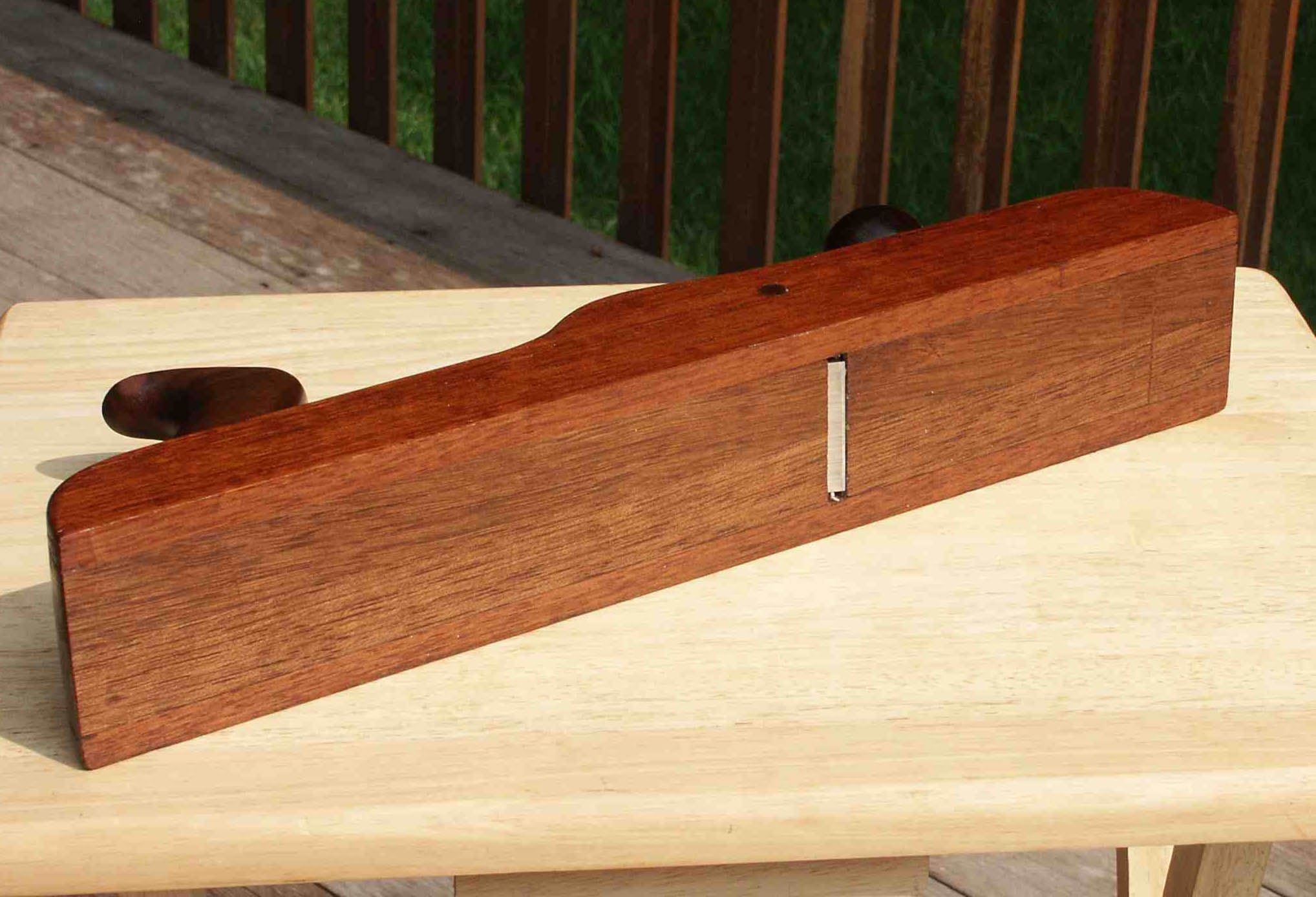

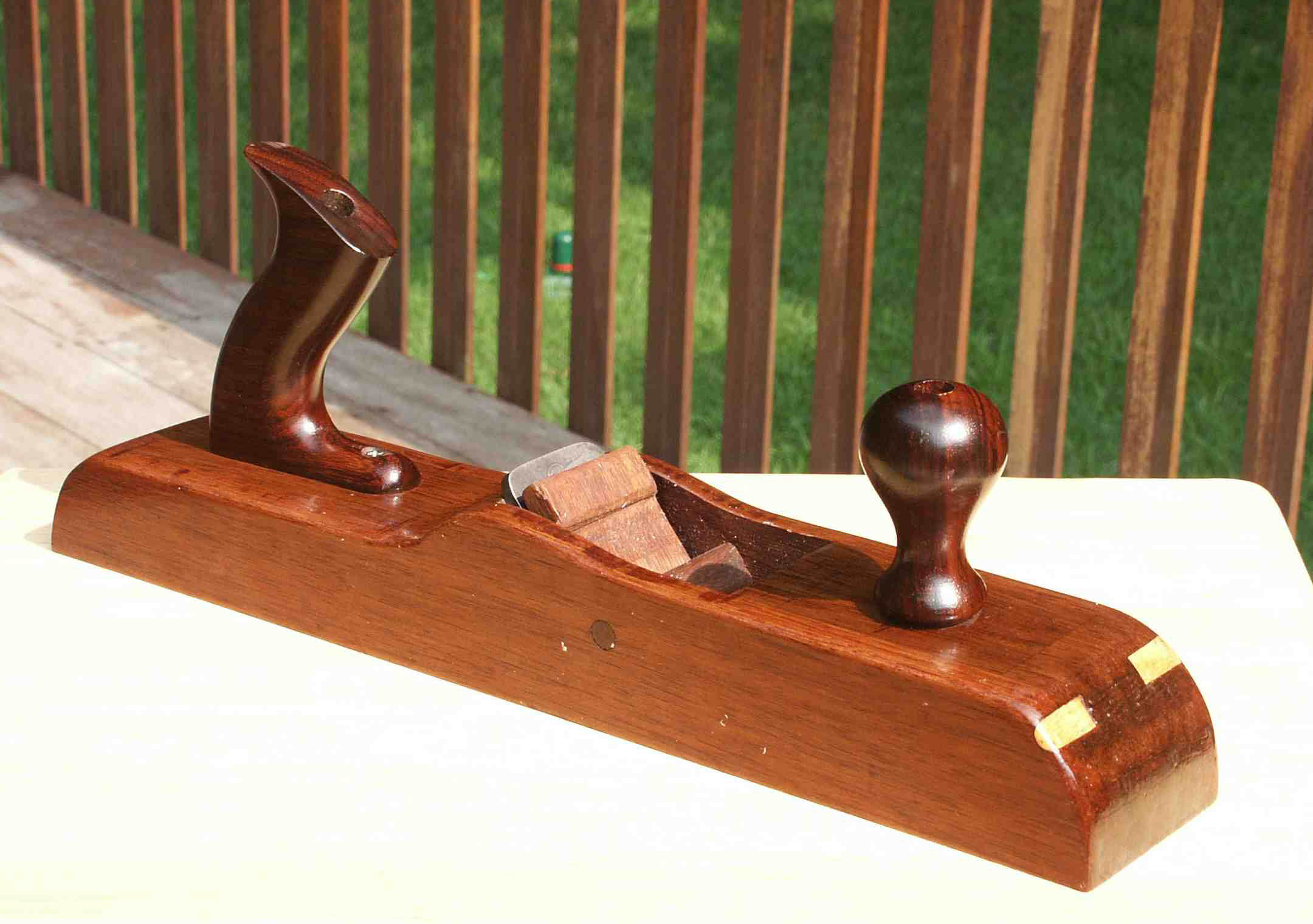

    A couple of months ago I posted pics of a jack plane I made. It came out and works so well that I decided to make another, a jointer plane. It's 17 inches long, made of mahogany with rosewood knob and tote (which I purchased). The iron is from Hock Tools. I used the "scary sharp" method to sharpen the iron. I can shave with it. The Krenov style plane is rather boxy, so I gave it more of a Blum Plane style. It planes beautifully. The mahogany is natural, no stain, only oiled with teak oil and hand rubbed. Hopefully, photos are attached. I still haven't figured out how to use this site yet. Next, I'm determined to learn how to hand cut furniture grade dovetails. Wish me luck!

    Nice looking plane...well done. What did you use for iron adjustment?
      That's really good looking! How heavy is it?
      One thing I like about my Stanley/Bailey No7s and No8 is the mass. They take a little more effort to get moving, but they will work right through difficult grain a lot easier than my smaller planes.

        Very nice, almost a shame to use them....

          Beautiful! I am so jealous!
            Cabinetman,
            Thanks for the comment. No special iron adjustment. It's still basically a Krenov plane so a simple wedge holds the iron in place. I usually adjust the iron to get a small bite, with paper thin shavings.
              Erik,
              I think you are right about the mass. I have a couple of Stanleys also. This plane weighs about 2 3/4 lbs, so I think it's a light weight for a jointer. I'll know better after I use it for a while. I use the jack plane I made all the time. This plane cost about $85 to make (less if make your own tote and knob). The iron is the big expense. Still, a good jointer is probably a couple of hundred bucks. Too much for me.

                That is pure art, functional, but art.
                What a beauty.

                  WHat are the white things on the front that look like head lights?

                    Light weight has it's advantages too. When I did my bench I flattened the top with a Woodriver No 6. It weighs about 7-3/4 lbs. I was a little sore the next day.
                    At the time all I had was the new No 6 and a little Stanley No 3. I probably should have put more of a camber on the iron, but I planned on using it more for jointing so I flattened it out. A good scrub plane would have been in order for the rough work (still looking for one).
                    Yours ought to work really well for edge jointing. I think the lighter weight would be an advantage in that type of work.
                      That is a thing of beauty!
