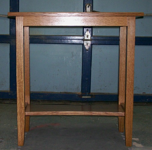

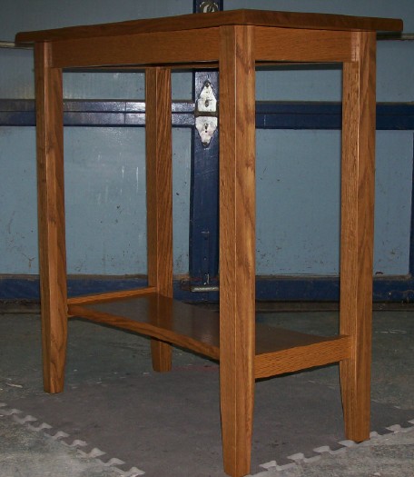

    A basic straight forward build as my neice needed it now for a Mission Twin Bed I posted a couple of weeks ago I built for her. A 3 day build with 1 1/2 weeks for sanding.. finish and cure time. Made from the last of a large batch of QSWO I had on hand so a mixture of heart.. sapwood.. etc. I didn't bother to quad-linear the legs to get fleck on all sides as now meant now. A few pics in the shop before it departed to accompany the twin bed. Just stayin' busy in the summer heat...
    Looks pretty decent for a rush job.

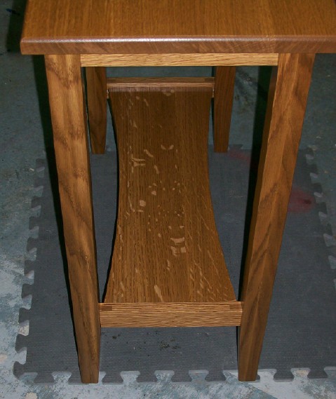

    How is that joint working on the lower shelf stretcher? Looks something like a loose tenon/bridle joint thing. Interesting.

                  Regarding the joinery on the bottom. I was in a hurry so I cheated on the bottom shelf. All the top stretchers are traditional M & T's but.. I picked up a few hours on the bottom stretcher and shelf with what I call cheater joints. The bottom end stretcher does have a standard mortise in the legs but the tenons are float. I dadoed the ends of stretcher 3/8" x 5/8" and then ripped a full float tenon the width of the stretcher 3/8" thick. Just glued it in to form the actual tenon itself.
                  The bottom stretcher has also was dadoed on the inside 3/8" x 3/8". In lieu of a traditional tenon on the ends of the shelf to insert into the dado I stood the shelf on end and cut another dado 3/8" x 3/4" deep. Another ripped to size (3/8" thick) float tenon was glued into the dado. I used glue on the middle 6" only so the tenon could expand. And I left the shelf width shy of the legs 1/4" on each side for expansion also.
                  A little curve on the front and rear bottom shelf to break the monotomy of rectinlinear and add just a hint of pi-zazz to an other-wise straight up design. That's about it as I was definitely in a hurry. I need to add onto an re-enforce my back deck. She said so.... haha...
                  Any further questions.. please ask!
