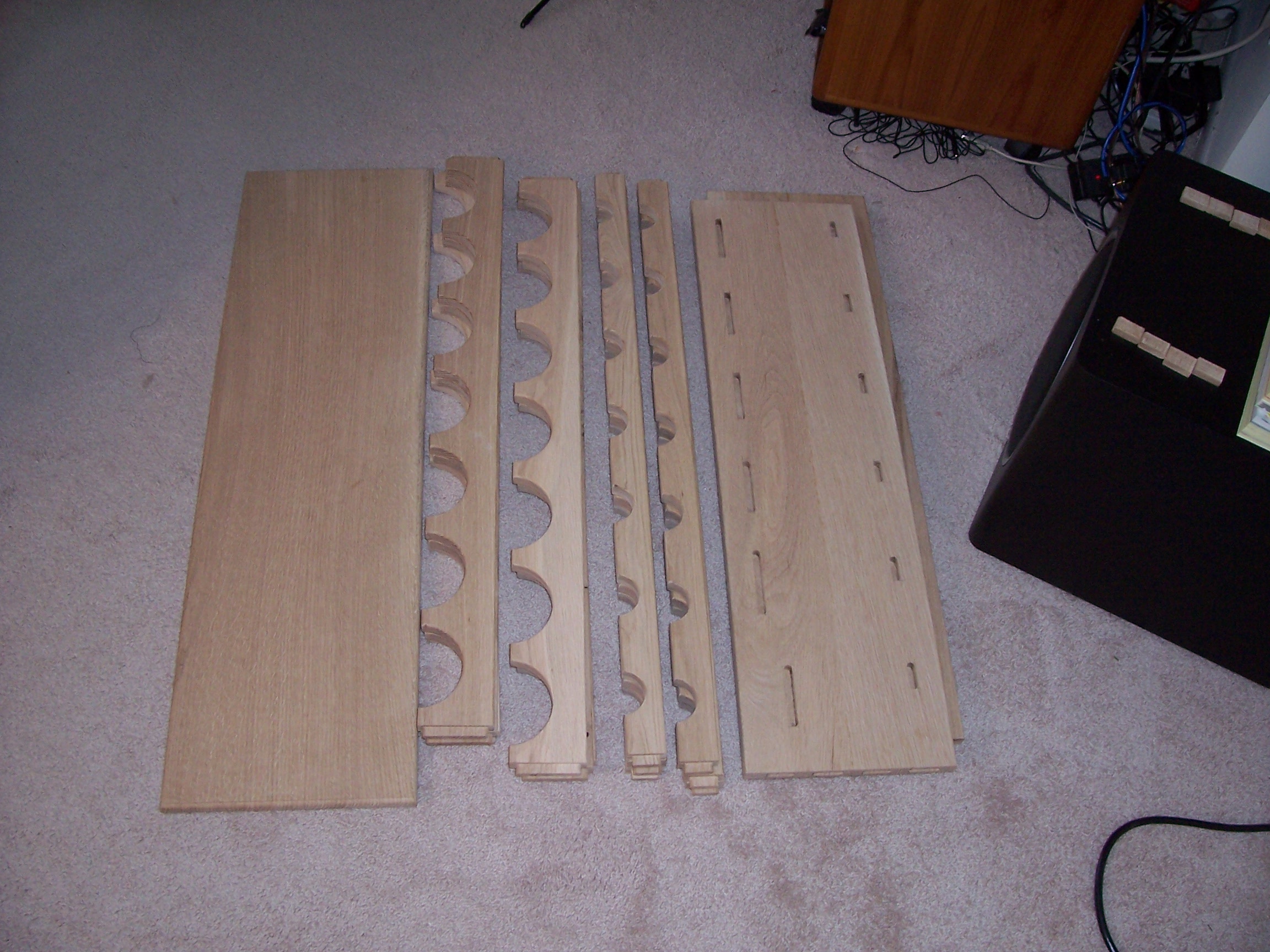

    The 30 inch snow storm that we had in December gave me the time to surface all the wood, cut all parts to size, and cut the holes for the wine bottles, and glue up the sides. Pictures were taken, and the in-laws received photos of the cut parts with a couple bottles of wine on Christmas day.

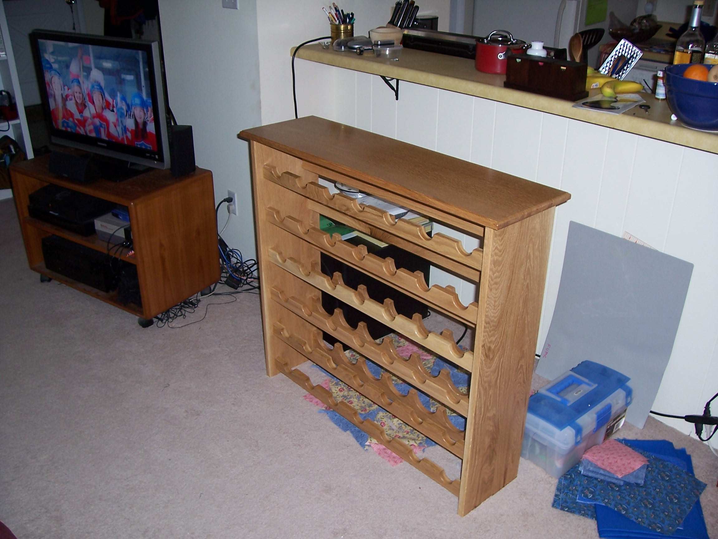

    Finished wine rack hanging out with LOML's quilting supplies.

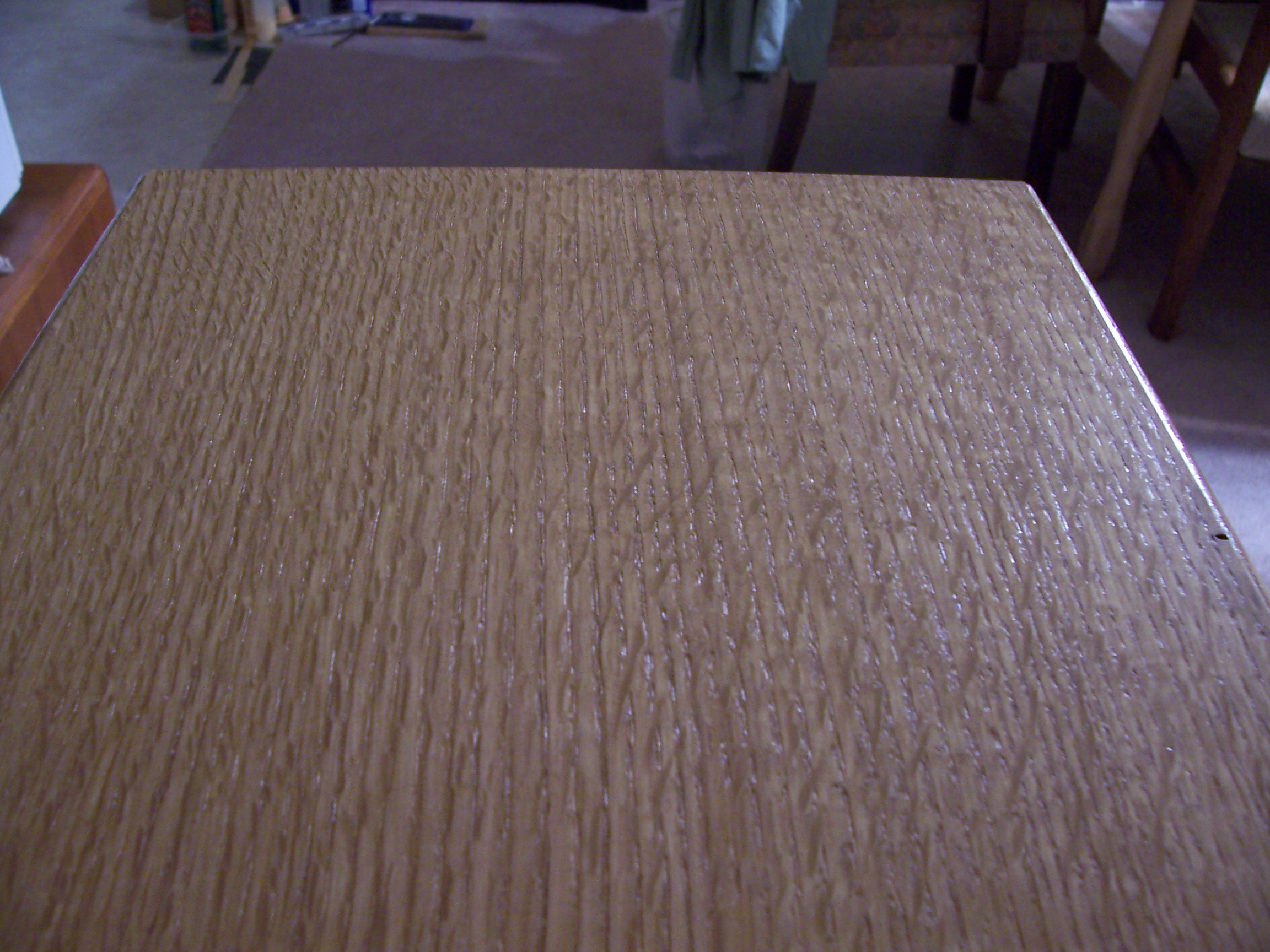

    A close-up of the grain on the top.

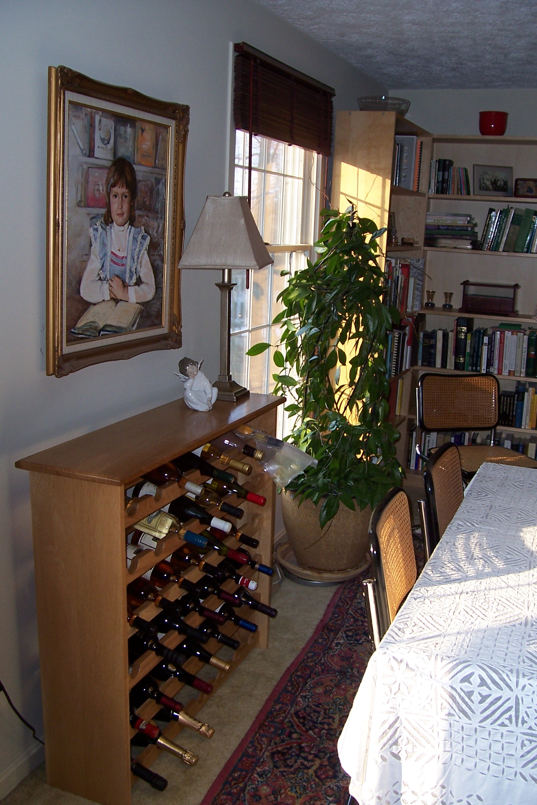

    The rack in use in its intended habitat, my in-laws' library.

    Nicely done! That top is a thing of beauty.
      Looks very good. Your in-laws should be very pleased.
      One thing that might help it a bit is a base. Maybe 3" or so. It would block the view of the carpet below and especially get the lower bottles a little further off the floor. I only say that because a friend of my folks had a metal one with the lower bottles close to the floor. The neck of a bottle of red wine got broken off during vacuming. They put a rug under it until they repleaced the carpet.
        Great idea! I had thought about doing some sort of legs on the side panels - probably would make it a bit more resistant to slightly uneven floors, but I couldn't figure out exactly what to do (also didn't trust my jigsaw not to ruin the piece somehow). Believe it or not, the bottom rails are raised an inch or two from my prototype. Adding a low base would solve both issues - would make it much easier to add feet, since the base could have either a slight scroll with simple and elegant feet or be nearly flat to the carpet with hidden levelers underneath. I like that. I will keep that idea in mind if / when I do another one.

                  Nice piece, Bryan. The QS White Oak top has some great fleck patterns in it.
                  If you work with White Oak a lot, try ammonia fuming sometime. The fumes react with the tannins in the wood and creates a patina like natural aging.
