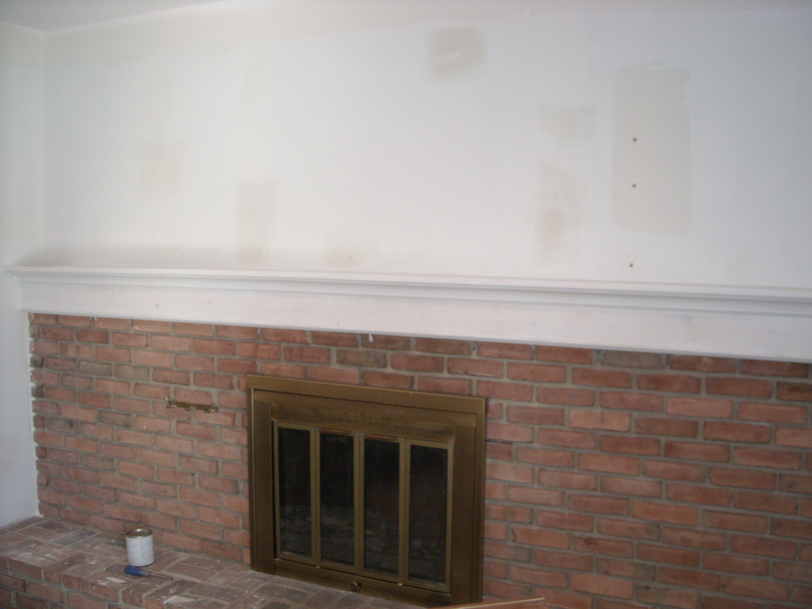

    This is my first paid project. A co-worker of mine has been remodeling his house and the old mantel wouldn't do. The old mantel was basically a 2 x 8 on top of the brick.
    The new mantel I designed and built is 9" tall and 10" deep and 11 1/2' wide. All material is SYP and primed as shown. I'm going back tomorrow to do the final painting.

      Looks good. Did you make the moulding?

        I bought the molding for this one. Since I was being paid to build it, I factored the cost of the molding into the job.

                Looks terrific. How did you attach to the brick?

                  I actually attached the mantel to the wall. I used a 2x8 against the wall, secured by the new, no pre-drilling lag screws attached to the studs. I then used 2x4's to block out the structure from the wall. These 2x4s were also supported by metal hangers, with the hangers being screwed to the wall. I then built out from there. My customer commented that he could tap dance on top because it was so sturdy. The rest was attached with a nail gun and brad nailer for the molding.
