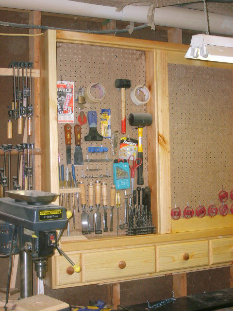

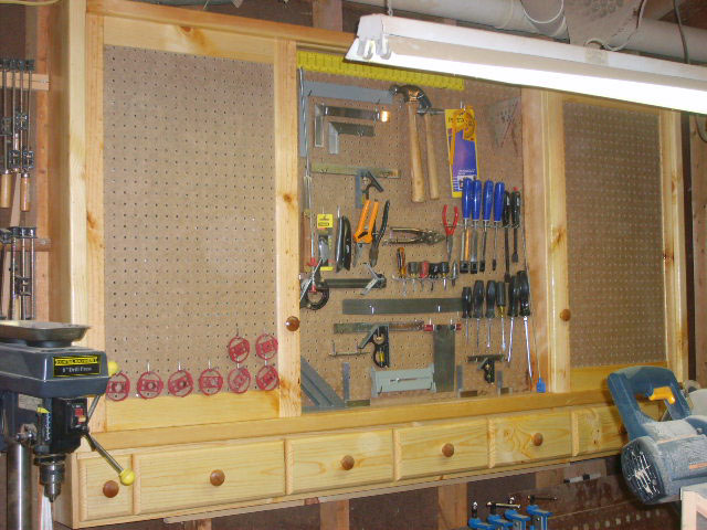

    Saw them building this cabinet on Woodsmith a couple of weeks ago and decided it was just what I needed. Found the free plan download at http://www.woodsmithshop.com/downloa...hopcabinet.pdf
    I did make a couple of changes, instead of bins I made drawers and I replaced the aluminum bar the doors slide on with an oak bar. (works great) This replaced some old pegboard and increased the storage space by 50%.
    This is the cabinet:
    and this shows how the doors slide

      I have always looked at the plans and wondered if it'd be too big for me to chew; how long did it take you to build this? Did you use the same dimensions as in the plans?

            Sometime I wish I went with a sliding design. I did pegboard doors over the stud space. http://www.bt3central.com/showthread.php?t=39255 being able to use all the sides of he pegboard is nice, but the doors can sometimes be problematic if I have too much stuff on the bench in the path of the door swing. I also wish the interior space of mine was a little bigger too. My newly procured #8 plane won't fit with the rest of my planes.

                Thanks everyone, Yes I followed the dimensions in the plans. The only ones I changed was removing some of the bin dividers and building longer drawers. The project took about five days, 2 days on the building and 3 coats of poly over 3 days. I was very pleased with the plans, they are very detailed and every dimension was dead on.
                Of course it made me look at some of the other shop storage and I am now in the process of tearing out some ugly shelving I built 25 years ago and am building some new cabinets to replace them. These will be plywood using pocket hole construction.
