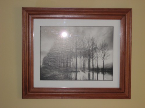

    We had a couple of pictures that my wife hated the frames. We found some left over hardwood baseboard from an old job that her company had done. I cute down the baseboard, planed, and the used a few router bits to make a profile. And this is the result.

    Very inventive, looks great....love the color. What did you use to finish?
      Nice work!

        Nice work indeed!
        Turaj (in Toronto)
          Good miters on the corners. Nice color and finish.
            Nicely done...looks very professional.
              Great looking frame. Love the finish (and the profile).

                That's a great looking frame! What was the game plan on the the type of bits you used?

                  Good idea and good job...
                    Nice job. Like the picture, too. Is it a photograph?
                      I agree it looks great. Now how about some instructions?
                        Not much I can to what the others have all ready said, but I really do like the finish.

                          Well I am not sure of the type of wood it was, but peachtree a few months back had their Freud 3 Piece Picture Frame /Molding Set on sale for about half off. After playing around on some scrap wood I found a patter I liked. The Cove & Bead Groove Bit for the in side lip and the Face Molding Bit #1 on the outside. Just played with the spacing. Then cut the miters glued clamped and used the Pushmaster that I had picked up I think at rockler when it was on clearance. Used it to put 3 v nails in each corner. Once dried I add a rosewood stain and then finished with poly. Put on one solid coat and liked the finish as is. I was planning on more coats, but I liked the look after one coat. Figured it is a frame and there should be much wear and tear on it so one coat I hope will be enough.

                            I love the color! My cabinets are a similar color. Do you think the wood is maple? Great job
                              Very nice, love the profile.
