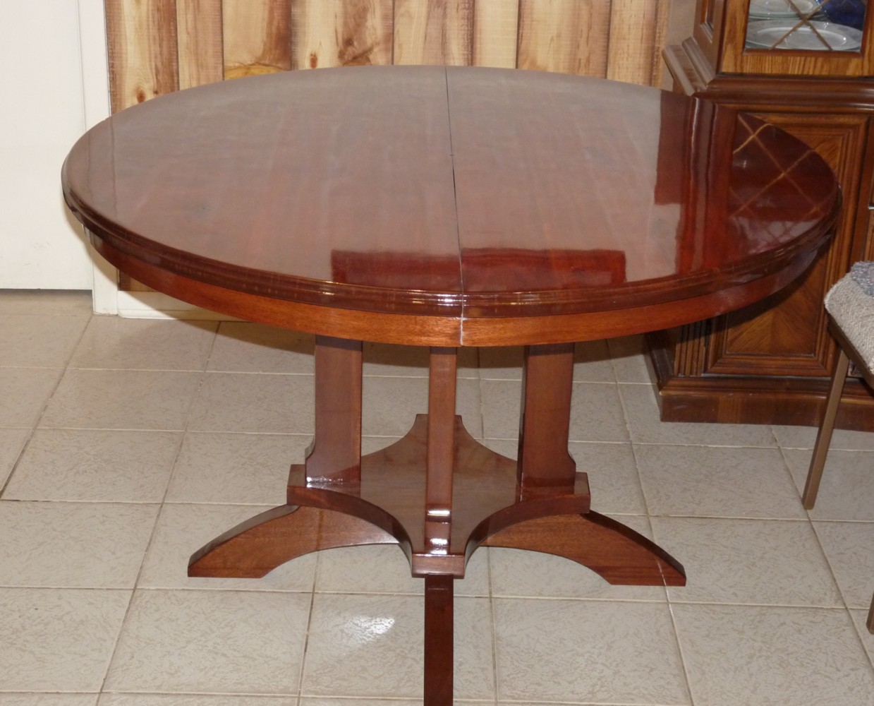

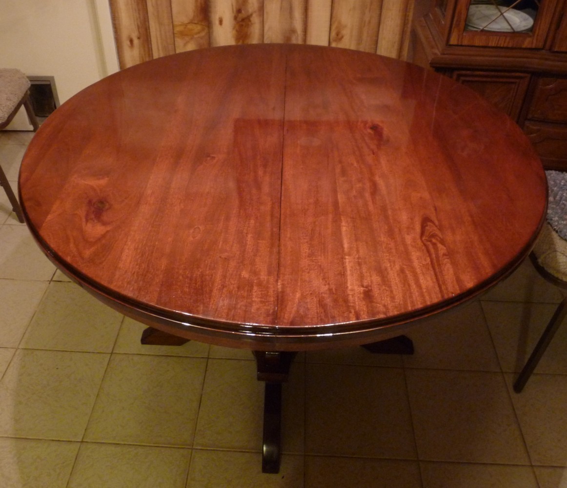

    OK, maybe not entirely done. Still have the leaves in the shop but they'll be ready by Thanksgiving for dinner. Thanks to everyone who gave advice, I did several firsts on this one including bent lamination and cutting my own veneer for said lamination on the skirt, and cutting large heavy circles and working with mahogany. Of course, I see every mistake and boggle I did but LOML loves it so that's what counts. The design is from Wood magazine.
    Finish schedule -
    Stain with equal parts General Finishes Antique Cherry, Spiced Walnut, Mahogany
    Fill Grain with Behlen brown and sand
    Restain
    10 Coats 2# blond shellac (never mixed my own before).
    Sand flat
    2 Coats Arm-R-Seal
    Let sit unmolested for 2 weeks.
    Next is the chairs...

      That is some finish! Great job. I am assuming that the pedestal will remain fixed and the top will extend to accommodate the leaves. Any designs in mind for the chairs?

        Thanks! Yes, the pedestal is fixed, I got 28" equalizer slides from Rockler so you just pull one end and it opens up. The chairs are mission style and I can't decide if I like them or not (or more important, does the wife like them).

                          Beautiful piece of furniture! I bet it was hard not hurrying through that finish process. The finish is so deep, it looks like that cabinet behind it is passing right through the table!
