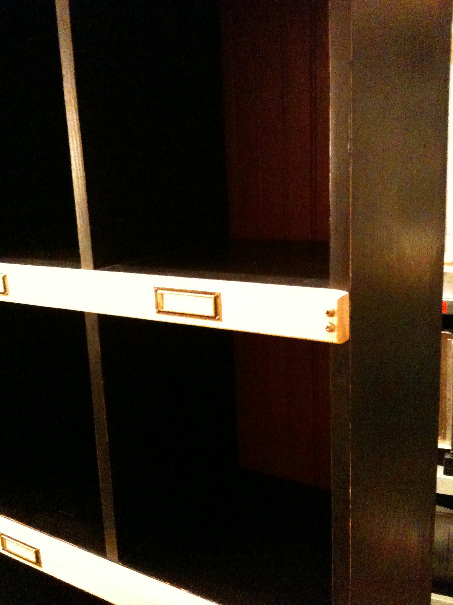

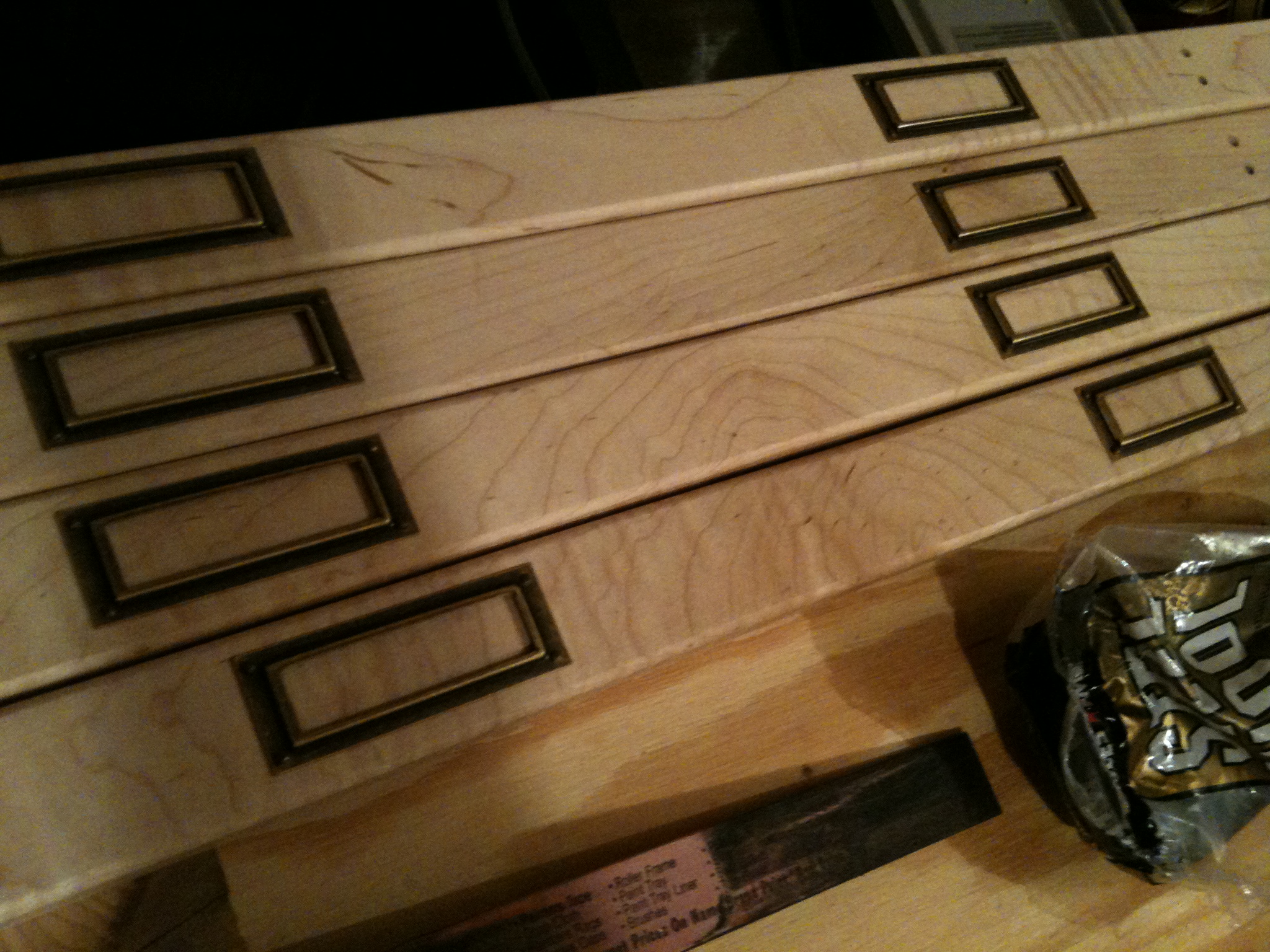

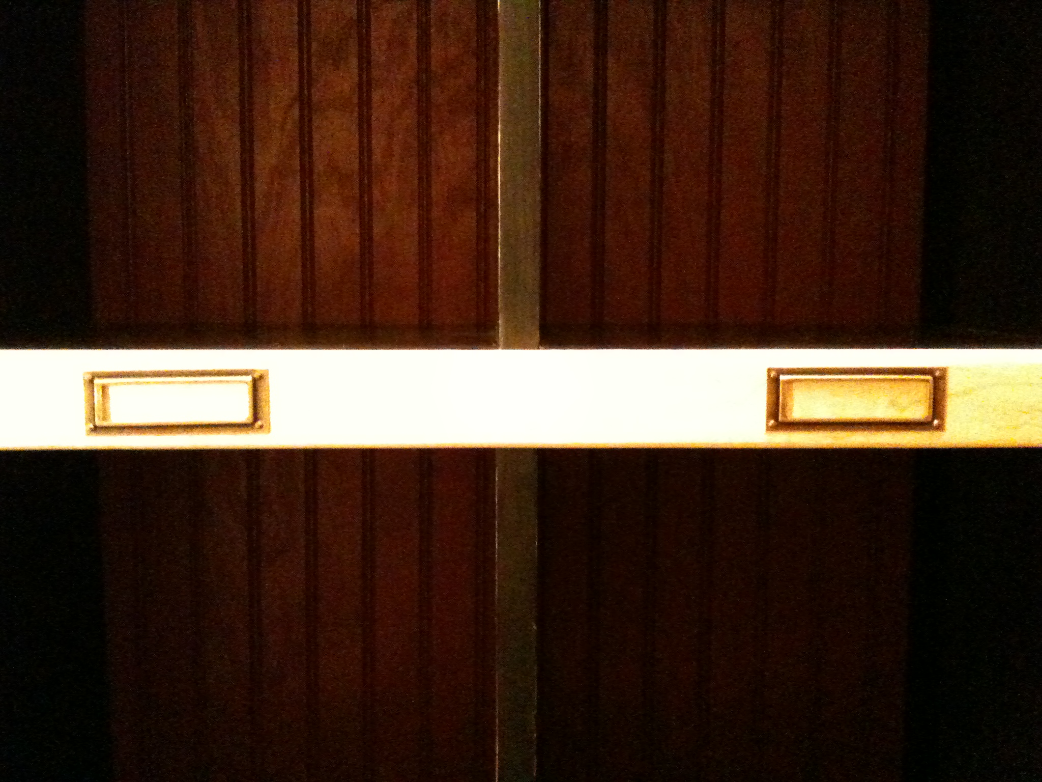

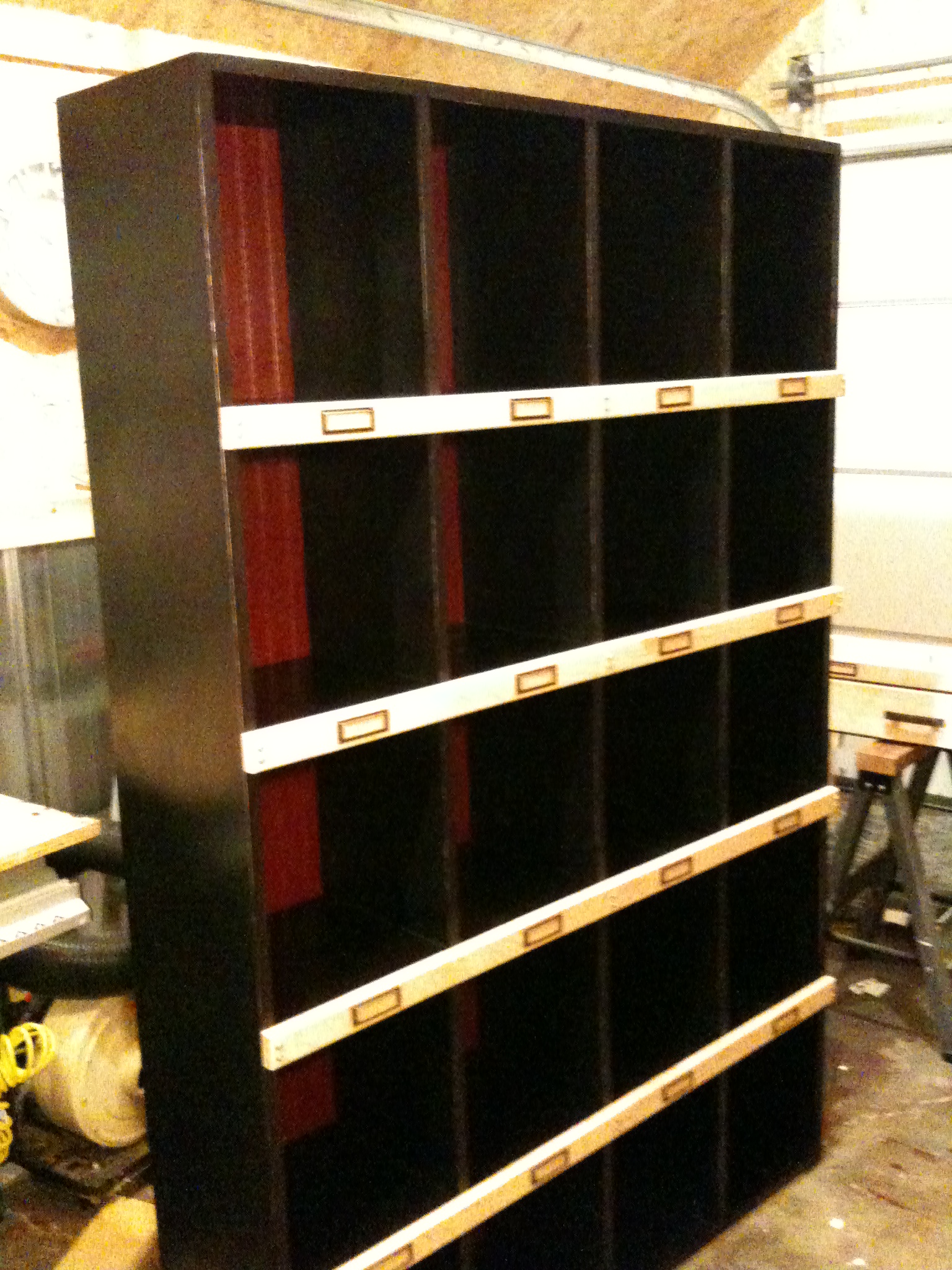

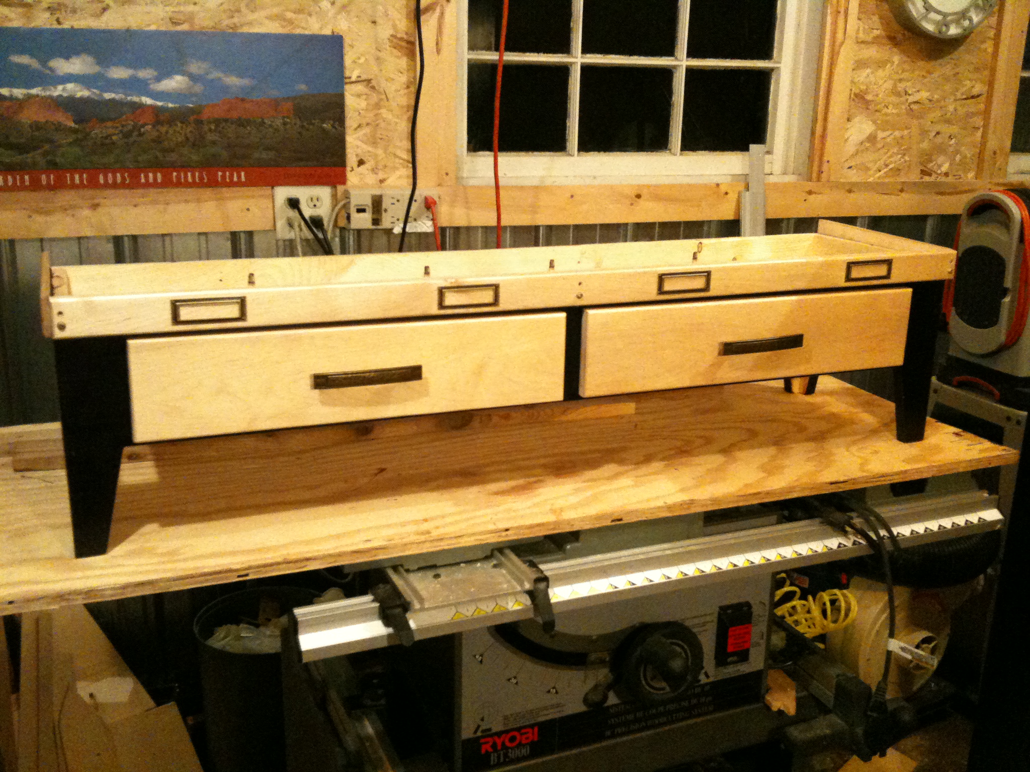

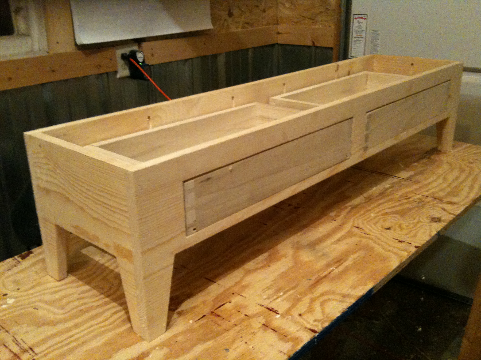

    I used pine for the frame and base, and maple for the accent strips and drawer fronts. Pine beadboard is the backing for the cabinet. Nothing too special about the construction, pretty basic. I cut grooves into the sides for the shelves using a router and straightedge, and put the vertical dividers in with biscuits. It was a little challenging to glue and clamp everything together given the size (4 x 6 feet for the shelf unit).
    I painted the back with 2 coats of claret red Rustoleum Americana paint. I painted the shelves and sides and base with 1 coat of claret red, then 1 coat of canyon black. The topcoat was thin enough to allow a little of the sheen of the red to show through. I distressed the edges with sandpaper and the sides with an old chain. I then waxed the painted surfaces with paste wax applied with 0000 steel wool. The maple strips and drawer fronts were finished with Danish oil.
    I "antiqued" the shiny bronze screws by soaking them in 50% ammonia for 1-2 days--worked great!
    The cabinet is built in 2 parts to make it easier to transport, with pocket screws used to attach base to shelves.

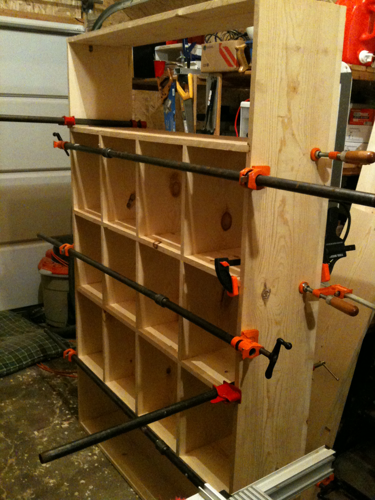

                        Nice work. How did you handle the glue-up on such a large unit? Looks like you put it all together in one shot - with all those clamps.
                        Howie
                          Howie
                          It wasn't easy! I do think at times I used every single clamp in my shop simultaneously.
                          The dimensions of the cabinet--6 x 4 x 1--made it a very unwieldy piece to work with. I glued together the top, bottom and sides first, after routing grooves in the sides for the horizontal shelves. I assembled the horizontal shelves first, gluing the vertical dividers with biscuits joints, one section at a time. I then inserted the 4-shelf unit into the outer frame--had to use some clamps and rubber mallets for extra "persuasion". I glued in the top and bottom vertical dividers last, with pocket screws to help them stay in position during glue-up (pocket holes later hidden with wooden plugs).
                          It wasn't the most straightforward assembly I have ever done. In retrospect I think I should have attached horizontal shelves with pocket screws and assembled it shelf by shelf. Less strength, but vertical dividers would have added to stability.
                          A couple of lessons: "prefinished" pine boards often have some cupping and bowing that becomes apparent as you assemble the piece; when you buy a board that says "1 x 12" it's actually 3/4 x 11" (duh--forgot about the width being nominal); when you put a lot of boards together the piece starts to get pretty heavy and is a real challenge to work with.

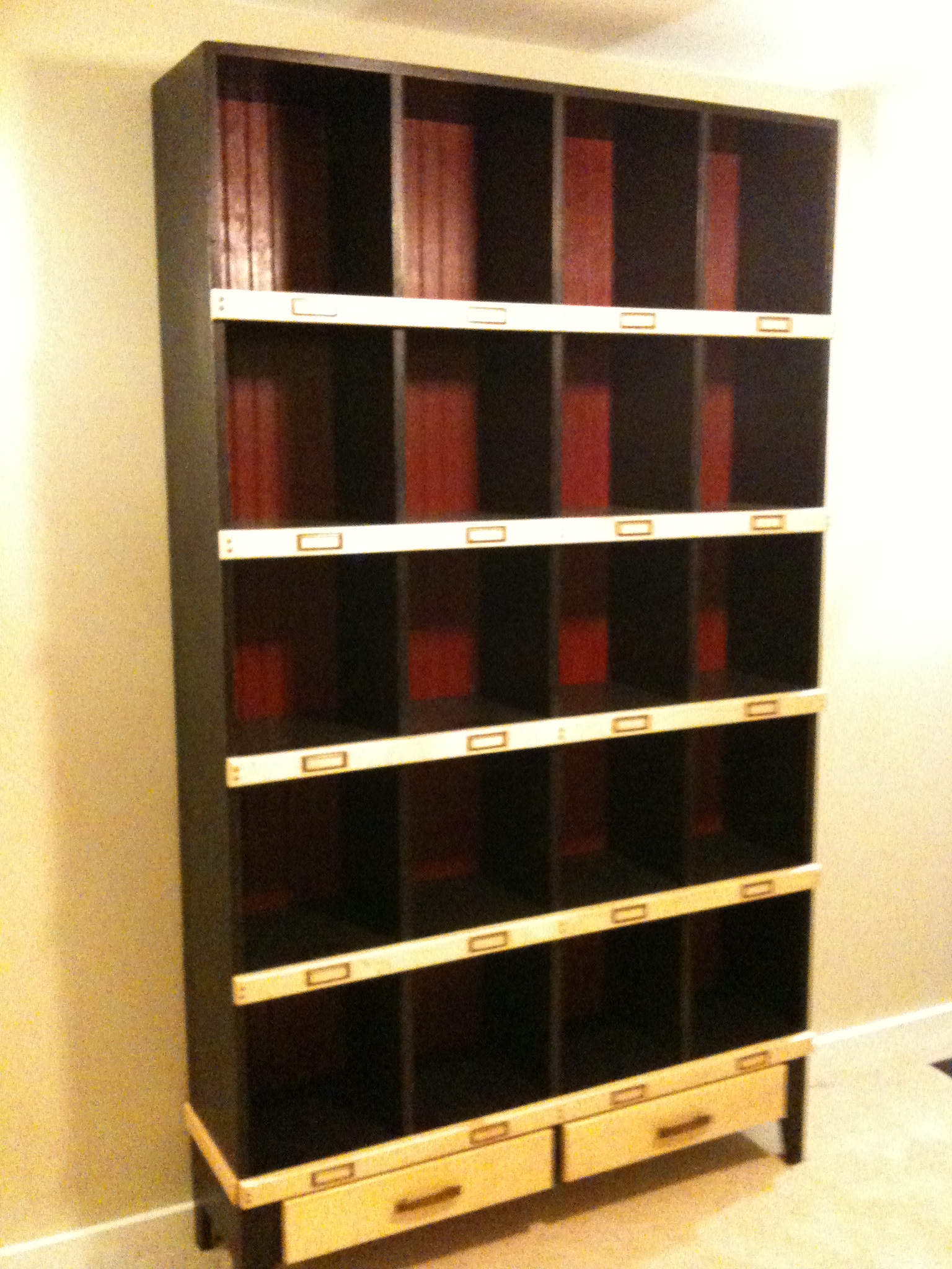

                              Here is pic of completed cabinet installed in Michelle's basement. Fifteen minutes later it was already filled with all her quilting stuff and nicknacks and collectibles.
                              I even got a kiss for it...
