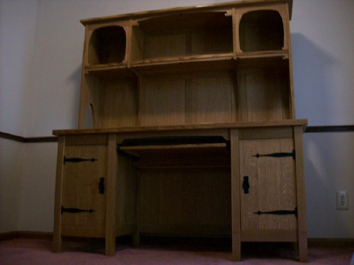

    My eight legged computer desk-hutch using random design elements from 4 A & C designers with twist and turns from me. An attempt to blend old design with modern electronics. Indeed a challenge for me with no plans other than crude notes made on a note-pad. My 8th carcass piece in 21 months and at this point my jar of bent 16 penny nails is almost empty.
    QSWO solid carcass with veneered back panels. Full extension drawers in maple.. hickory inner supports.. ebony buttons. 8 quad-linear legs (QS fleck on all 4 sides of leg) which doubles my pleasure.. doubles my fun. Final fascia trim all done with hand tools just because I can and time is no issue. A secret compartment to hide surge protectors.. wires.. etc.
    It meets the functional requirements I set out to achieve.. I think? Approximately 180 hours of non-stop fun in this one as it was basically designed and built "on the fly". I have never used a set of plans and I suppose I'm set in my ways at this point and probably never will.

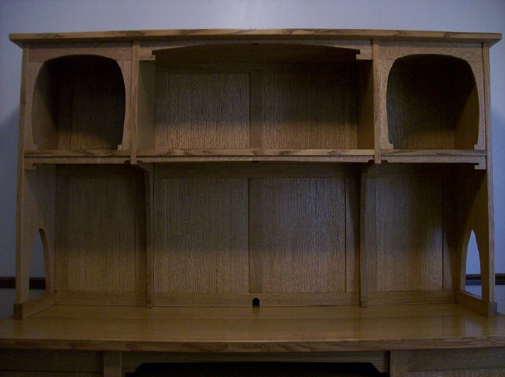

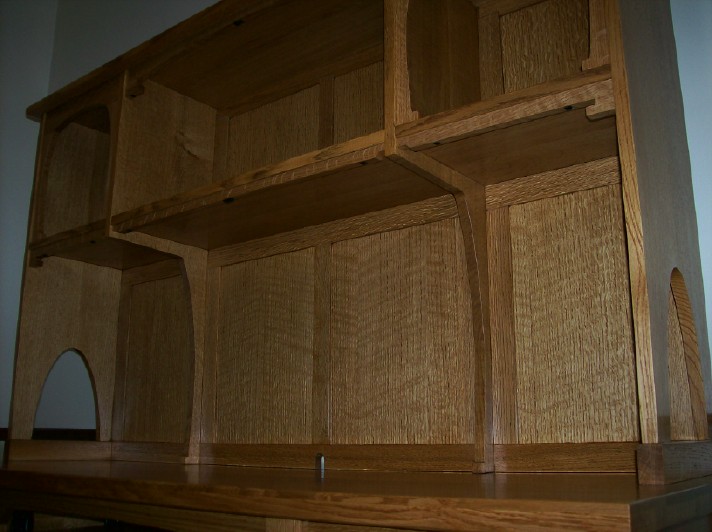

          Looks great, QS oak has a really nice appearance. I do like the small details at the joints on the top hutch. I'm not too sure about the vertical curves on the small openings though. It might be more of the shadows, they look better in that next to last pic. It's still an impressive piece!
          What's the finish?

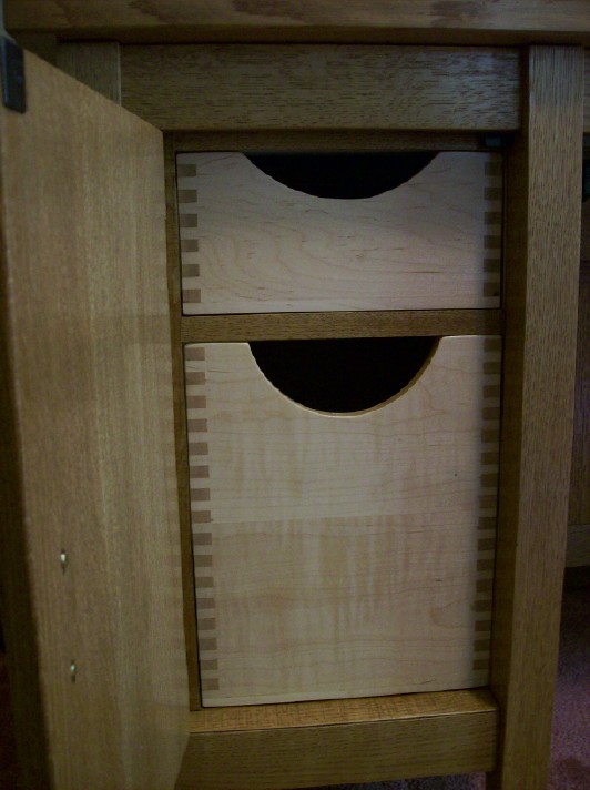

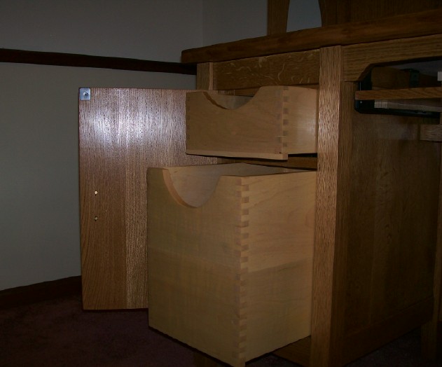

          How'd you do the bottoms on the box joint drawers? A stopped dado?
          Did you do a pull out for the computer case? I'm assuming it'll go in the right side.

                      Eric.. I had to modify the original Liberty and Co. design on the top hutch. The center of theirs had doors an it was closed. The boss wanted a small printer over the monitor so I had to leave it open and allow enough space for the lid of the printer to open to get photo-stats in. The outer compartment verticals on the L & Co. were wider but again.. I had to modify to accept computer related DVD's.. back up's.. etc. on those as the wide took too much space with what was left after the center widening to accept the printer. This design was a bear from the git-go as I had to calculate for her computer needs and try to maintain balance of old design with new style toys. The good news there is she loves it and.... it's simply One of a Kind and you won't find one like it at IKEA.
                      The finish is simply Bartley American Oak stain ( I don't do fuming these days as I have had enough chemical fumes thrown my way already) with 5 coats of Mini-waw satin cut to 60%40% with naptha and wiped on which is the only way I will use poly these days. Wait two weeks to cure and the final tint is rubbed out with Liberon steel wool and Liberon medium oak wax which is tinted. Kills two birds with one stone by application of wax with 0000 steeel wool which knocks sheen down.
                      The drawer bottoms simply do sit in stopped dadoes and maple 1/4" ply is used for the bottom on the top drawer and 1/2" on the bottom which will hold some weight. Drawers have Accuride bottom full extention runners. The CPU unit does go on the right side and the rear of that cabinet is open for ventilation. There is no slide out base even though I considered it but.. she said the CPU only weighs about 10 pds. so... don't bother as once connected very little reason to pull out and easy enough if you do.
                      Thanks J. King... I also like those hiinges obviously. They are 10" and were somewhat hard to find in that lenght. But.. they are out there and if can't find what you want.. PM as I had to do a lot of home-work to find thoise in that style and lenght. Plenty of longer ones but had to balance for the size of door width.
