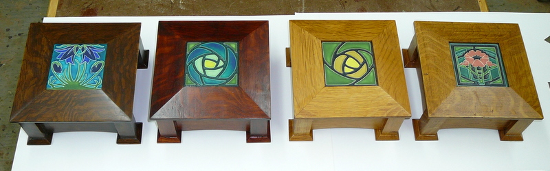

    For your consideration...four boxes made from QSWO that have taken me forever to make.
    The design is from a WOOD magazine from a few years ago. I've always liked the look, so I decided to make a few for presents. These are the first display boxes I've made as well as the first time I've built something from a plan. I learned a lot from making these, most about how to fix stupid mistakes.
    The finish ranges from a simple BLO/shellac finish to Jeff Jewett's answer to fuming by using dye, shellac, gel stain, and wipe-on poly to simulate that Stickley look.
    Overall, I'm very happy how they turned out but I'm also very happy that they are finally done. I've been working on these for waaaaay too long.

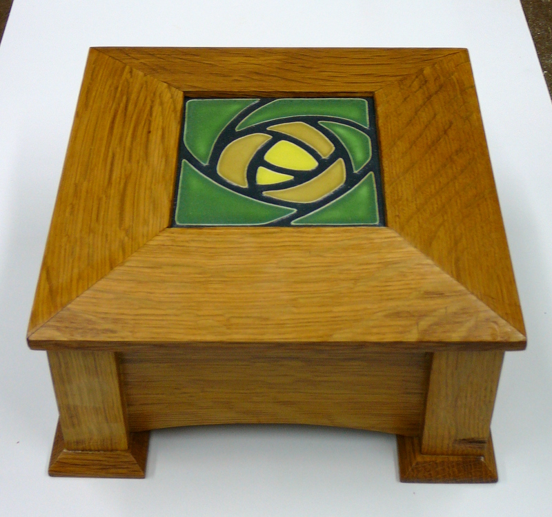

    Medium Reddish Brown/Medium Brown (2:1) dye + walnut gel stain

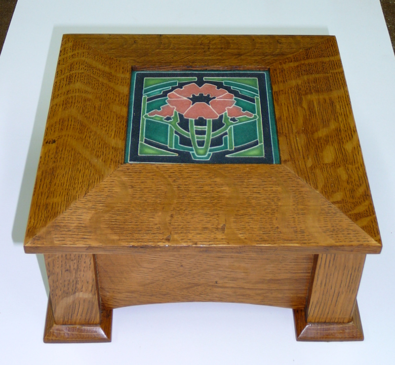

    Dark Mission Brown dye + walnut gel stain

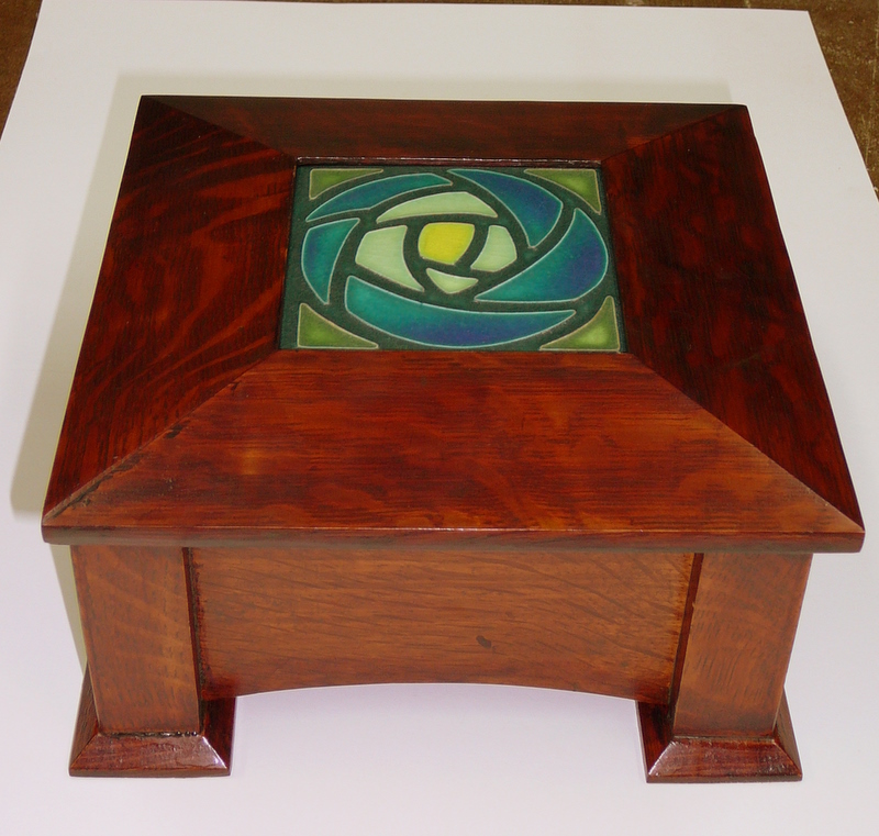

    BLO + shellac

    BLO + shellac + dark brown wax

    Those are gorgeous. Did you make the stained glass inserts also or were those purchased.
      Those look great...nice work. How about an inside pic. Is that a tile insert?
        Great looking boxes. I especially like the finish on #2 and #4.
        What kind of joinery was used between the sides and the corners or legs? Can we see an inside view?

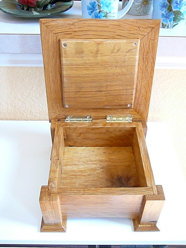

          Here's a pic of the interior. The inserts are ceramic Motawi tiles from http://www.artsandcraftsman.com/. The trickiest part of the construction was cutting the lid. I ended up adding a right side miter slot so I could have vertical and horizontal finger boards when making the beveled cuts on the 2.5" wide lid pieces.

                They do look good. I really like the dark dye and the BLO & wax I might have to try out that last one. How did you apply it? in a custom mix, or in an order?

                      I made one of these last Xmas for my MIL. The hardest part for me was the miters on the lid. For some reason I was not paying attention when I cut them and cut them to short.

                            WOW, Ken that finish on the dark mission brown looks like a rich walnut burl. You have done a great job!
