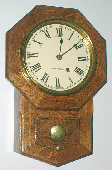

    This old clock belonged to my great grandmother. When it was passed on to me it was a basket case. The old hide glue had allowed every joint to come loose, the face was half gone and the glass was MIA. Repairing the wood was time consuming, all that old glue had to be sanded off. I restained the wood using Minwax Aged Oak stain and finished it with Tong Oil. Luckily I have a friend that repairs old clocks. He was able to replace all the missing parts, I was lucky in that the clock works were all there and still in good condition. It now hangs in my living room.

    Excellent piece John - nicely restored, and an awesome heirloom.
      Beautiful pestoration, John. That is a treasure to be enjoyed by generations to come.

        Nice job John. Looks like it'll last for a few hundred more years. Like the way the finish turned out.

          It was worth the effort, nice job!!

            Great restoration, not only wood but face and brass components. It will be around for a few more generations.
            You mentioned the face was half gone. How did you restore it to what looks like pristine condition?

                    The original face was paper glued to the bezel, my friend was able to get the replacement for it and replace the glass ring and face glass which was missing. Without his knowledge I would not have had a clue where to find the missing parts.

                      I should have mentione it was the Gel Stain, not the regular stain. I love the way it works.
