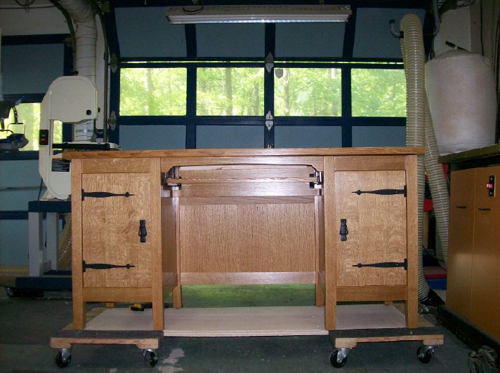

    I wasn't going to post this until I finished the hutch but.. someone ask me to take some pictures today so why not? The finish is on but curing so it has not been rubbed down with 0000 steel wool and wax to cut down the sheen yet.

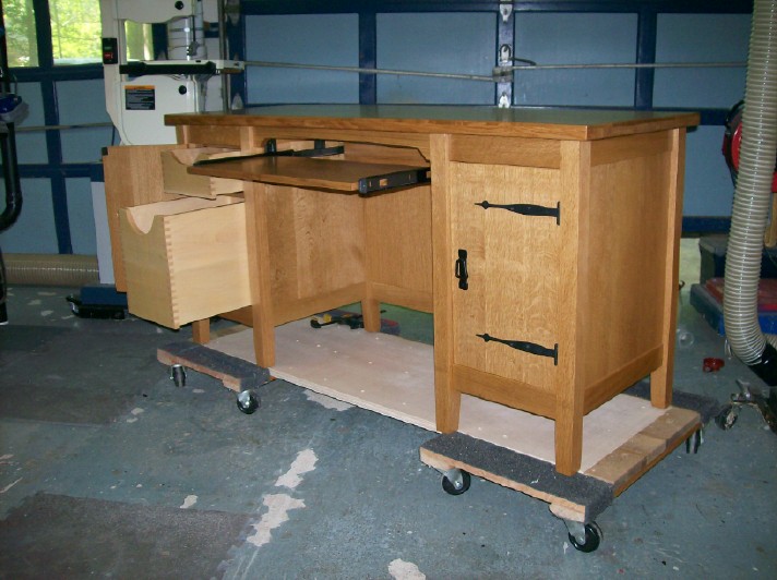

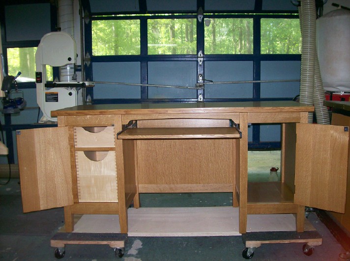

    All QSWO except drawers of maple. The legs are quad-linear so QS fleck is on all 4 sides. There is a compartment behind the key-board open on the rear that will house surge protector and all main wires as no wires will be seen. CPU in right cabinet with open back to cool.. 2 add on after the fact as my wife asked for them in lieu of shelves after the carcass was built with recessed door. That presented a design problem with door clearance but I adjusted on the fly to get it the way she wants it. The drawers are for manuals.. back up tapes.. etc..
    Basically a Stickley hunt-board modified to accept computer components in the way she desired them to be. The center row of drawers had to be eliminated to house the key-board and human legs. The hutch will be a modified Liberty & Co. hunt-board hutch modified to accept her small printer.. speakers.. etc. The top is 23" x 63" x 1 1/4" and weighs around 70 pounds with the base at around 60 lbs. The hutch will weigh another 40 lbs. or so and eventually around 140 board feet used over-all. All M & T's.. bridals and dadoes with box joint drawers as the one my father used at the U.S. Post Office for 35 years before his death in 1959. I loved that desk as a kid.
    Sorry for my photo skills as they are basically non-existant as my computer skills. For those that don't know.. put your pointer in a picture and click to en-large even though this is a computer saavy group with me as an exception for sure.

              Thanks for the kind words, everyone. I have found this a challenge after my wife changed her mind and wanted drawers after I designed a basic frame and panel with doors recessed instead of flush. That can cause a hinge problem as off-set have to be used but.. the door has to open wide enough to allow the hidden drawers to slide out.
              Plus.. by the after the fact.. I did not allow for wooden slides as shelves were her first request. So... I had to build a box within a box to accomodate slides and I went to metal Accuride bottom slides. That was the first time in 38 years I have built a carcass with drawers not using my own wooden built slides. I will say those Accurides are very sturdy as full extenion slides.
              Jack.. borrow away and if you have trouble when you get to it finding the hardware.. PM as I will give you some leads. These are 9" hinges and the most common are 6" .. 10".. 12".. etc. It took me awhile to find 9" to keep proportion and in black.
              Rad.. I have never used anyone's plans in 38 years. I just looked at a picture of a Stickley Hunt-board and a Liberty & Co. hunt-board hutch and draw out a very crude drawing with my modifications. I add the dementions in scribled notes and then go build it allowing for mortise depths and tenon lenghts. I am a seat of the pants flyer you might say.
              Width of cab doors is 12" as our little CPU is 7 1/2" wide. There is actually a bit more side room past the door as the panels are recessed into frames so about 13 1/2"-14' inside on both sides. Keyboard height is around 26" from floor and about 3 1/2" under teh top itself.. not the middle arched stretcher. If you decide to build it.. PM and I will get any exact dementions you ask for.

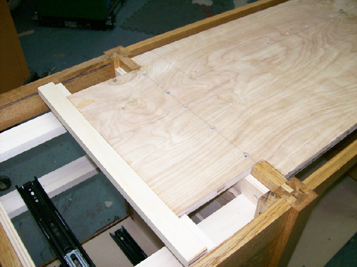

              BTW.. for those interested in building a simialr one... this thing weighs a ton. So... those upper-middle stretchers are not enough to hold it together when you pick it up and move it. To much torque on them as each side is pretty heavy. You must re-inforce the two sides and middle. I will try to get a picture tomorrow when I get Pappy a pic of the back on how I did that.
              Once in place.. no problem but moving it up stairs as I will have to will put force on those middle stretchers. I made this 3 phase.. the base.. the top.. an the hutch with final assembly done in the resting place. One piece at around 200 pounds is just too much with akward weigh distribution.

                  Pappy.. here is the picture of the back showing the simple electronic tray that will obstruct view of wires from the front. Again.. just a shelf so to speak that is tied into the upper cross support (you will see a picture of that also) that drops down.. then a shelf tied in at 90* and the rear stretcher for the center back panel drops down off the rear of the shelf.
                  The other pictures are a way of beefing up the strengh of the two heavy outer cabinets tied together. Again.. the center front and rear strechers that are tenoned in just can't handle that kind of weight when lifted as in transporting.
                  The center piece of 23/32" ply is attached to a rabbet in both outside cabinet strechers.. then I rabbetted the bottom to accept a glued piece of stock that runs under it and ties to the out 3/8" groove on the inside of the front and rear strecther on both side cabinets. The end of that stock is rabbeted to fit the slot which is also used as a trench for table top fastners that will allow expansion.
                  So the ply sheet not only beefs the support of supporting a connection of side cabinets but... also becomes an anchor point for the electronic shelf. Hope that helps... any questions.... ask.

                        In this case Larry.. box joints all the way around. I normally do hand cut DT's in front and use box joints in the rear but.. I wanted those drawers to look similar to the one's on an oak desk my dad sat behind doing book-keeping at the U.S. Post office from 1929 to 1959 before his death. That desk is still at the old Post Office which has been replaced by a new facility. The county purchased it and is it a museum or sorts..
