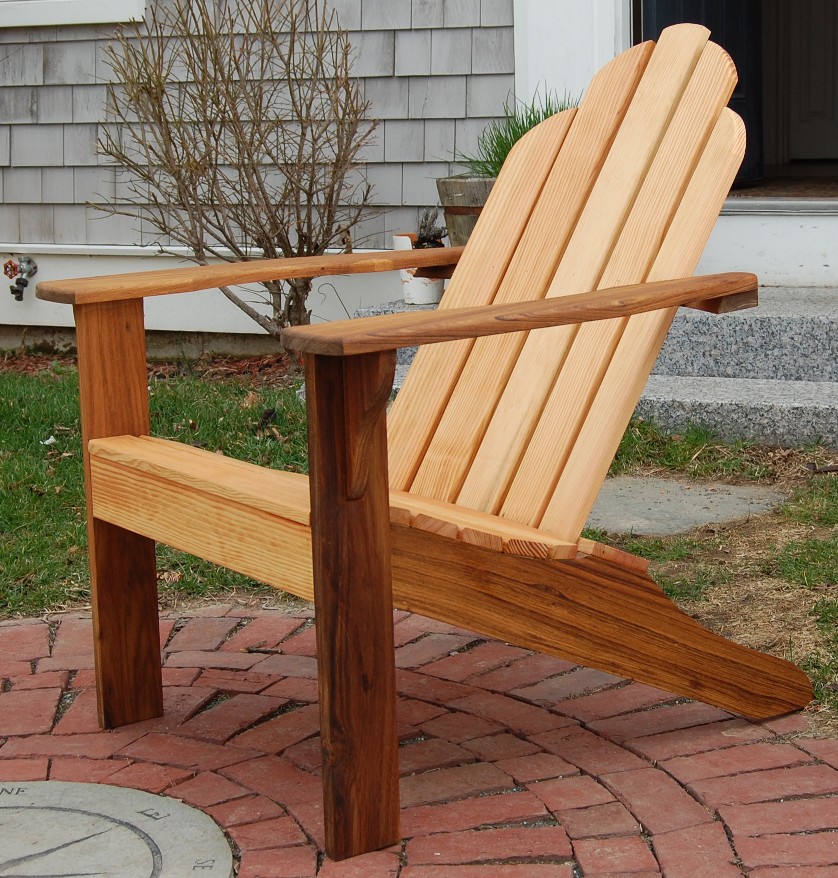

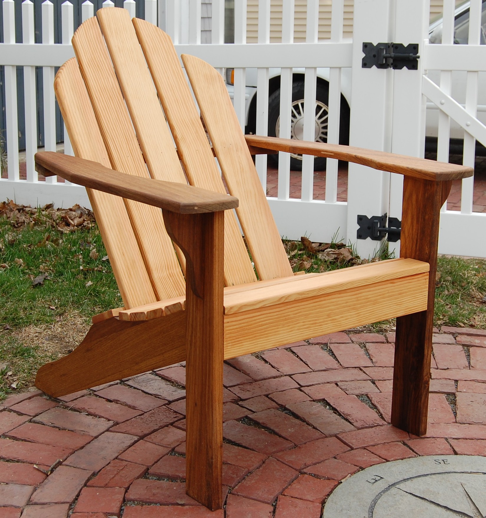

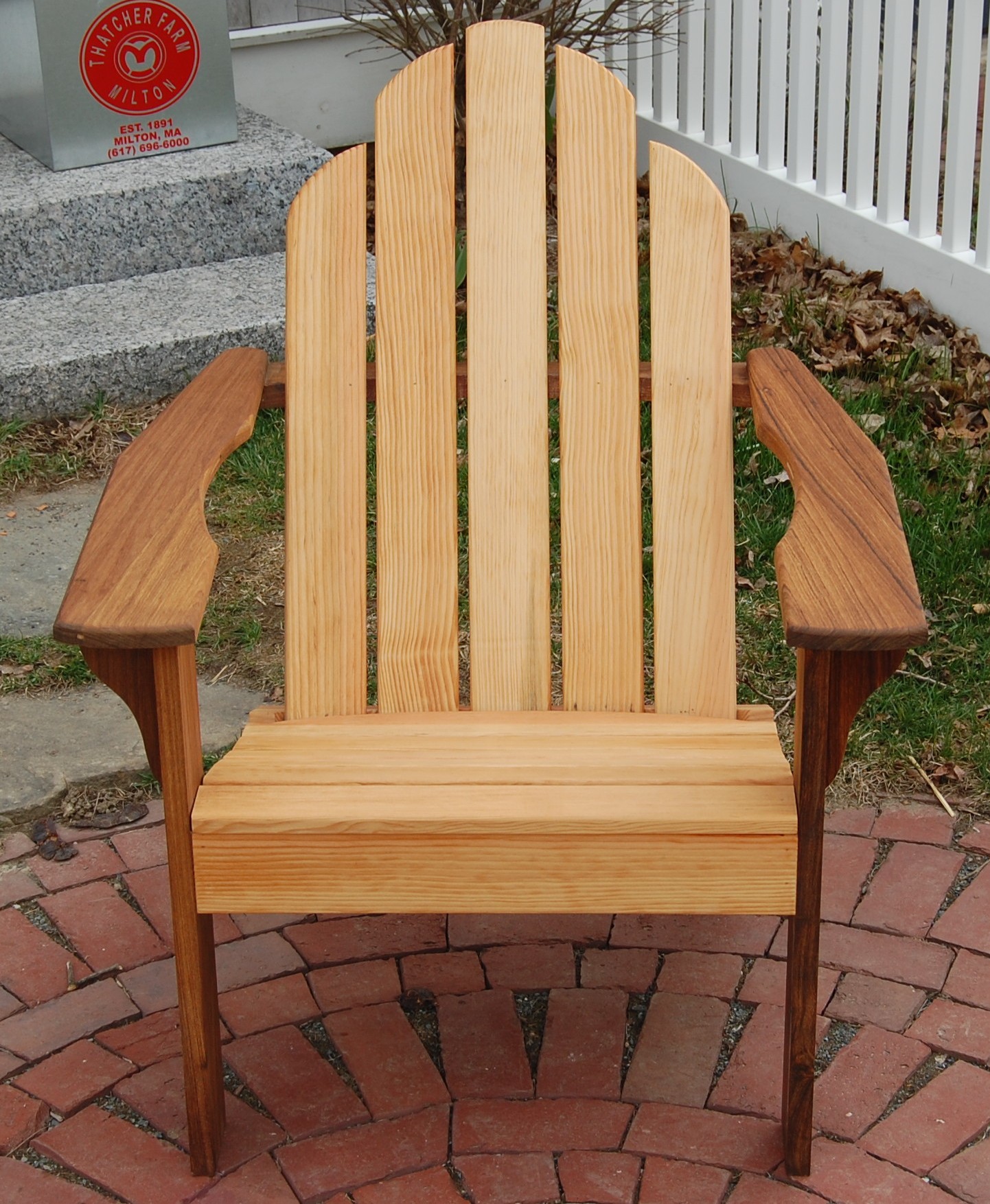

    I have wanted to build Adirondack chairs for a while....must have been Aug 05 since thats what my Popular Woodworking mag says. The cover says "Plans for Norms chair". I wanted it to be built to last - not like alot of the stuff thats commonly found. At one of my favorite lumber yards, they have had Friejo shorts on sale for over a year - I had no idea what this stuff was - then they put up an info sheet "brazilian hardwood, durable, teak substitute, used for boatbuilding". I couldnt resist. They also had DF shorts on sale. I created full size templates on the PC from the scaled drawings in the magazine and got them printed at a Signal Graphics for about $3. (If anyone wants a soft copy, I will send them for a nominal deposit to my wood fund :-). Norm used 3M 5200 adhesive and stainless hdw, plugged all the screw holes. I used epoxy (I build boats) and galv brads to let the epoxy set. It a bit messier but this thing will never come apart. Finished it will boiled linseed oil. Solid contruction, should last my lifetime with oil once or twice a year.
    My Friejo wasnt quite wide enough so I had to edge join the boards (epoxy). I placed the biscuits strategically so they wouldn't show, but I messed up and I think I hit nearly every one! It was also my first attempt matching grain. In some cases it worked out well, in others not so well. This chair is the better matched of the 2 I built. Cost me about an average of $2.50 bd/ft which is pretty good around here for this kind of wood.

        The oil brought the Friejo grain right out. It looks great in person. The DF came out a bit blotchy in places. I might try some wood conditioner before I oil it on the next one.
