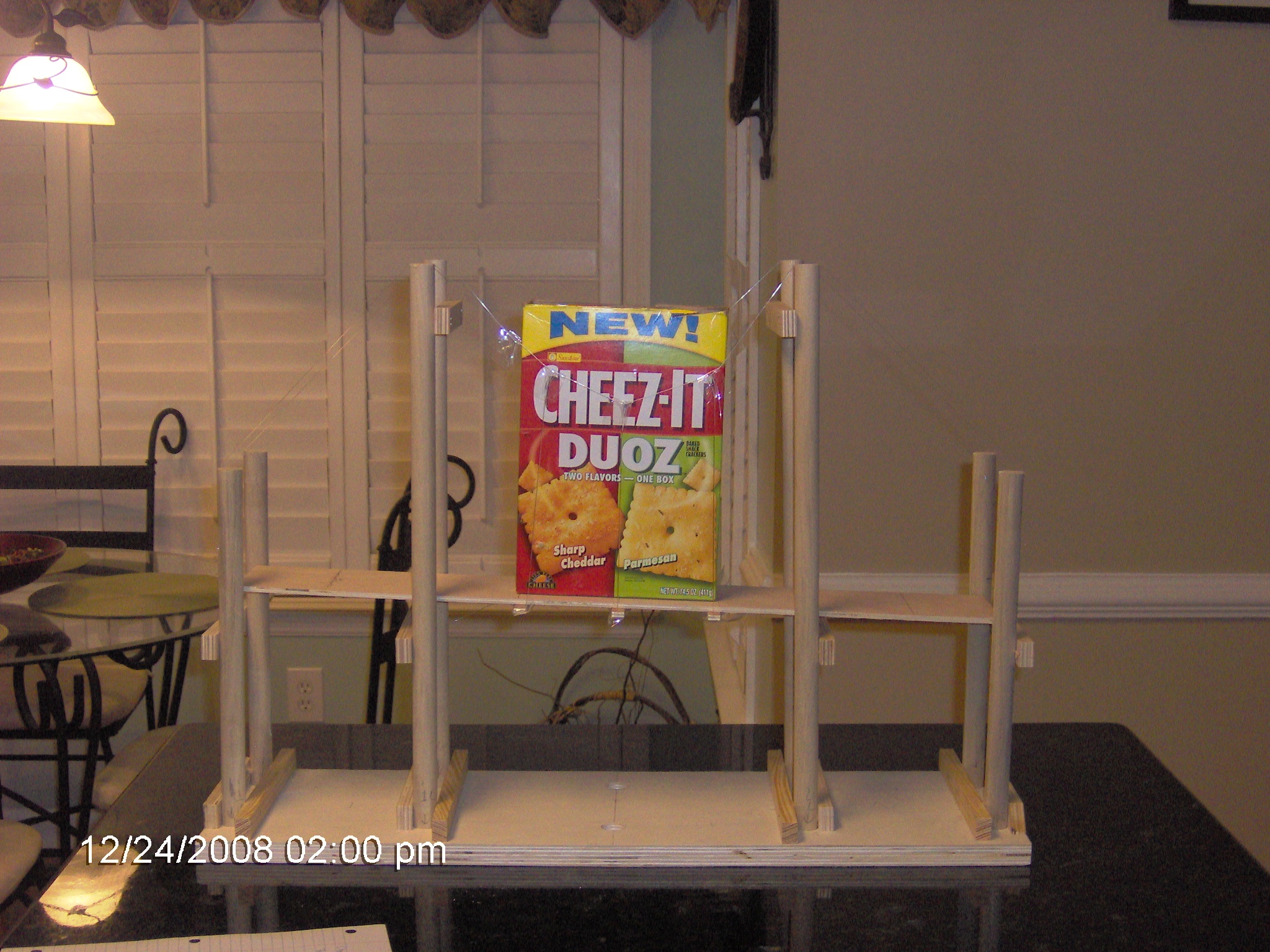

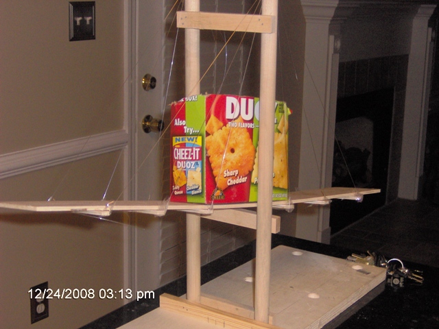

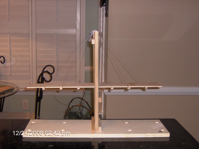

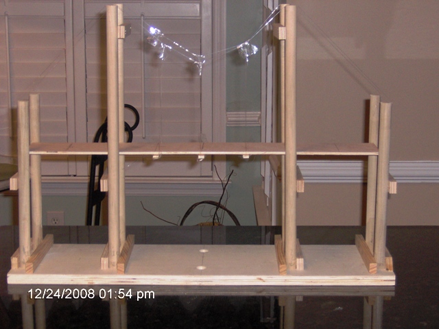

This is my sons eighth grade science project.He come up with the concept, I helped with the bridge design and construction.The concept was that a cable stayed bridge would handle more weight than a suspension bridge.The bridge is made from 1/4" ply and the "cables" are are 20 lb. test fishing line that is scotch taped to the to the "trusses" and the upper cable of the suspension bridge.We used pebbles added an ounce at the time until failure.The cable stayed bridge held 3 times the weight of the suspension bridge.I know it is not a perfect model but it was judged by engineers from a large gov,t facility and he finished third for the entire school.

I suggested the wooden materials considering the strength and weight, but the fishing line and tape were in his mind from the moment he ran it by me.That was really the most important factor.We had to have a weak point to keep stresses managable. I helped with the layout and ran the power tools but he did the assembly.

It was a cool experiment.The cable stayed in the top picture actually held enough weight that the ply sagged and you could hear the stress on the line and tape before it gave.
