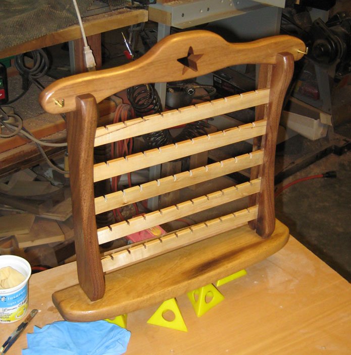

    I finished this one up just in time for V-day, made out of walnut and maple. The general idea came out of a plan I saw in a Berry Basket patterns CD. There's not a whole lot to it -- the trick is getting the horizontal rails to be perfectly spaced so that they're not crooked. A spacer stick, along with only gluing one rail at a time, helped with that. I crosscut the earring grooves on a wide board using a full kerf blade, and then ripped off thin pieces to keep the grooves consistent.
    Thanks for looking,
    --tlt
    Nicely done!
    BTW - I like those little pyramid thingys. Where'd you get those?
      Simole.. clean and functional. Looks really nice..

          Very Cool

            I'm thinking, 'Cat Toy" but then I bet you don't have any. Nice workmanship and selection of wood. Uncle Cracker has a point too he just needs multiple ear ring holders for his solution.

                Pyramid thingies
                Thanks for looking,
                --tlt
                JR,
                The pyramid 'thingies' are quite handy. I got mine at Woodcraft. I imagine Rockler and places like that will have something similar.
                Home Depot ot paint sotores might have themas well.
                Jerry
                Jerry

                    That turned out very nice and is a good looking design.The woods chosen really compliment each other.I am sure she loves it.
                      Thats pretty cool. How thick did you slice the ear ring strips? Did you finish with oil or some other clear finish?
                        That turned out real nice. Bet it was a hit on Valintines Day.

                              Nice work. Somebody was happy on Valentine's Day.
