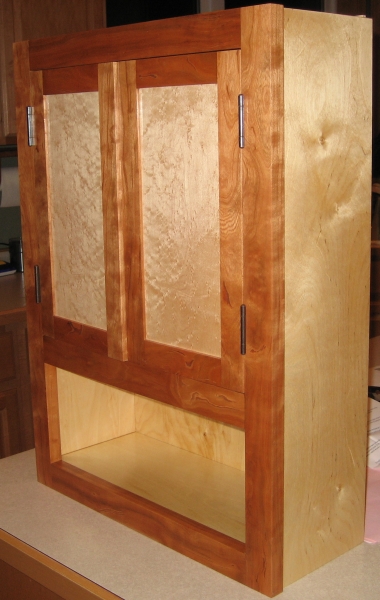

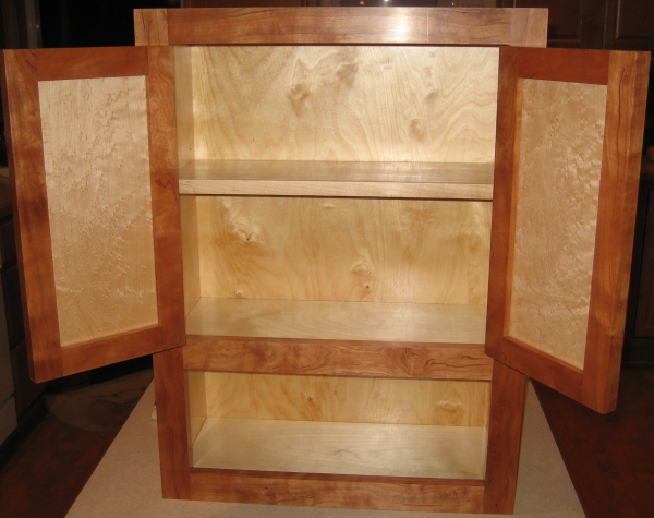

    Bathroom Cabinet
    Started this one a looooong time ago, and now that I'm back in the shop I had a chance to finish it up.
    The cherry face frame was my first experiment with pocket hole joinery -- have to say, it's pretty quick and easy. The doors are mortise & tenon, with 1/4" thick bird's eye maple panels, the carcass is baltic birch ply, and the finish is 3 - 4 coats of wipe-on poly. It measures about 18" wide, and 24" high.
    I haven't decided on knobs yet. I'm going to turn some cherry knobs and see how they look -- otherwise I'll buy some metal ones.

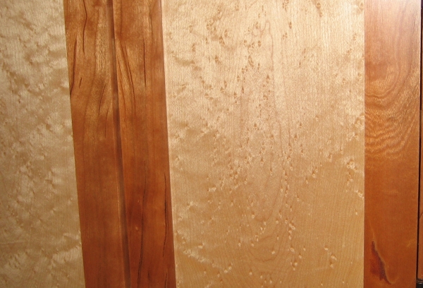

    Close up of bird's eye grain:

      Nice work. Inset doors, and all!

            i didnt think that baltic birch ply and maple would match once a finish was applied, but it looks good in the pics. do you notice any difference in real life standing there looking at both surfaces?

              Looks great, love the contrast between the Cherry and the Bird's eye!

                  It's difficult to tell from the angle, but did the right stile of the right door and the right stile of the face frame come from the same piece of stock? If so, did you plan that? Same question for the left stile of the left door and left stile of the face frame. Once again, for the right stile of the left door and the left stile of the right door. . .
                  I think it's a nice touch when people plan their projects so that grain patterns flow between and among pieces. It gives a more elegant look than simply having four random pieces (say, for a door frame) assembled.

                      BEAUTIFUL!!!!!! That birds eye maple makes that cabinet.

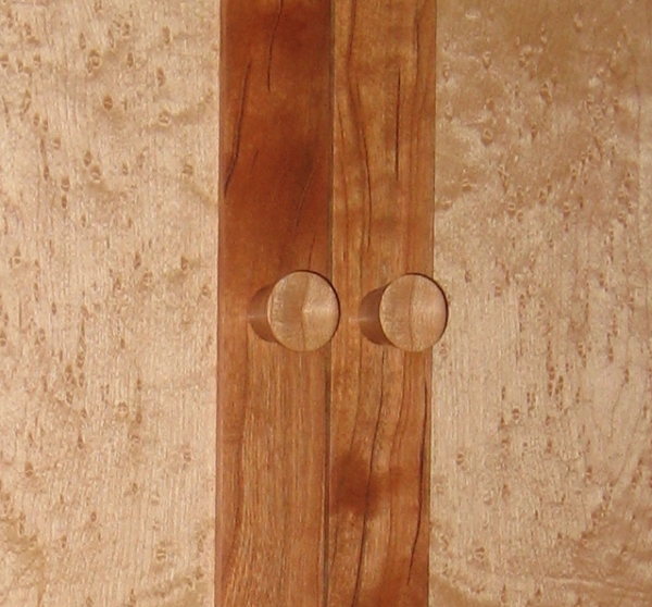

                            OK, now it's finished!
                            I finally installed it in it's place of honor -- above the cr@pper. Over the weekend I turned some knobs to see how they'd look (while kid #3 was busily sanding his pinewood derby car at the downdraft table) -- I think they'll do.

                            Close-up of knobs:

                            @footprints -- I wasn't too worried about BB and maple not matching too closely since the cherry face frame separates the two, but the grain of this piece of BB really does match pretty close like you said.

                            @Brian -- well, I could say that I intentionally matched the grain between rail and face frame, however, I'm always telling my kids not to lie...let me get back to you.
