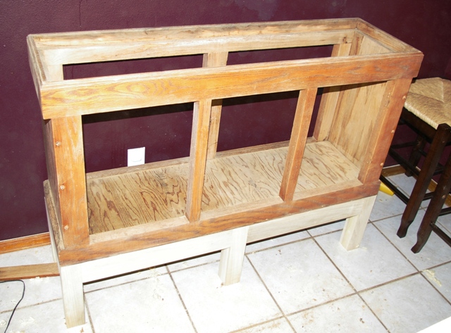

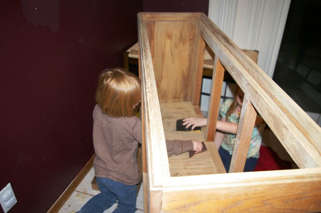

    We got this 55g Fish tank and wanted it to be counter height.
    The stand it came with was only 24" so we built a set of legs and bottom frame from poplar to get the job done.
    The tank waiting for a stand.

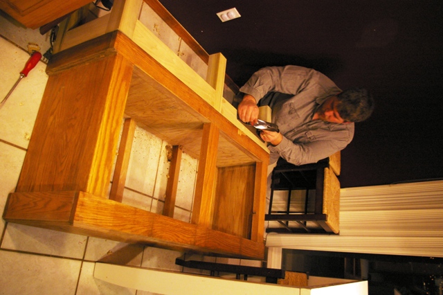

    Planing away, It's 32deg in the shop so I'm working in the dining room.
    On it's feet and standing 36" tall
    The girls get in on the sanding

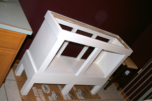

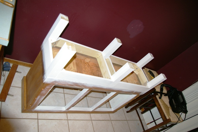

    Starting the primer
    All painted up and ready for a tank.

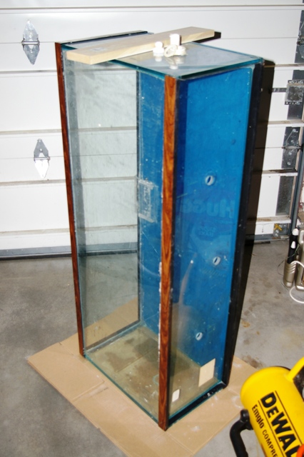

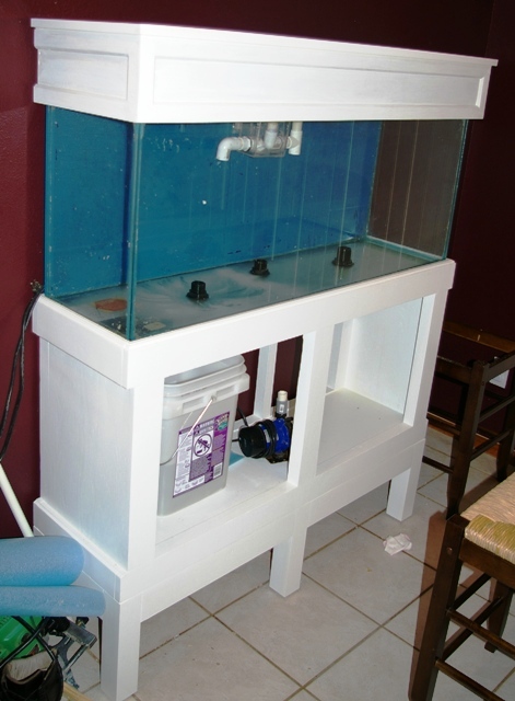

          Just noticed the holes in the bottom or top of tank. What are they for? If in the bottom is it for some kind of filtration system or are they in the top cover so you can remove it>
          • sscherin
            • 772
            • Kennewick, WA, USA.
            Fish 8 weeks after it gets wet.
            The holes in the bottom are for drain lines to the sump..
            I would prefer 2 larger holes but I gota work with what I have.
            It'll make more sense when I get all the plumbing done and post more pics..

                        Nice job. Looks incredibly strong, and I like how the paint ties the new construction to the existing construction.

                            The Paint
                            The finish is 2 coats Kilz 2 primer.. light 220 sanding, wipe down and then brushed on 2 coats Rustoleum oil based Semi-gloss white.. I did spend a few extra $$ for a good Purdy XL brush..

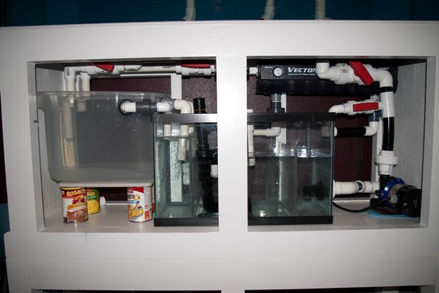

                              Hood is done..
                              Plumbing is done

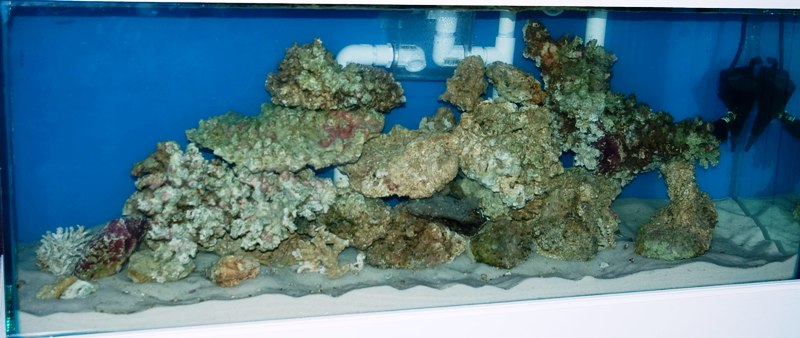

                              Rocks n water are in.
