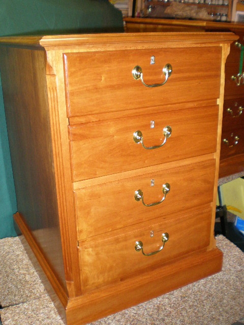

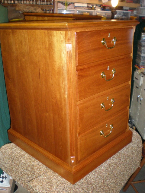

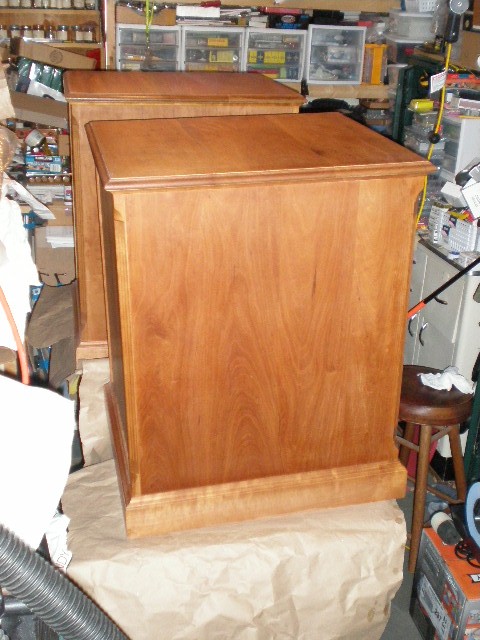

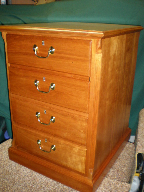

    Here are few pictures of a pair of solid cherry file cabinets I just finished. The cabinets were purchased many years ago as kits from the Bartley Collection by one of my mentors at work. He partially assembled the cabinets and asked me to complete them for his wife before he died of cancer this past year. I enjoyed completing the cabinets and I just delivered them to her.
    The drawers of the cabinets were glued up out of square. You can read more about the problem and how I fixed it here.
    http://bt3central.com/showthread.php?t=39834
    The cabinets were sanded to 220 grit. A washcoat of Shellac (50% Alcohol - 50% Zisner's Sealcoat, a wax free shellac) was applied to prevent splotching / blotching (I can never remember the correct term.). Two Bartley gel stains were used to blend the sapwood into the heartwood. A few more coats of shellac were then applied. 0000 steel wool and 360 wet dry paper was used in between coats. This was the first time I had used shellac and I struggled to get a good result (I think I applied too many coats). I ended up applying several top coats of Minwax Antique Oil finish which I love, but can't find any more.

            ... what effect did the shellac produce to conclude you used used too many coats?
            The basic problem was that I couldn't get the shellac to level out and produce a nice smoth finish on top. I think my mistake was in not sanding between the first few coats and allowing enough time for the shellac to fully harden. I tried added more coats of shellac to solve the problem and the shellac got thicker but not much smoother. After I realized my mistake I tried sanding and using steel wool and my results improved. I simply ran out of time for a shellac only finish and the Minwax Antique Oil quickly evened out the finish and achieved the end result I was looking for. The shellac finish looks beautiful by itself. The photos of the cabinets without the drawers are shellac only (maybe with only one or two coats) without any antique oil.
            I also had a problem with the shellac not drying in places. I concluded I had applied too much shellac (or I had re-applied it too quickly) because I had a goody mess that wouldn't dry in some places. I solved the problem by removing most of the shellac in the gooy spots and then adding more to blend in.. That's when I could really see how much shellac I had applied.
            Everything I have read on using shellac wash-coats suggests applying a single coat before stain is applied. I am not sure stain would penetrate the wood if more than one wash coast were used. By the way the shellac does a beautiful job of preventing the splotching / blotching of both stains and oil finishes. I was amazed by the improved appearance of the finish I achieved in my test results by applying the Antique Oil over a washcoat without any stain (as opposed to applying oil on bbare wood). I only applied stain where I had sap wood. I tested 6-8 different Bartley Gel Stains and found that "Country Maple" followed by "Warm Cherry" blended well with the heartwood.
