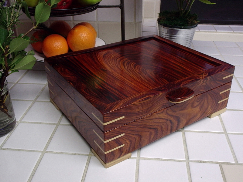

    Wll, not exactly finished. Another coat or two of poly before the recipient gets to keep it.
    Bubinga humidor with maple trim. My first time bookmatching.

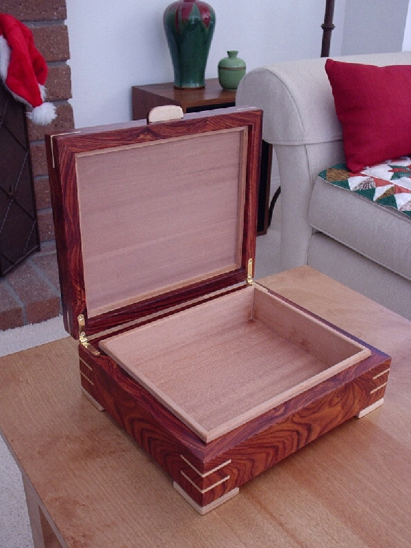

    Here's the open view, as promised.

    Looks terrific!!!
    • shoottx
      • May 2008
      • 1240
      • Plano, Texas
      Very Cool
      Wonderful color and detail!
        JR, that is a polished show stopper. The recipient will be very satisfied!
          Beautiful, simply beautiful!

            That is amazing, John - well done!

              Nice work. The joinery really sets it off.

                Very nice. Really like that bubinga.

                  Very nicely done. Love the contrasting splines. Inside pictures??

                    You did an excellent job with book-match and for that matter... the whole thing. I had to click on the picture to enlarge to get a good look at the match. Is there any possibility you can get a picture open as I am considering doing a small box which is not my forte soon. Any pictures helps a dummy as I.

                      Thanks for the nice comments, guys.
                      Originally posted by ragswl4
                      Inside pictures??
                      Is there any possibility you can get a picture open ...
                      Well, there lies the rub. I have built the inside, but not installed it yet. I'm trying to get the finish done first. The inside is made of 1/4" mahogony, which is slip-fit inside the box. The texts all suggest spanish cedar for this application, but there didn't seem to be any in my scrap bin.
                      Sarge, if you'd like a tip, and from one miter-challenged woodworker to another - get your miter act together before trying to make a box. I got hung up for a week trying to make my miter saw do the deed for me. Once I moved over the table saw things went much faster. I used the SMT on my BT3K, but a miter sled would be the prefered option.
                      I'll post the final pics in a day or two.

                          Added pic to the original post.

                            Looks great JR.

                              JR,
                              That is drop dead gorgeous. What kind of meter and humidifier are you going to use?
