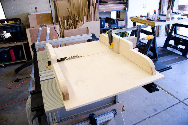

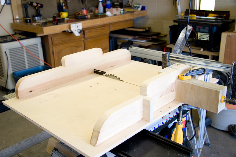

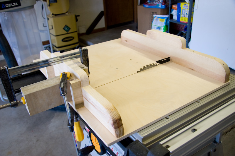

    I have been meaning to make one of these for a while and as my next major project is a dining room suite I thought it was about time I had something to make perfect cross cuts.
    Its not quite finished but I thought I would take a few pics as I have just glued up and clamped the blade exit guard.
    I am still considering what to do about a blade guard. If I dont make one now I will be tempted to just use it without. I guess lexan Poly. would be the best bet.

      Look nice! what runners or guides are you going to use?
        There are 2 3/8 thick runners made from walnut. they fit pretty tight but with some wax and wear they should smooth out nicely.
        I was a little concerned about only have the dual slot miters so decided to put runners in both slots. Even though they are both on the same side of the blade it slides true and there is zero slop.

              The base is made from a piece of baltic birch that has been lying around for a while. The fences are made from 1 1/4 pine that has been sitting in the scrap box for at least a year. I probably should have used something harder for the fences but as they have been in the shop for so long and that means at least 2 Arizona summers, they are about as stable as they will ever get.

                  I am sure you are right. I was getting sick and tired of cross cuts on the SMT or my CMS that were hit and miss if I would get them perfectly square.
                  The other advantage of the sled is the inherent zero clearance. I did a few test cuts before I began to apply some finish and there was virtually no tearout on the back side. I even tried it with a piece of low grade ply and even this had a near perfect crisp edge on the bottom.

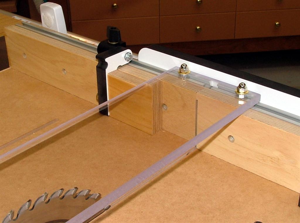

                      Ignoring safety, i find a guard nice to have as it keeps the sawdust from spraying up at me. I attached it with a couple of knobs to make it easy to remove because i was worried it would be a real pain, but i've only had to remove it a couple of times. I used lexan from Lowes, and since it was thin and drooped, i attached about 3/4" sides using super glue. Just be careful with the super glue on the lexan though, as it will make a mess of it.

                            Originally posted by thrytis
                            Ignoring safety, i find a guard nice to have as it keeps the sawdust from spraying up at me...
                            Yup - 10mm Lexan:
