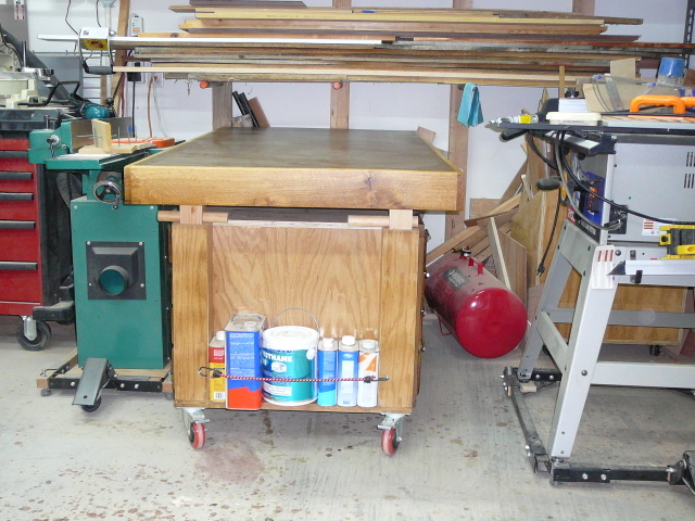

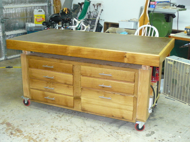

    I've finally finished my new shop assembly table, after about 4 months of on/off project time. It's based on Gary's workbench (http://www.bt3central.com/showthread.php?t=30759) but mine is more of just an assembly table with storage.
ID:	792923 Click image for larger version
    It's made of quarter-sawn white oak and MDF-Lite. The top is a torsion box using 3/4 MDF lite for the skin and 1/2" MDF lite for the grid. Finish for the trim is BLO, followed by a coat of wax-free shellac. I finished up the base cabinet with a few coats of Resisthane, sprayed on with my HF HPLV sprayer.
    The one addition I made was because the top is VERY heavy. I had originally planned on installing a central post to lift the top, but it ended up not working out. Instead, I put in a air-powered jack on one end. It's a little cumbersome, but I can lift one end and control the jack for the other size to change the height.
ID:	792922 Click image for larger version
    Overall, I'm very happy with how it turned out. The project had quite a few firsts for me: building drawers, resawing oak for the drawer fronts, creating a torsion box, and working with q-sawn oak. I need to spend some time rethinking how I mounted the fronts to the drawers. I thought it would be better to mount the drawer and then attach the front in place to adjust for any irregularities. Unfortunately, that didn't work as well as I hoped so I need to consider a different approach.

          that looks real nice. just by looking at the size i was starting to wonder how you were going to raise the top, but i see you have taken care of that with a air lift -- i like that idea. looks great!

              Very nice - I like it. How fast does the air-jack raise that end of the table? Is it controllable?

                          Air lift... doh!! I wonder if you could use pneumatic cylinders to do the lifting rather than a jack. You would need a compressor that would support the effort needed to lift the top. A hydraulic pump and two cylinders would work but it's a lot more hardware. I think that you have the better idea, Ken! Nice work.

                            Thanks for all the kind words. So far, I'm very happy with how it turned out. I actually used the table top when making the drawers and it was SO much nicer than my old setup.
                            Gary: the air jack takes about 30 seconds to raise the 6 inches to the next peg stop. It comes with an inline valve which lets me start/stop the jack from the other side of the table. Actually, letting it down is the tricky part. I have to start the air and then open the release valve slightly so the air in/out is balanced. I then go to the other end and turn off the incoming air, which lets it slowly drop back down.
