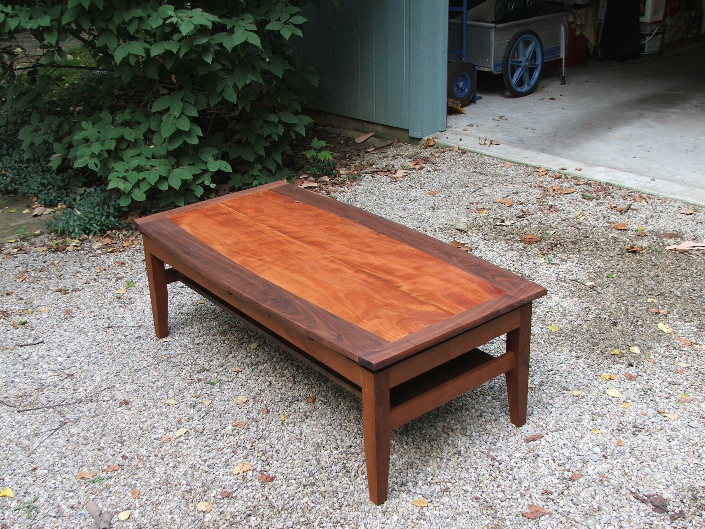

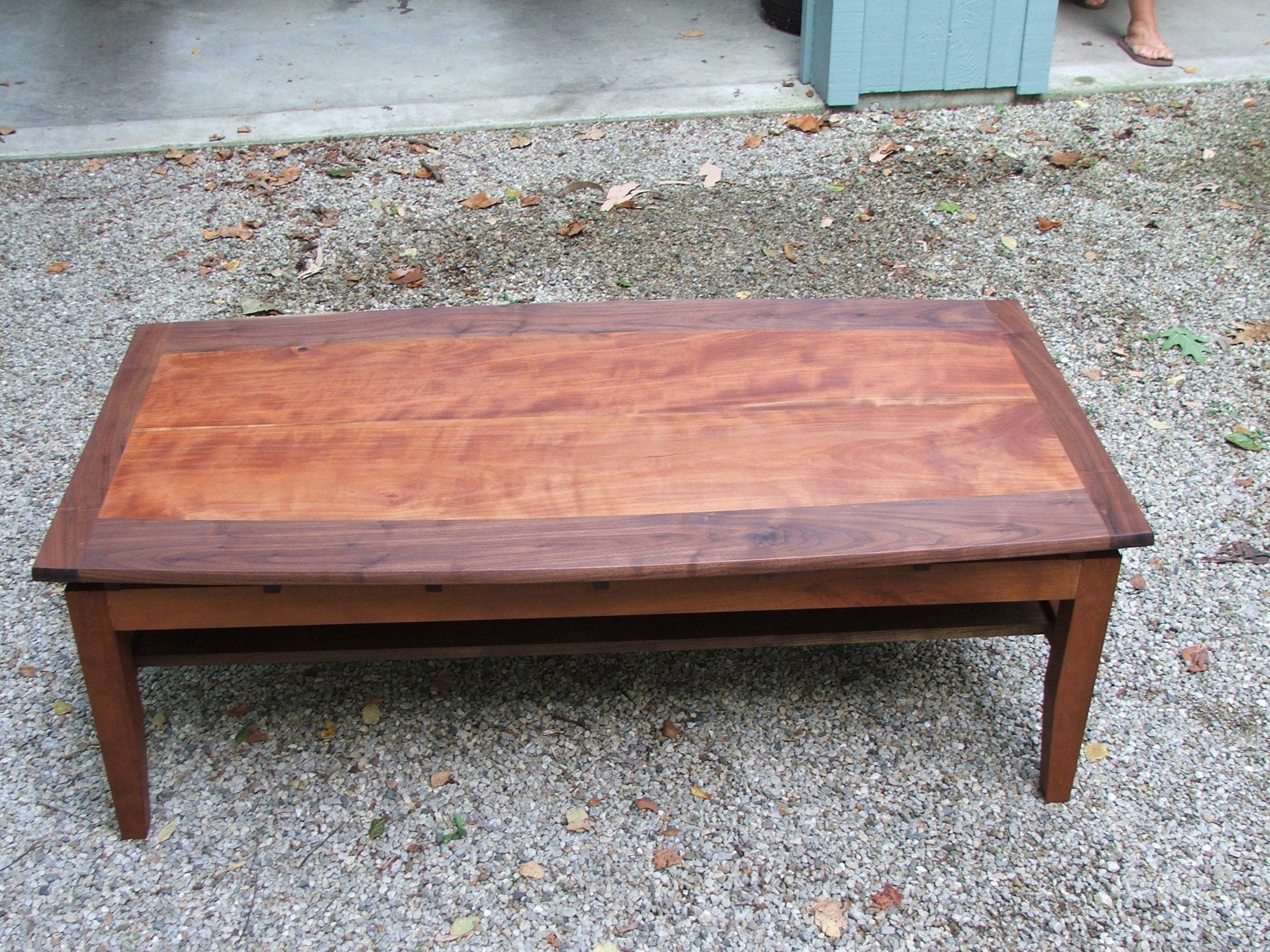

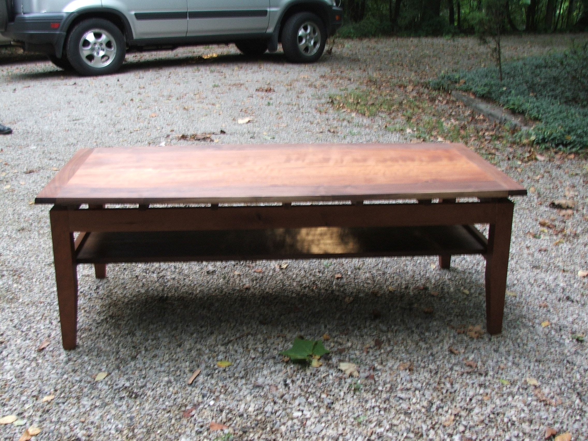

    My third project is almost finished, and as there haven't been many projects posted lately, I thought of putting this up. The table main components are cherry, with some walnut thrown in. The lower shelf, the brackets under the top keeping it off the skirt, and the trim around the center cherry section in the top are all walnut. The table top ends are breadboards, pinned on with a center fixed dowel and two dowels on the ends in enlarged holes in the top. The frame (carcass) is all mortise and tenon, and the lower shelf is also basically extended mortise and tenon. The slight curve on the long edges of the top are also mirrored in the walnut edging. This required the use of several templates and two different router bushing guides and trim bits to get complementary curves before glue up. I have rubbed in boiled linseed oil to give the finish a little warmth and depth (no dyes or stains) before finishing with an alkyd varnish (not applied yet).
    That's a truly sharp looking table. The curves really make it.
      That's a thing of beauty!
        very nice indeed. I like the shape of the table top.
          very nice indeed. The color contrast on the top really catches the eye.
            Nice work. The top came out great.

              Beautiful table. Nice contrasts and joint work.

                Elegant. The "floating" top works really well in this design.

                  Great choice of timbers and a very nice result!

                    That's really a killer design. Beautiful workmanship. Pat

                      Can't add anything to that. A beautiful piece.

                        That is really a super nifty piece of work. If you can, please explain the breadboarding you did, it sounds somewhat different to the technique I'm used to.
                        I really admire that table.

                          Very nice.
                            Very nice, Machine. I like the "floating top" and you were wise to set the dowels up in the bread-board as you did allowing for the expansion that will most likely rear it's head.

                              A beautiful design and very nicely executed! About all I do to wood is execute it - LOL!!
