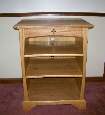

    Another of my simple designs in an attempt to match the bed and 6 drawer chest I made for my wife. This is the simple piece of the puzzle that will also include a chest on chest. But.. simple in execution does not always relate to simple in design and can lead to frustration.
    The design is straight-forward but I became frustrated with the concept of making a modern, small TV blend with the over-all concept. I had to grit my teeth before forcing myself to cut holes in the rear dust shield to allow electrical cords to pass through. That goes against my grain as I suppose I am some-what "old-school". How do you make a TV blend into the picture... you don't IMO and compromise.
    So.. another domestic harmony decision was made and I cut the holes as my lovely insisted. So... what you see is what you get. The good news is you don't see them from most normal angles. The bad news is they are there and I know they are there.

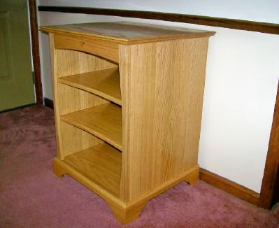

    Another of my Southern Cross inspired creations from local wood and Hazard County, Georgia (home of the Duke's which includes Daisy) inspiration. Solid wood.. all joints with exception of 6 screws for top fastening.. Mortises are machine cut with tenons hand sawed. Secret mitered DT's (which can't be seen) on mitered base corners.
    In other words.. more "junk" from me to blend with my other "junk". My ability with a camera and lighting distorts reality somewhat... but I have accepted that as just the way it is... with my camera and my knowledge of how to use it.
    Now.. I can go build some more "junk".

    Sarge, I only have criticism for you : you think too much, you brood too much and you criticize too much !
    That is one fine piece of furniture, and nothing you say can convince me otherwise. It's simple, and it's utilitarian, and it looks great. What more do you want?
    Hand cut Tenons, mitered DTs... wow! My 'high class' output would not come close to what you call 'junk'. So please don't do that... !
    Btw - how'd you finish it?
    And, how are the shelves sitting? On pins or dados?

      I don't think your camera skills are at all lacking and the piece is clean, functional and obviously well constructed. Most of us are having to bite the bullet due to electronics.
        That's a very nice piece, Sarge. Don't change a thing.
          Nice work Sarge. I like the curves. And mitered, hidden dovetails? Oo la la!

            Thanks for looking and the kind words.. Rad.. Mike.. Uncle Crack.. and JR.
            Rad... just my nature to affectionately call my work "junk" as it is usuallu done with other than the more valued domestics and exoctics. And I am a bit fussy with execution which is also just my nature.
            The shelves are in dadoes.. but not permanently attached. I used to cut dadoes with a router after I sold my dado set. But I used a double pass with a Freud 3/8" box cutter set as it leaves the cleanest cut on the sides and bottom I have ever seen. No clean-up what-so-ever.
            And the shelves can be removed as they will slide in and out by removing the rear dust shield. They lend no support to the sides as that was already provided.. allow expansion from front to rear of the side panels.. and can be removed if you just need one shelf on no additional shelves in future considerations of what you want to use that space for.
            JR.. glad you also like "Daisy". Life in Hazard Couinty (a fictious county made up for the show) just hasn't been the same since she left for Hollywood, Ca. Fortunately my younger wife fills the role very well and the chest of drawers was especially designed to hold a lot of "Daisy Duke" shorts and tops for this very hot summer weather we're having early here in Georgia.
            Gotta run guys as I have to drive my wife to an appointment in Atlanta. No shop time until to-nite as I goofed off yesterday with some shop improvements and modifications until tomorrow when the search for lumber begins it's vicious cycle again. That's a big southern, "H*ll Yeah"..
            Opps.. edit to include I used poly over a coat of cured Danish oil. I am normally a shellac man but poly got the call here as the TV gets shifted on top often and I felt a more durable to scratches finish would be better suited in this case. Normally I keep poly to a kitchen and bathroom use only.

              Some people's "Junk" are others aspirations... nice work!
              Do you have a mouse problem? I noticed these little holes in the back.
              I’ve been thinking about a cabinet design for my AV equipment. One thing I hate is all the cables hanging out the back. I’m considering doing a removable false back a couple inches behind the actual back/shear panel with the holes. The holes wouldn’t show through, especially when light is reflected from the wall behind and the cables would be neatly concealed.

                sarge! that is one beautiful piece of furniture. turely a creative design. i love those curves. very nice. i would be more than happy and feel honored to take that "junk" off your hands.

                  That's some pretty good lookin junk there Sarge. I especially like the junky curved stiles on the face frame, turns a simple junky design into a unique junky design. Keep up the junky work Sarge, it gives the rest of us junk to aspire to. Pat
                  P.S. lighten up on yourself.
                    Sarge,
                    I like that piece a lot. Nicely executed. The curves on the face frame trick the eye into thinking the sides are actually curved. I would not worry about the holes in the dust shield - how else would you get cords in there from behind? Besides once stuff is put on those shelves you won't see them.

                        Thanks pelligrini.. Omar.. Crockett.. and Doug..
                        And special thanks to Crockett for the description of exactly what I was attempting to do with the curved front which is give the effect of curved sides. They were cut as normal with the aid of a symetrical bow.. a band-saw and a template with pattern cutting bit.
                        But then I went high tech and pulled out the spoke-shave to take the normal curve to another dimention by trusting your eye to take a little here and a little there. Amazing how a simple tool can add a touch of pi-zazz to an otherwise simple box. The back lip of the side panels have a reliev curve also but it is so suttle you would not recognize it in a picture.
                        I always wanted to be a "junk-man". I had a "junk-yard dog" as a kid but the right opporturnity just never presented itself. But now I have my chance to be the "junkman" I always wanted to be. Not a fireman.. not a police-man nor a doctor. A genuine "junkman" that takes pride in his "junk".

                          I like the colors!!! Almost a mission style too
                          Enco 12" RT table saw(with router table currently added to right wing), Central Machinary 6" jointer, Delta 16" (17-900) drill press, Ridgid 14" bandsaw, Jet bench top Mortising machine, Porter Cable 6901 series routers (2) and a wide variety of Ryobi 18v tools.
                            I have to agree with you, Sarge. Total junk, from what I see in those photos. The face rails and that apron aren't even cut straight! Obvious to me that you are either lacking in skills or there was something major amiss in your set up at the time. And those horrid holes in the back...What were you thinking, Man?
                            Top save you the embarassment of having to admit to your friend and relatives that you concocted this pile of sawdust, ship it to me IMMEDIATELY for disposal. Just to show what a great guy I am, I will even pay the freight!
                            Or, better stated, that is a beautiful piece!!!!!!!
                              The little details you added REALLY made the piece.
