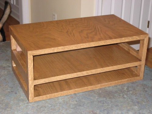

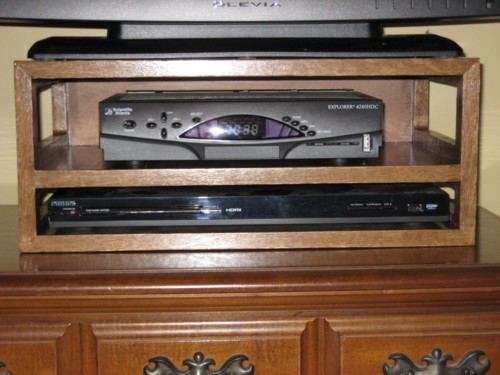

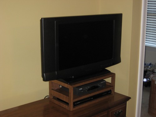

    We needed a TV stand for the bedroom to go on the dresser. It is made of oak plywood with lock miter joints and the middle shelf is in a dado. I used oak veneer to cover the exposed plywood edges and used a walnut stain. I left the extra space above the cable box for the heat from the cable box. I am fairly happy with the results.

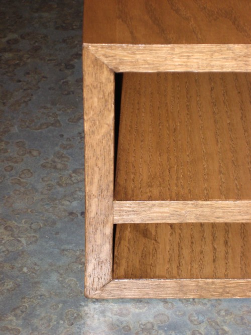

            nice and simple! like the clean miters.

                  Luckbox,
                  How did you like using a lock miter bit on the plywood? I've only used it on hardwoods and softwoods.

                        When I had the plywood up on edge there was quite a bit of splitering. I did 4 passes to get the final depth and made a push block with backer to minimize as much as possible. The worst splitering ended up being on the upper edge which is not really visible once I put it together. With the work piece flat on the table the locking miter worked pefect, no splinntering at all.

                          Nice work indeed. I also wondered about the lock mitre on plywood. Not something I would have thought of doing.

                              Great design, especially for ventilation. I like your choice in coloration.
