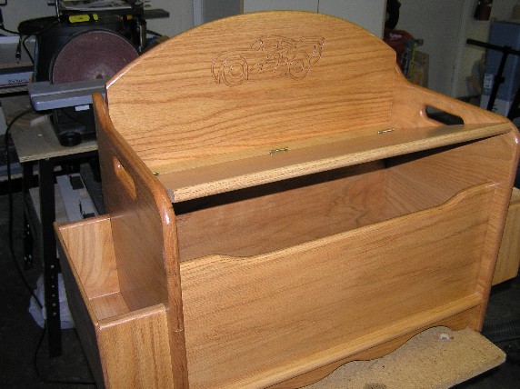

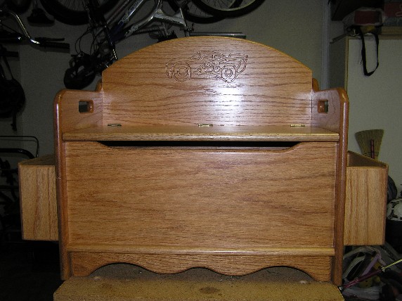

    I can finally turn this one over to my 17month-old son.
    Thanks to all who helped with recommendations on sanding the details of my routed work - I ended up using the sanding sticks from Woodcraft, and they worked great. My approach to this piece was a combination of contemporary (clean geometry, current routed graphic) meets Amish (no pinch lid, simple design details).

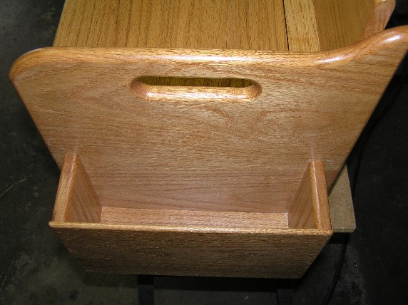

    Book holders on the sides were requested by LOML. I thought about being more creative with tapering their shape, having the top opening larger than the bottom, but need for volume (function) won out over art (form).

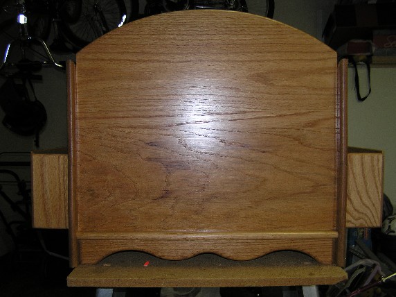

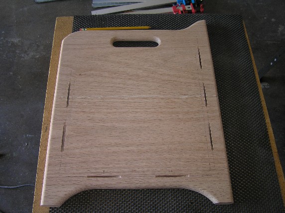

    Solid red oak; sides and back plate-joined for height; construction of front & read to sides done with biscuit joiner. Should be heavy enough that my rough-and-tumbly boy won't be able to move it.

      That looks awesome...excellent work. I like the book ends touch.
      Did you hand route Lightening McQueen on there? It looks very good.

        i love the routed car. where did you get that from? did you buy the template, if so from where?

          Maybe I missed it in your earlier post, but how did you go about routing Lightening McQueen? Did you make a pattern yourself and then just freehand it?

                I also like the gap between the lid & the front panel. It provides some room for little fingers so they don't get pinched. I assume you also have some hardware to hold the lid up in position as well?

                  Love the inovations like the book holder. You should submit this to a woodworking mag!~

                          About the McQueen - that was a last minute choice, based on my son's addiction to the movie. My wife and I discussed a sports theme (we're both huge football and hockey fans), but I found a picture of Lightning on the internet, which when fit-to-print on my printer ended up being just the right size to use as a "template"; I just taped in on the wood, cut through to score in the outlines with my Exacto, and used my Dremel/router to "freehand" along the scoring, which is evident by the less graceful curves in places.
                          The only hardware is the small brass hinges, mortised. The "up" position of the lid in one photo was accomplished by placing a thin stick in the underside gap when I lifted the lid; it held when I let go take the picture.
