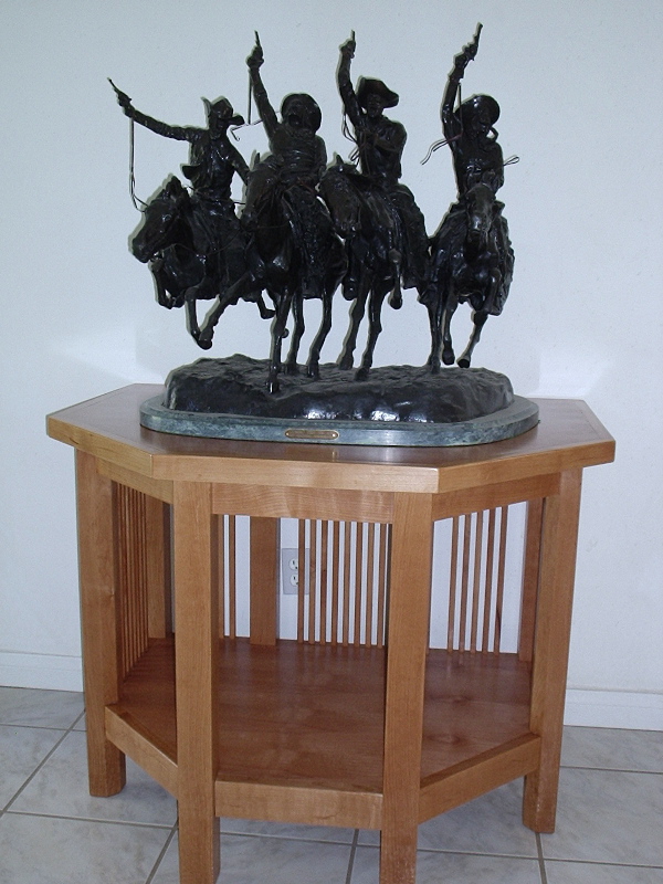

    Just a quick snapshot as i move this out of my shop.

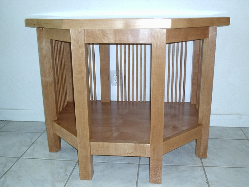

    The table was made specifically to hold this Remington Bronze. The design is mine, an effort which thoroughly bent my brain. I had in mind a crafstman look, imagining it would be consistent with the late-18th century theme of the statue.
    It's made of alder, alder ply, and incredibly even to me, alder veneer on the underside of the two-layer plywood top. The legs are about 2-5/16" thick, milled from 12/4 stock. The 34 spindles are 1/2" x 1/2". The stretchers are about 1" x 3", milled from 5/4 stock. The piece is about 34"D x 42"W x 31"H.

    I remember you asking questions about how to assemble this a few weeks (months?) ago.
    It turned out very well.
      Very nice, JR... I beat those angles that you threw in the design is what bent your mind. You did a great job with them and the spindles. Looks like something you should sit a Rememington Bronze on.
      I would probably just make it square and sit a Remington 870 Wingmaster on it and call it a day...
      Regards...
        That looks great. What did you use for joinery?

          Outstanding work and a compliment to the art sitting on it!

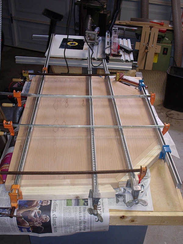

            Yeah, gluing the frame was an interesting exercise. I didn't get any pics, but it should be unerstood that I did it in stages, rather than in one go. Here is a pic of the top coming together. Note the cauls on the angles, which are notched to provide a landing place for the clamps.
            It's all M&T, including the spindles. The spreaders are let into 1/2" mortises, the spindles into 1/4". I used my HF mortising machine, which went smoothly enough. The only trick was mortising on the 45s. I made a simple jig/false table out of a 2x6, by cutting a groove down the middle with the TS set to 45 degrees.
            Edit: Actually "all M&T" is not quite accurate. The trim on the top is attached with a double row of biscuits. I'm as self-critical as the next woodworker (with good reason!), but the top came out nicely. I was able to cut the angles at 22 degrees or 23 degrees, as necessary to get a very good fit all around.

              That's beautiful. Nice job!
              Rand
                Very nice work. It looks good.
                  Very nice!

                    That is great work, JR! Looks beautiful.
                    Claudio
                      GREAT JOB; Very nice and I love the design!
                        The table and the bronze piece compliment each other nicely. That's a job to be proud of.

                          That looks great.
                          I love Remington's work.

                            looks superb also really like the bronze on top
                            where did you get it (if you don't mind me asking)

                              You made Remmington proud!!!
