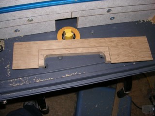

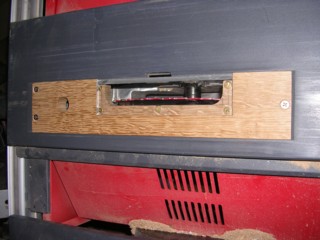

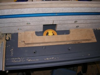

    More of a jig than a project but here goes...
    I got tired of making my own throat plates for all the different sizes of dados and rabbets I need to do. I have a couple t-nuts plates but those are too expensive to burn through with my dado set. I saw Norm using some kind of throat plate with an insert and that sparked my interest. Since there did not seem to be any commercial means to acquire one, I made my own today. I can make a lot of the insert pieces in the time it takes to make one ZCTP.
    If am sure one of you has already done something like this but here is my version. So far it works great.
    Parts:
    • 3/4" QSWO scrap blank
    • 5 - 6/32 threaded brass inserts
    • 5 - 6/32-1/2" brass machine screws
    • 1/4" lexan scrap. leftover from my last ZCTP
  • eccentrictinkerer

        Your router fence
        In examining your photos it looks like your router fence is like one featured a couple of years ago in Wood Magainzine. Am I right? How do you like it? Is it hooked to your table saw fence? More photos please.....

          Thanks. I used the metal dado insert as a guide for the large cutout, added 1/2" for the 1/4" inset and squared up the corners. I haven't put any finish on it yet but I am thinking just some wax is probably best.
          pacwind3,
          You are correct. I found it in a backissue of Wood magazine several months back. I just clamp it to my rip fence when ever I need to use it. IMHO, it is a really good design as is. I built it right from the plan. If I remember correctly, I posted some questions about it when I was building it. Several forum memebers posted pics of thier versions too. That may help you out.
