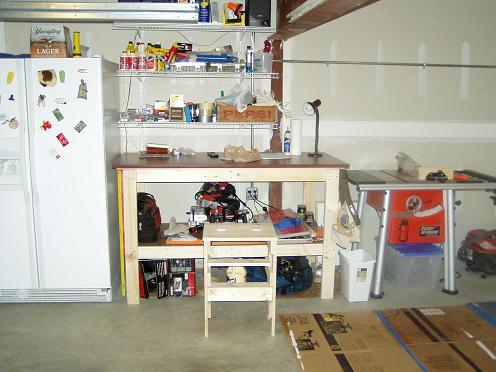

    To build anything of value, including a good workbench, you need...you guessed it...a workbench. So, to prepare for my dream workbench with full slideout drawers and a hutch above it, I built a lower end workbench that should get me through the hump. My primary goals were:
    * Cheap
    * Easy
    * Somewhat portable - it may move around in the garage
    * Hold most of the tools in one place instead of scattered around
    * Good enough to use, crappy enough that I will still be motivated to build the better workbench!
    I had one other additional criteria. My wife ordered some BeStar desks for her office and the tops were damaged. BeStar sent new desktops and told her to keep the old ones. Jackpot! I have a 66"x29.5" and 66"x20" desktop, a full inch thick with laminated tops, bottoms, and sides. They're made of some sort of manufactured board, either MDF or a high density particle board - I would guess particle based on the weight, with the lamination it doesn't matter that much either way.
    I chose to use the deeper top. My plan called for a 39"Hx25"Dx60"W bottom, a slightly undersized 1/2" plywood top, the desktop on top of that, and a shelf made of hardboard approx 16" off the floor. The bottom is made entirely of cheap framing 2x4's cut to size. The shelves are simple square boxes with a middle crossbeam to support the shelf. The legs are 2x4's drilled into the front and back of the shelves. The hardboard was cut to fit the lower shelf and screwed in. The plywood top was screwed down into the top shelf and then I screwed up into the desktop.
    When it was done, it weighed less than I feared and it held more than I anticipated. As you can see from the photo, I have some more work to do in replacing the shelves that are about 6" above the surface, but that's for another weekend.
    Total cost: $60 plus some 2" and 1.5" drywall screws I already had and wood glue; desktop was free
    Time: approx. 10 hours split across two days.
    Tools used: Various drills, circular saw, table saw, belt sander, sandpaper.
    Full sized - https://ronelson.dynip.com:8443/wiki...ersion_1.0.jpg
    It accomplished all the goals. Cheap and easy were, ahem, easy. It's fairly light so aside from the horrible sound of the legs sliding across concrete, it can be moved without much effort. It holds all my tools except the table saw (duh!) and there's a lot of room for improvement, so I'm not going to sit on my laurels and deal with it forever.
    My only complaint is that when I screwed the 2x4's together for the shelving, I didn't think about the aesthetics of the final look. I had to screw the legs on in an ugly pattern (further uglified by screwing up the top-left leg you can see on the full sized link) and in spite of this being a "throw away" item, I wish I had taken a bit more care. However, everything's fairly square for framing timber and no jointer or planar and the top itself is flat as could be, so I have no real regrets. This will let me get my garage in order so that I have room to build things and give me a place to work without being hunched over some boards laid across sawhorses. A straight back alone is worth $60!
    Actually, it's going to be about $68. My #8 countersink bit snapped off, amusingly while not even applying any pressure. Wasn't so amusing at the time
    Looks great!
      Put some retract wheels on it later and use it for an assembly table once your "keeper" bench is built.
        The garage is too small for that, but I may do something like that with the credenza top (20"x66") in the future. The problem is that in a small space, that would easily be confused with shelving, and then I wouldn't have an assembly table
          It was built for a purpose and meets the requirements. What more can you ask of a workbench? If someone else doesn't like the pattern of the screws, tell them to go screw it themselves!
            Unless you do any heavy hand planing (that puts some diagonal forces on a bench), she looks good to go to me. I would second Cracker on use it for an assembly table latter.. but you covered why you couldn't.
            And BTW.. if you did any heavy hand-planing.. all you would need is a few more cross braces under the top to counter the force created when planing. So... it looks good to go to me. But maybe I already said that?
              That bench looks great. I would definitely keep it as an assmbley table if you can.

                  Very nice, its going to help you create your dream bench. I especially like the proximity to the Lager on top of the fridge. Should we all come round for a cold one?
                    That was an unplanned feature of the bench location, but I have to take advantage of it soon - that's a leftover fridge from our move and we'll be replacing it with our freezer. I may need some help drinking the lager, there's a ton more in the fridge. If you live in the area, feel free! Be warned, I may then need to visit your place for a cold one and to borrow a tool I don't have
                      It looks good to me. You accomplished your goal.
                        Looks great! Congratulations for a job WELL done and also for posting it.
                          Nice! That will get lots of use. I've always wondered at the irony of needing a work bench to build a work bench. Sorta like needing a tool to make the machine that makes the tool!
