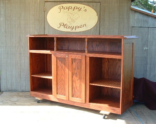

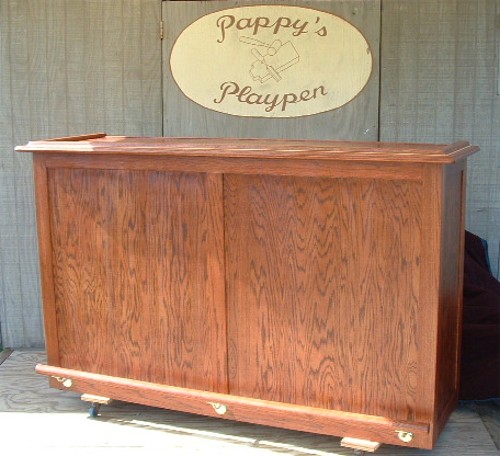

    I built this for a coworker to put in his garage/game room. With all the rain we have had, and working outside it was slow going.
    Red Oak plywood for the panels and shelves with Red Oak stock for the frames and trim. The stain is Minwax Red Oak finished with Gemini Satin Furniture Finish on the cabinet and Waterlox Crystal Clear Urethane for the top and footrail.
Name:	Finished Front.jpg
    The posts were turned from the cutoffs from the footrail to prevent the top from sagging.

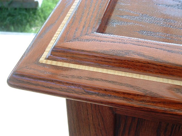

    The edge of the top was 2 pieces glued together with a rabbet in the bottom piece. There were a few small gaps in the joint line and, rather than trying to fill them, I covered them with a Curley Maple inlay.
Name:	Curly Maple Inlay.jpg

      Beautiful Don. the new owner looks tickled with it. The inlay really made the top stand out.

        Pappy, once again you have done your customer well. I too really like the inlay. It makes the top sort of pop when you look at it.
