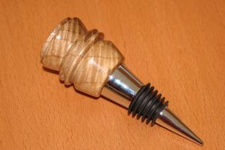

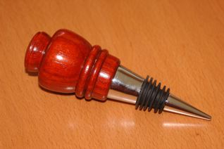

    Bottle stoppers
    I bought some stopper kits from PSI and started making these the last few days. I'm still learning how to make coves and beads, but I'm not getting as many catches as I used to.
    The left stopper is made of something that's either spalted or a burl (it was in A Pile of Unknowable Scraps). The one on the right is padauk, which I liked working with less than I originally thought I would.
    Special thanks to Ken Massingale for all the help with respect to sharpening.

                Nice! The left one might be quilted & spalted maple.

                      Why didn't you like the paduk to turn? It's one of my favorites- especially the smell.

                          Originally posted by Ken
                          You didn't mention that you're using the skew to do beads and coves. That's quite a feat.
                          It doesn't sound so good when I can't get my spindle gouge to stop catching every time I use it. The skew and the roughing gouge are the only ones I can consistently use without catches.
                          I think I have to re-do my gouge profiles. They look a little too spear-like to me.
                          I tried a couple of pens and the stopper with padauk. Although the wood is easy enough to turn (it's not a very hard wood), the pores are huge. I had trouble with metal dust from the bushings getting embedded in the pores when I was turning pens, and with the stopper, I just couldn't get the wood to "shine" as much as I wanted to. With some other kinds of wood, even sapele, I can almost see my reflection after sanding to 12000 MM.
                          I just read about sealing large-pored woods with CA and wet-sanding it. I think I'll give that a try. I have a piece of padauk with some sap wood in it, and I think that'll look great as a pen.
