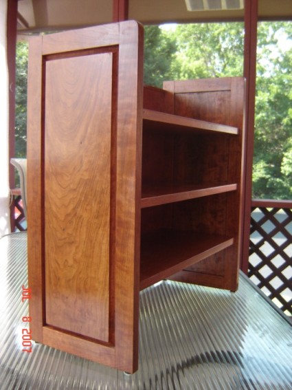

    At the insistance of the wife I'm posting the shoe rack that I had promised her for two years, finally completing it this past winter. I love doing building but my gut is in a knot while getting ready to post this.
    The wood is, of course, cherry with a Varathane stain and MinWax polyacrylic topcoat. The raised panels were a cheat since I don't have a RP cutter. Here goes and thanks for your patience while I was nervously building my first raised panel project.

                Thanks folks! I owe it all to the wood. You'll notice that the panel is one piece. Nice figuring. The raised panel 'cheat' is that I cut the edges with a 3/4" cove bit. Then, I discovered that it recessed into to rails and stiles so deep I lost the raised effect. So, I glued 1/4" strips on all fours sides of the panel after reducing both dimensions by that same amount. Voila! Raised panel cheat. Since the add-ons are hidden in the dados you can't tell. Yea, kinda hokey but it worked for the application.
