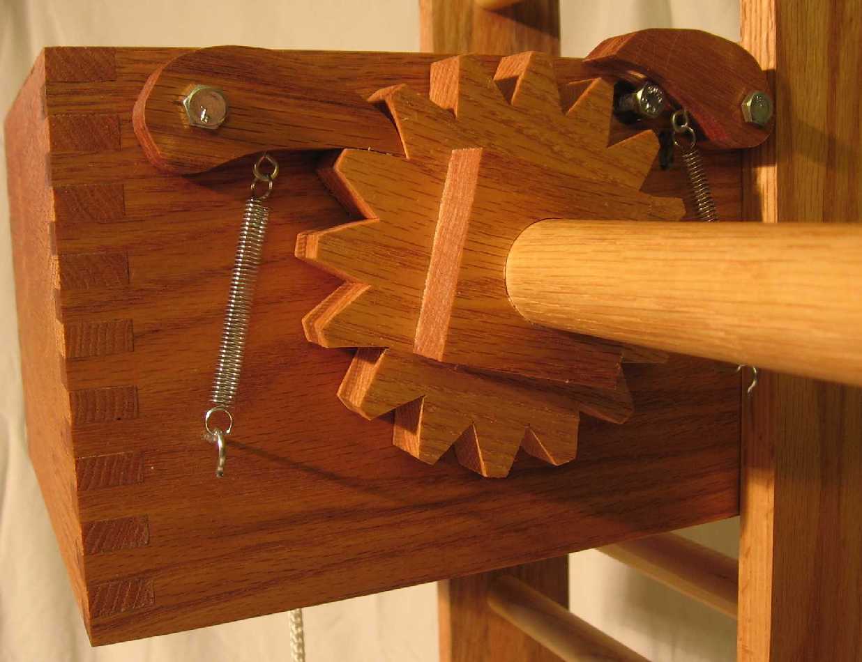

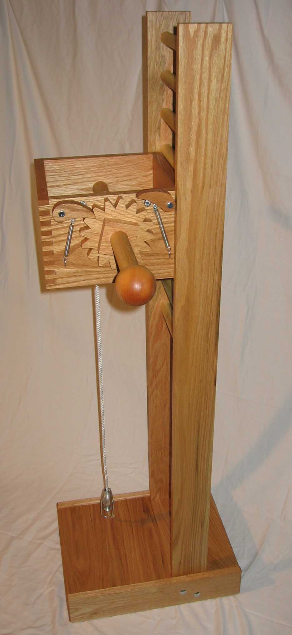

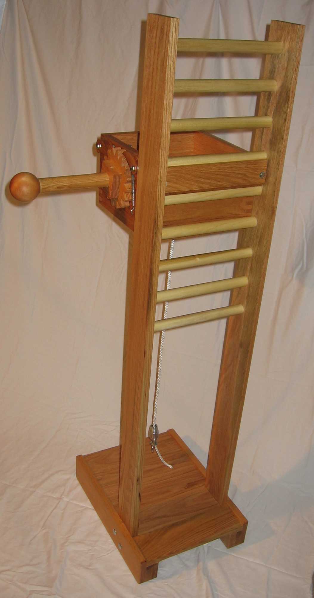

    This the eighth one I've done, and it's the best one yet. It is a weight well, which is an exercise device used in a hand therapy clinic. My day job is physical therapy, specializing in hand & upper extremity injuries.

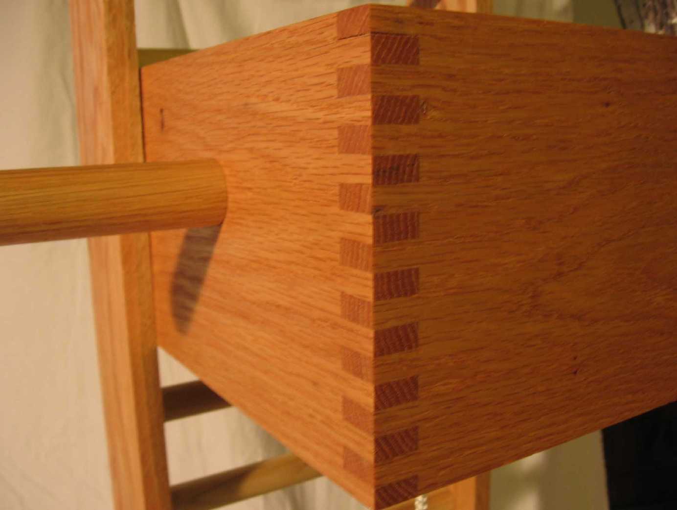

    This is an original design, unique in that it is free-standing, height-adjustable, and has dual spring-loaded ratchet pawls. This is the first one with box joints, which were done with Lynn's Box Joint Jig, which worked great. http://www.leestyron.com/newlynnjig.php
    It's all oak, except for poplar rungs on the ladder-back. It's also sold, and I'm reluctant to part with it, but oh well, it's really not suitable living room furniture.

        You attach a weight to the end of the rope, and then using wrist and/or forearm action you rotate the shaft to wind up the rope, which raises the weight, like raising a bucket of water out of a well (hence the name).

                    Very well thought out and implemented. Nice box joints.
