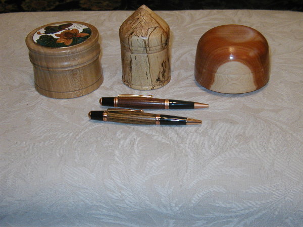

    These are my latest "round" work.

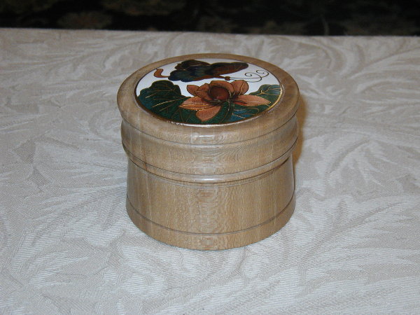

    This box is made of sycamore. About 4" in diameter. I bought the lid insert from Craft Supplies.

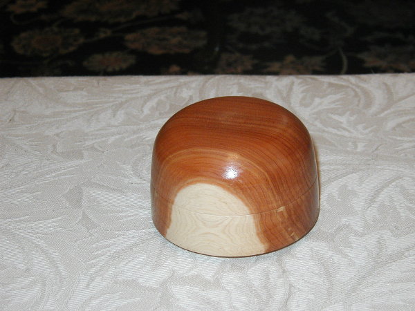

    The next box is cedar, About 4 1/2" in diameter.
    The last box is spralded Tamarind (sp), about 2 1/2" in diameter.

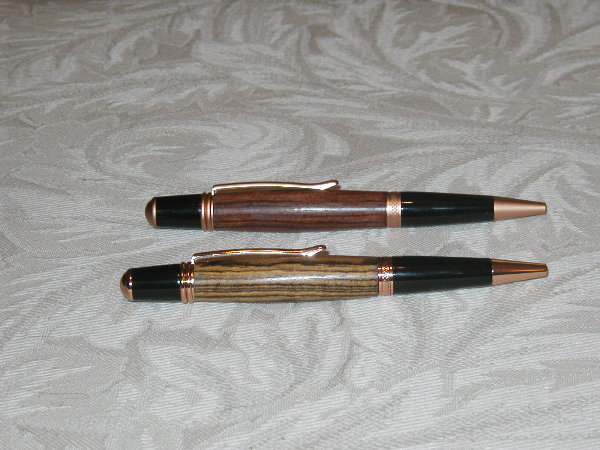

    One pen is cocobolo with a satin copper finish and the other is bocote with bright copper finish. I'd like to thank Hank Lee for putting me on to Bear Woods where I bought the kits. Good service and a good price.

        great stuff don i like the sycamore box the lid is just beautiful

            Nice work, Don. Both the Sycamore and the spalted box are exceptional.

              "How are you finishing them? Sanding to xxxx, then finish with _______?'
              The boxes are sanded to 400 then sealed with sanding sealer, then I used EEE and finished with Mylands Friction polish.
              The pens are sanded to 1200 then EEE and finished with Hut Crystal coat.

                        Wow, nice work. The box with the painted top is especially nice.
